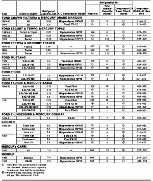

I'm changing my 91's AC system over to R-134 and was wondering how much of that special oil I should put in the compressor and dryer/filter prior to assembling. Anybody know? Or a good source for the info? The helms doesn't say how much, just two ounces more than what was in the old drier. Thanks.

100 weight. Is that the correct weight?
