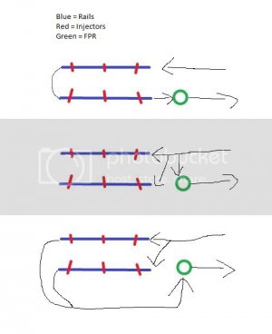

The high flow kit has that. Turns the fuel system into a semi-returnless setup, which has it's pros and cons.
Pro is more flow and no need for charcoal canister since you don't have heated fuel being sent back to the fuel tank.
Cons is that now you have a higher chance of boiling the fuel in the rails, since the fuel doesn't flow through the rails anymore, it just flows in and sits there until used by the injectors.
Personally, I think that the rails should be kept as a return style. If they can't flow enough for high horsepower setups, then run a feed into each rail and an return off the end of each rail. You'll have the same flow capacity as SHONUT's setup, but without the fuel heating. In fact, it'll be heated even less than the stock setup, that way.
Here, I've made a horrible diagram to put my text into pictures. Top is stock/Josh's base FPR, middle is Josh's high flow FPR, and bottom is what I'm going with. I've drawn the feed and return directions on each setup.

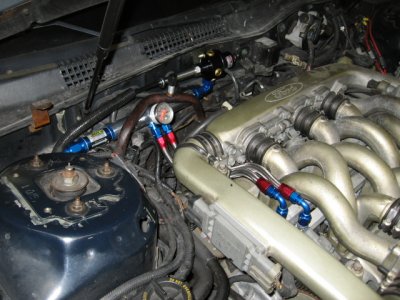

Off Road SHO
Moderator
Jan 16, 2002
5,684
1,292
I use the system that Firebat described in his third ...ummm... diagram. I had it polished though.

the fpr is at the end of your setup tom?
im kinda surprised that doesnt cause problems since the regulator is after the rail?
You do realize that the FPR is always after the rail right?
The feed goes straight into the rail and the FPR is on the return line coming off the rail. The FPR just "holds back" the pressure and lets excess past.
Tom, glad to hear it works for you. I wasn't sure if anyone had done the fuel system like that, but it made the most sense to me.
