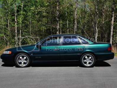

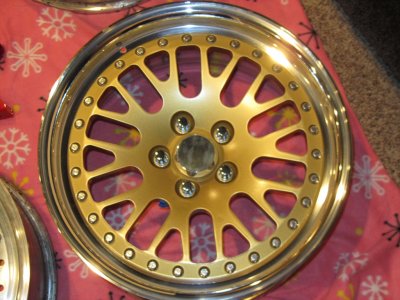

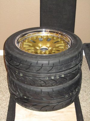

I'd recommend taking them to a wheel reconditioning shop and/or powder coater. Personally, I'd take them to a powder coating shop and let them blast and coat them.
I recently refinished a set of wheels myself aside from having the centers powder coated:
From this:
26748934084 large
26748934083 large
26748934101 large
26748934111 large

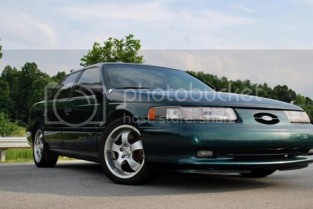

Your wheels
Yeah after I really like the way they look on your wife's car. I've been looking for a spare set of wheels and stumbled on these through Craigslist. They just need a little cosmetic work.
My wifes car is the only other SHO I've seen with those wheels...

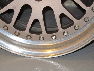

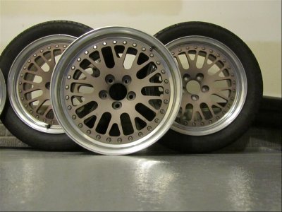

[/IMG]
I would be curious about this as well. These wheels have the same machined lip clear coated.
