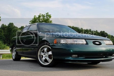

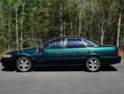

My friend plastidipped the wheels on his 328i. When he sold it, the plastidip had been on for months and it still looked great. He had been commuting to school 40mi or so round trip a day and he didn't have any paint chips or anything. My brother and I have had multiple other things on our car's plastidipped for months and it all still looks great.
Another friend's plastidipped wheels.
