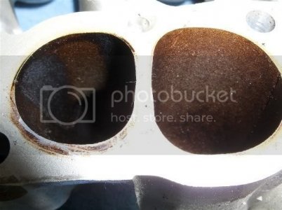

strings1732 said:If that's the intake manifold, try the dishwasher. I'm dead serious too.
Soak them in some soap and hot water(like dish soap for handwashing the dishes) for about 30 minutes or more . While it is soaking, you can scrub with a toothbrush every so often to help loosen everything and break it down. After this, spray it off with carb cleaner. Then put it in the dishwasher, just like you would the dishes.
