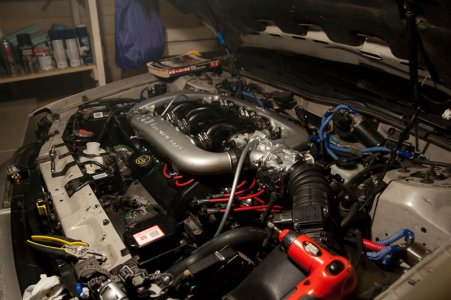

Okay guys, here's a good one for you, what's wrong (engine related) in this picture?

The missing PCV hose from the front valve cover to the intake would cause an uncontrollable idle problem.
FWIW, when you unplug the IAC valve, the solenoid will close and the car should stall. If it doesn't, you either have a faulty valve, or a vacuum leak which provides enough air to keep the engine idling.

ditto, though i would be first, yeah the line from the TB to the valve cover is off and the IAC is backwartds.. and yes how does that happen?

Josh won! Just in case you all want to know, the IAC fits either way, unfortunately! Though the harness is really hard to get on... anyway, I went reading through the SHO book and looked at the engine in the picture and lo and behold it struck me. I had the IAC on backwards! I turned it around, reset the idle and it idles between 900-1000 now. Magic!
Honorable mentions to Mr. Anonymous for catching the PCV hose missing. To answer the "how the **** does that happen", my answer is... :slap:
