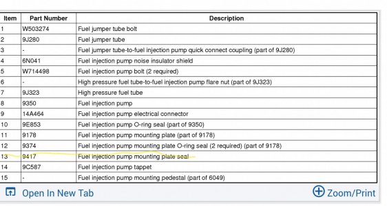

I’m replacing the High Pressure Fuel Pump. I only have the pump do I need any o rings seals that I also need to buy? Cause my pump didn’t come with a seal and all the videos or guides I’ve seen don’t mention it. If anyone can provide the part number or link to the seals if possible

you can reuse the gasket however I always order the gasket in case it tears. ford always says, no shocker... replace. in general for the what 12 dollars maybe... just replace and keep the old one. I would get thread sealer for the two Allen wrench bolts, don't use much
