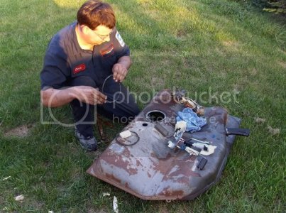

Well On saturday we pulled the fuel tank and installed the new sending unit and pump in about 30 minutes.

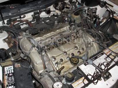

MY intake was dirty! Is there a way of getting all the shit out with out really taking the whole thing apart and brushing it all out by hand? I cleaned what I could reach with a toothbrush, seafoam, and a rag.
