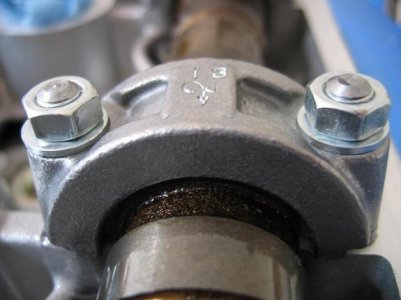

Is this the picture you're looking for?
26748930042 large
26748930042 large
