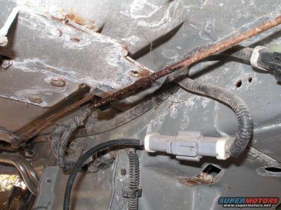

Well I am not sure how this happened. I put the car up on ramps this morning to do an oil change. As soon as I have the car up on the Rhino ramps I notice a pool of fluid right below the drivers side door. After taking a look the leak is coming from the brake lines. Within 20 min all of the brake fluid has leaked out of the system. Upon inspection there appear to be three lines, the Ebrake, the rear brake line and another???? The third line looks like it is rusted all the way through.
It seems like everytime I try a simple task it turns into a costly one. Does anyone have any idea how I did this and what exactly the problem might be? Am I going to need to replace the brake lines? It looked like there was a slower leak on the passenger side right next to the wheel as well.
Last week I had the rack and pinion replaced could this have anything to do with this problem. I have been driving the car without issue for a week and this morning after putting it up on ramps this happens.

I can't see a distinct break but right under the drivers door is where the brake fluid is dripping from. Is it common for brake lines to break like this? Are there two brake lines and one ebrake line on the drivers side? Thanks for the help.
13,265
It is very common for the brake line on this model to rot out. I would get all the lines replaced. I tried to get just the one leaking fixed and then another one went. Could have saved money getting everything done at the same time.

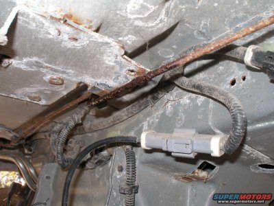

Here is your problem.
Under the drivers seat
Yep, that looks exactly like what I saw under my car. How time consuming/skilled is the replacement of the lines? I just spent a lot of money getting the suspension and rack and pinion replaced and would like to try to do this myself if its not too hard but I don't have a lift available just jack stands and a floor jack. Plus I would have to pay for towing because the brakes are completely out with no fluid right now. Thanks everyone for the help.

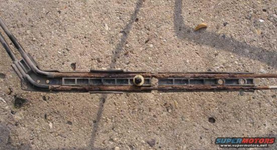

The two lines run from a pressure reducing block on the drivers side frame rail in the engine compartment. Then go back around the gas tank and go to the proportioning valve. There is a line from the pro. valve to the passenger side rear that is above the gas tank. It needs replaced too.
Rusty brake line 4
So consider dropping the fuel tank. I have two cars like this now... :(
Rusty brake line 4

Got to love living in the rust belt. So far four of mine look just like the pictures that Paul posted. They can be a pain to fix, I pulled out as much old line as I could and then copied the bends to the new lines. You can splice into the old lines if there is a chunk that is still good, just use flare fittings. It is best to replace the whole thing if you can. Also you can use the old fittings that go into the valve block (near LR tire). Be careful threading back into this block as it is pretty soft aluminum. I cross threaded one of mine, it was hard to find the proper tap to repair the threads.

Yes, it looks like just the bare steel lines running along the side skirts are rusted out, everything else looked ok that was coated in plastic. Perhaps to save a little money I can just replace the ones running along the side skirts. Looks like they would just unscrew and come right out.
