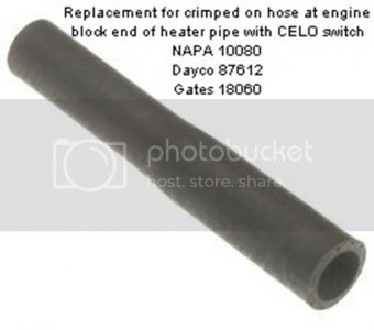

You loosen the hose clamp where the short hose goes into the engine. You remove the heater core hose from the other end. Now the pipe can be removed. You DO NOT cut the pipe....All you have to do is cut the silver crimp ring off. The the old hose will pull right off. The pipe is beaded under the rubber and that helps hold the hose on. Replace the old rubber piece with this:
SHOcelopipeheaterhoseNAPA10080Sm 1
