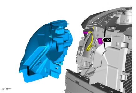

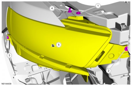

Headlamp Assembly​
Removal
  1. Remove the front bumper cover. Refer to Section 501-19.
  1. Remove the headlamp assembly upper bolt.
    • To install, tighten to 3.2 Nm (28 lb-in).
  • 1700327256377
  1. Remove the headlamp assembly front bolt.
  1. Remove the headlamp assembly side bolt.
    • To install, tighten to 7 Nm (62 lb-in).
  1. Remove the rivet push-pin.
  • 1700327295439
