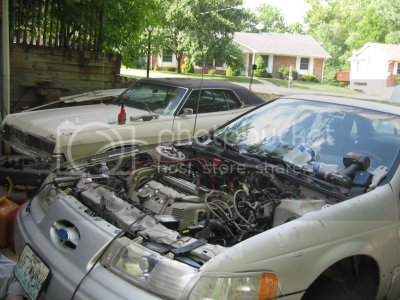

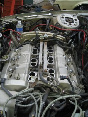

Well i picked up SHO AMO's Fresh ass heads a few months ago, and im finally getting around to moving them onto the car. :omgsho: :evilgrin:

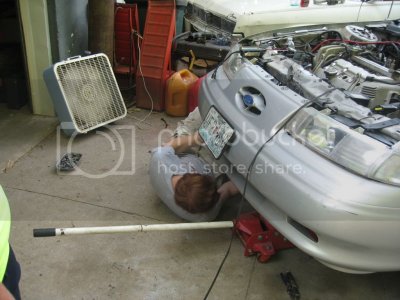

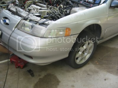

Done most the work in 100+ temps which has been ****. ONLY BROKE ONE BOLT SO FAR!!! and it was a dumb heat shield bolt.

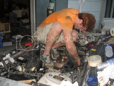

Me at work, oh the fun.

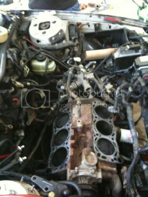

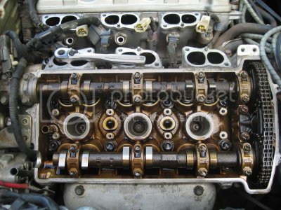

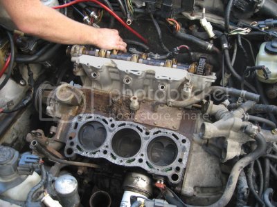

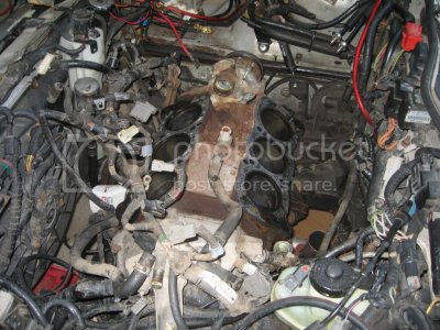

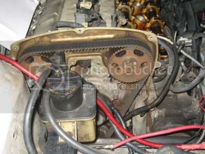

Im half way, got the heads off and cleaned everything up really well. Started to clean up the Ex manifolds for a paint. Cleaned up the engine bay and checked the P/S pump which looks good and the so does the Water pump.
Gonna do some work on the heads, does anyone if opening up around the intake valves and removing the wire edge around the cylinder/combustion chamber is an alright thing to do? im not talking about in major grinding, just smoothing up small stuff. Just some old tricks my dad was asking about that he had done back in his day.

The heads are gasket matched and lightly ported when i bought them from SHO AMO.

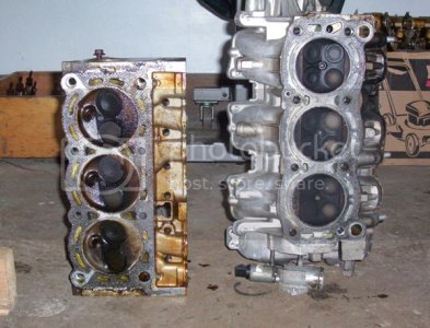

The wire edge im talking about is on the edge of the combustion chamber. Where it meats the block and goes vertical. What i plan on doing is something that could be done with a steady hand and sand paper its not a major change.
if you see in the pic around the combustion chamber is a sliver lip and, and from casting there is a small edge almost like casting flash.
Head Comparison3
