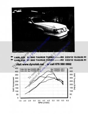

We put the turbo in the back and used a separate oiling system with a reservoir. put 365hp and 405ft-lbs of torque on the ground.

Corrected for barometric pressure only, but tq and hp on the tires thru a Dynojet dyno.
That was also 18psi on a built motor.
A stock engine sould be able to take 9psi and survive.
Nice, I was unaware either of the 'stealth' turbo projects you built were worked over. Got any dyno sheets? Wondering what that curve looks like, 40ft lbs more tq than HP. I am assuming it makes gobs of TQ down low but the HP is fairly light after 6000rpm?

I wonder what a remote mount with a larger turbo would look like. While the numbers up high for these smaller turbo's look pretty pathetic, I can promise you that the meaty TQ in the middle of the powerband are a lot of fun. My lower HP small turbo car was actually a bit more 'fun' to drive most of the time, since the TQ was more accessible.

The bigger the turbo, the more exhaust energy it needs to get going. So the peak ends up later in the curve.
Having the fat part of the torque curve in the middle is great. This car pulls in 5th gear like it's in 4th. 70mph on the highway at 2800rpm, just squeeze the throttle and here comes the power.
We're working on a twin turbo project to cure this little issue. Stay tuned.
