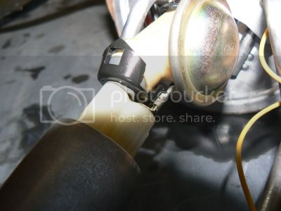

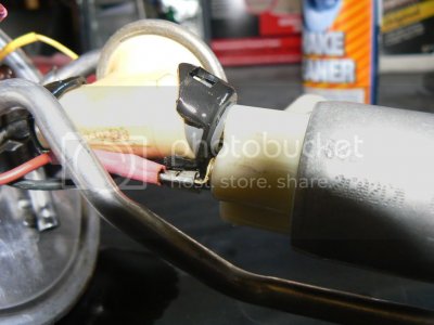

Here's where the first install was wrong... seen it as soon as I pulled it out.. ;)
P1050938
P1050940
In their defence.. they said it was in the dark.. and late on a Sunday night.. :)
