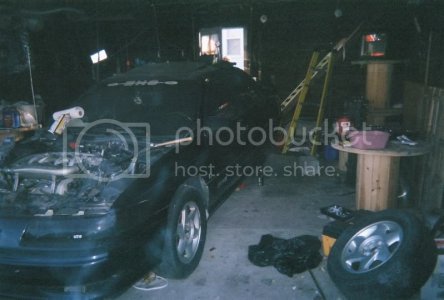

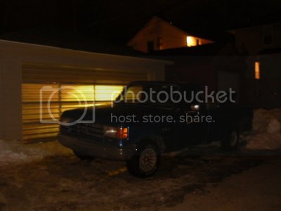

Mygarage
P1000306
there's a pic of the garage on Eagle St... is it that size?
Wish I had a better pic, but that truck and the Malibu fit in there.. :)
