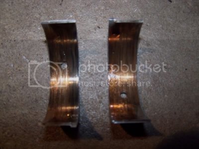

First, rod bearing damage like that shown in the image posted by 1993MTXSHO does not occur because seeing a flickering Low [ OIL ] pressure light once or even a few times. It is the result of poor maintenance practices - not changing the oil at regular intervals, running low on oil repeatedly or for extended periods, running the wrong weight oil, repeated burnouts and beating-the-shit out the engine, etc.
Rattle does *not* always mean a rod bearing knock. There are a number of other underhood problems that can produce very similar sounding noises, especially to someone that's not familiar with what a rod-knock sounds like. And even if it were a rod bearing knock, I know several SHO owners who have driven their SHO for months, beating the **** out of them before the engine let go. Ask SuperHO and St Louis SHO how long and how hard they drove their 3.0s before they blew.

what kind of cost am i looking at to have the bearings done? this is not a job that i can handle and i would have to pay somebody to do it.
From RCM, 64.99 for all the parts needed to do the job unless you break off one of the exhaust studs. Being where the car came from I don't think you'll have that problem.
Do quit driving the car. Absolutely and without a doubt.
You're in Las Vegas now as I understand. There is bound to be someone in the SHO community over in that area that can help you.
And guys, quit beating him up for not taking this job on. If he doesn't think he's capable of doing it, it's best that he let someone do it for him perhaps while he watches and learns. Better that than getting in over his head and f'ing something up.

look up rod bearings you will find all the sizes you need.. you could get a cheapo set from lowes or something .. husky is lowes brand and it is lifetime replacement for like $40 or so dollars.
takes roughly 2 hours of work..

If your bearings were never changed, just change them for good measure. I herd no sounds in my 99k mile 93, and ran great, no light at all until i revved in my driveway when i got home and saw a little flicker when the revs dropped back tp idle but then it went away. I Figured ok that wasn't good but its prolly not to bad, so i pulled it apart the next day to change the bearings, and found this, the crank was screwed up and the engine was trash, at 99k miles. This was a meticulously maintained car as well, I mean the engine was so clean you could eat out of it, it had the 60k done at 60k as well, moral of the story, CHANGE YOUR ROD BEARINGS NO MATTER WHAT.
SHOengine006 1
Look like my bearings I just pulled from my running 93. Creepy.

I can't believe those wheren't rattling like an aerosol can! I thought the ones in the 93 were bad, I could hardly believe those things, Paul! Or should I say, V6 n00b.
