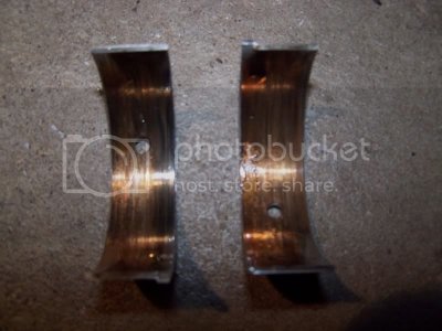

If your bearings were never changed, just change them for good measure. I herd no sounds in my 99k mile 93, and ran great, no light at all until i revved in my driveway when i got home and saw a little flicker when the revs dropped back tp idle but then it went away. I Figured ok that wasn't good but its prolly not to bad, so i pulled it apart the next day to change the bearings, and found this, the crank was screwed up and the engine was trash, at 99k miles. This was a meticulously maintained car as well, I mean the engine was so clean you could eat out of it, it had the 60k done at 60k as well, moral of the story, CHANGE YOUR ROD BEARINGS NO MATTER WHAT.

First, rod bearing damage like that shown in the image posted by 1993MTXSHO does not occur because seeing a flickering Low [ OIL ] pressure light once or even a few times. It is the result of poor maintenance practices - not changing the oil at regular intervals, running low on oil repeatedly or for extended periods, running the wrong weight oil, repeated burnouts and beating-the-shit out the engine, etc.
