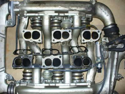

pics are in

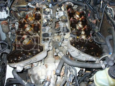

well weve had the car sence sunday and well its not one piece anymore....
P1010180
P1010183
P1010186
P1010190

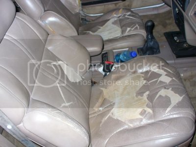

anybody got any "band aid" gen 1 full leather seats in this color???
P1010191
P1010192
P1010193
P1010194

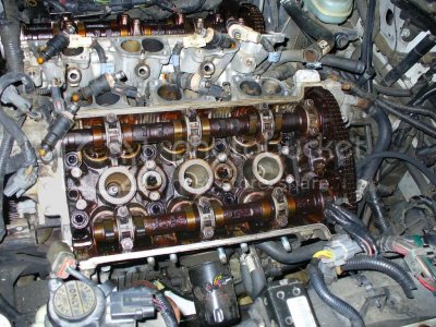

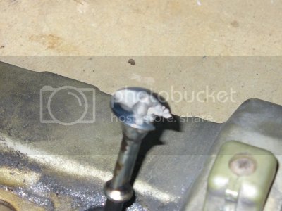

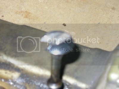

the work we had to do to get the rear valve cover off..
P1010200
P1010197

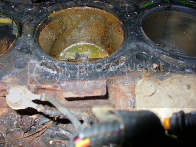

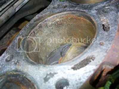

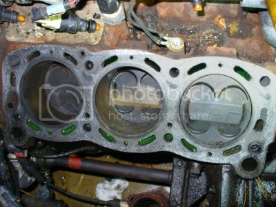

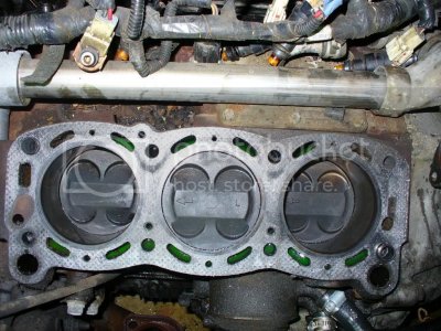

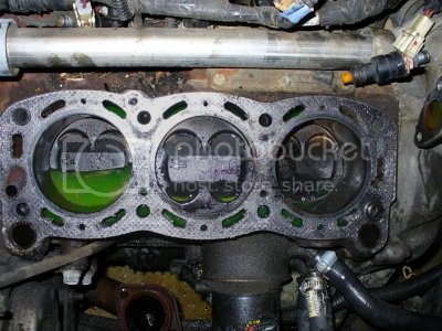

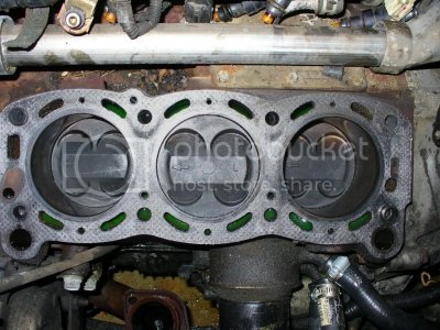

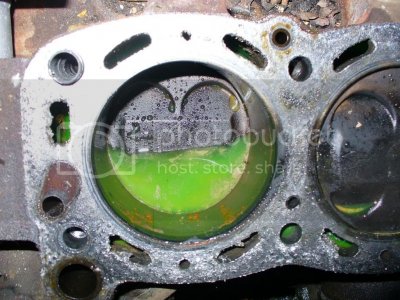

the surprise we happen to find once we took the heads off, honestly with how much antifreeze leaked from the head when it was loosed from the motor thats probably where most of this came from.
front
P1010201
P1010202
P1010203

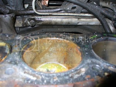

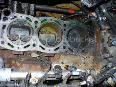

the rear is a little worse, the flash made it look really bad but its not really, and surprisingly enough it was building great compression
P1010204
P1010205
P1010206
P1010208
after all the antifreeze was cleaned out..
P1010211
P1010210
P1010213
P1010214
thats all for right now... sry for such a long post but im sure everyone wanted to know what we might find i dont think its as bad as it could be i think with some fresh heads and head gaskets a new rad. and the cooling fan it should run great..
plz post any thoughts or opinions on the project.
