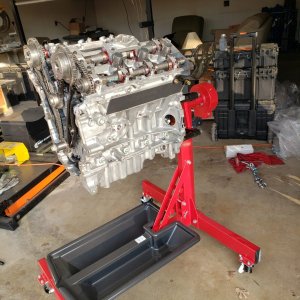

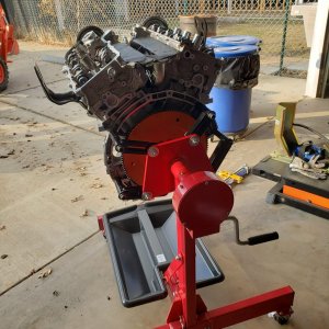

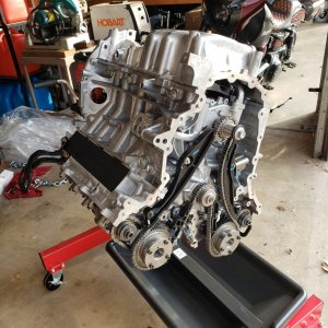

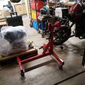

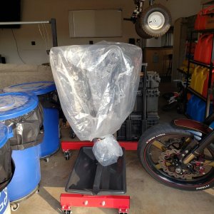

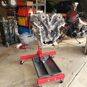

Small update. Things have been slow going, but I finally got the engine onto an engine stand...you might find it interesting, LOL.
Well here's the fancy engine stand I ended up getting. Sunex 8300GB, 1/2 ton stand with oil drip pan. I wanted one with an actual gear-reduced crank handle because, well...I'm lazy, LOL:
OHdzxEIsOYdOhwidth1024height1024cropmodenone
3QlAiQCAO7idKwidth1024height1024cropmodenone

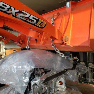

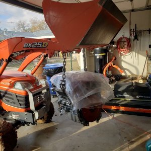

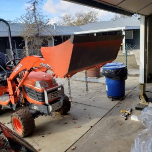

And even more entertaining is my engine hoist:
A19sRP0PdTm2rwidth1024height1024cropmodenone
My Kubota BX25...how you like THEM apples? LOL
LX25zmC5foXbFwidth1024height1024cropmodenone
6KycQIiKw5Q0Pwidth1024height1024cropmodenone

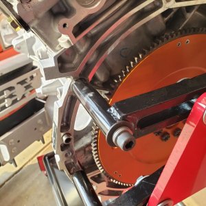

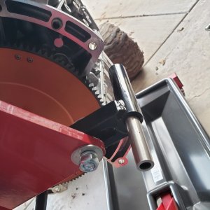

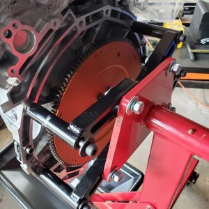

Got a hold of some metric Grade 12.9 (yes, it's a thing) hardware. I custom-made some stainless sleeves to take up the slack in the larger diameter engine stand brackets. Makes for a super tight fit and no "slop".
CO2gU8JqfHgulwidth1024height1024cropmodenone
MpcZeK3fUFvxewidth1024height1024cropmodenone
Everything has anti seize on it! Sleeves and all...
TFVySxkK HbE1width1024height1024cropmodenone
Getting it loosely mounted:
VH49mpmCvWjaSwidth1024height1024cropmodenone
0v0PCKS7p0r4cwidth1024height1024cropmodenone
I like to get the center line of the crankshaft lined up with the center rotation point of the engine stand.
And mounted!
 C4y8mgCBCTd2width1024height1024cropmodenone
M3iJkPz5JKCjHwidth1024height1024cropmodenone
VOQZWvkHn9hOswidth1024height1024cropmodenone
Rotated...just because I can...
Fb5lr5oUdB6DRwidth1024height1024cropmodenone
And finally, all tucked away for the time being:
J617FeJAgjbtnwidth1024height1024cropmodenone

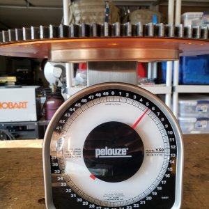

And for those wondering what that shiny orange flexplate is all about...I'll let @bpd1511 elaborate. All the credit goes to him for getting that brought to market!
Jordan_R
Sep 20, 2017
1,784
4,480
Missouri
I inquired about the flex plate a little while back and it's definitely a nice touch. Once I picked up my own though and felt how light it was I decided against it. Did you ever get a chance to weigh the new one?
Ecoboost_xsport
Mar 21, 2020
2,039
3,945
Sacramento, CA
Good point. I'll be honest with myself on what's to be gained from it and I feel a bit like it may be an inconsequential mod, especially if the weight difference isn't noteworthy.
But yes, I weighed it. I haven't weighed the stock one yet as it's still on the car. But if you have a decent scale, weigh it up and qe can compare notes...
Mines not in my hands currently otherwise I'd let you know lol. It's definitely better than stock no question there I've just been pretty **** lately about removing rotating mass lately lol. I was ecstatic to hear my upgraded rotating assembly was less than stock when they were balancing it ha
I like that you balanced all the rotating parts together. Wasn't able to do that...
Anybody got a stock one laying around that they can weigh fairly accurately?

It was an absolute hassle to get her balanced.. had to go between a couple different machine shops but hopefully the finalized product will be as good as possible. There is other things I would had liked to do but didn't have the funds / the cost to effectiveness ratio was not favorable enough

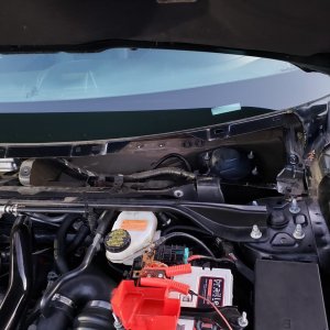

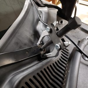

Access The PCM And/Or Wiper Motor

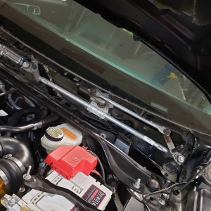

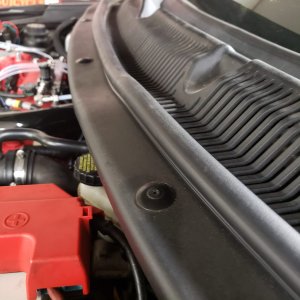

In case anybody wants to access the PCM and/or the wiper motor. It's actually pretty easy and accessible.

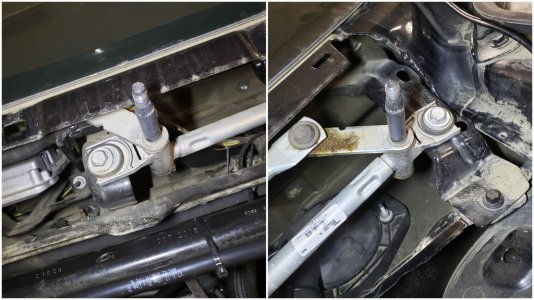

First thing to do is remove the wiper blades. At the base of the blades are bolt covers. They just snap onto 3 sides of the six-sided nut. Just get a flat-tip screwdriver and pop them straight up:
y4mhXgYXalT4A3dKzz22BRcZfYOFwSLVdDRbGoeQ7lW_wl9SNx1hbFM-p-b-dTjqWYR5XTreYhQxj_ZiAbBxI2My9E5K_0L18wyMz8Wj7qRm7ASDvo8vjbxY9HvF7nuiWcXw4C2-QeH_MlLHzVJYN4pU3GzYJ_qQGlHtNQBaonqlCCcpSnfrk04sSCESF9CG9fi
Once those are off, you'll have to remove the nuts off the wiper arm studs. Once those are removed...
RSHhtgRInN7Brewidth1024height498cropmodenone
They likely will be pressed on there pretty good. Flip the wipers up to give you some ability to wiggle the base. It's possible to remove them by hand, but easier if you use a tool to pull them off, usually comes in a nice puller set like this::
y4mN4chbn5QS95eKrhsA4kxmZ56NlYBLwIn7LG2gHvSdmvP-ELFRF7ws8o_Wwz1GstO5YvQqDTdsMdpNDR14YNGjA-G6WYhS-ptv8kVxxBJwiFUBS1tSjkCbcnDXS2BlAgGT_tMVAWl6lJYEg5m1SUVwHexRAykDNFdMGZ8SLuRX664trY0k4zV5W-DCDmcr1yP
Here it is, ready to pull:
TewO qnw2Pqcvwidth1024height1024cropmodenone
They pop off easily, usually with a loud "pop" sound, so just be ready for it. Once those are off it's time to remove the upper cowl piece. There are 6 plastic clips that need to be removed:
VouLgfzGBF0prwidth1024height1024cropmodenone
Just use a Phillips head screwdriver to remove the center section of the clips. Sometimes they just spin without coming up. Just use your other hand to pinch the outer portion from underneath. It's also clipped into slots on the bottom of the windshield. Just pull the cowl directly up with some force and they pop out.
Here it is removed and showing the lower cowl:
ThuJ1GCJm6p38width1024height1024cropmodenone

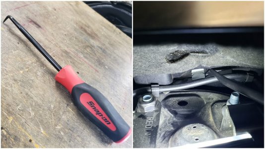

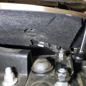

To remove the lower cowl, you'll need to slide out to metal clips on either end of it, where it sits on the metal frame:
ZaGCBlNihSFj width1024height1024cropmodenone
They are in there with some "bite". I used this tool to pull them straight back towards you::
OdicbtQB2A8E1Cwidth1024height576cropmodenone

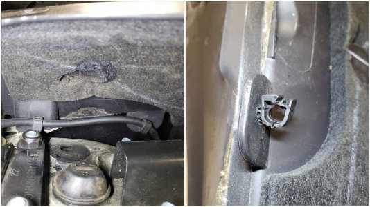

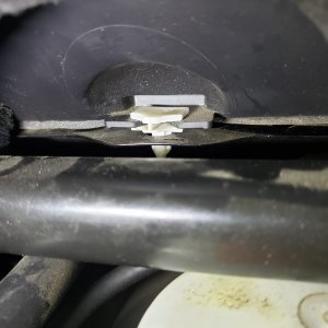

Then there are 2 white clips more toward the center of the cowl, same place where the cowl meets the frame:
NMxQ2CkLyKkDpwidth1024height1024cropmodenone
These just need to be popped up. It may tend to fall back into the hole, so you can remove them if you'd like by pulling it straight out. Don't loose them, LOL. Here is what it looks like when it's off the car:
y4mgXLJYn0LabRoUz8mDwxO3gWanxBp5CYf9SGsTcIpNzqIiYj8S2AM-8ryF10JXC3RD8Vvls73cQ6TRN424g1fXyxkpmWsmjQf8EsVyJTMypwCQXJjSWdGkz25X62L3jzpTj-jxZcE9Iyd5wysd3n3I6_sMWflnDnU2z7FiH6xaH5EiuKlMeRcqcMxt0ZSdvPr

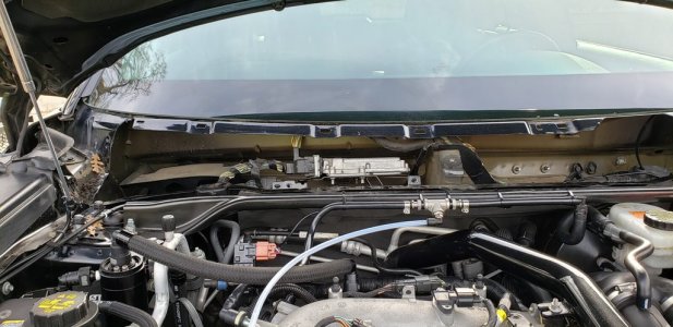

Last thing to do before it will freely come out is, open the clips that hold the washer fluid line and pull the hose out. A small flat-tip screwdriver will open the clips, no need to remove them from the cowl:
YOZRA ZyqgjorMwidth1024height576cropmodenone
And now you have access to both the PCM and the wiper motor, whichever component you are working on.

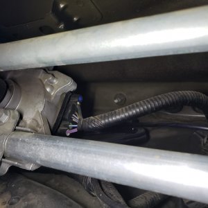

WIPER MOTOR
XwXpk64siIY7gwidth1024height1024cropmodenone
Pretty easy,actually. Just disconnect the connector for the motor:
CvqR9jBZArOaewidth1024height1024cropmodenone
Then remove these two bolts:
HtiOoAX  Kq8CLwidth1024height576cropmodenone
And here it is out of the car:
KQ25cyUGHYt3swidth1024height1024cropmodenone
IAIw3o1HNVfy width1024height1024cropmodenone

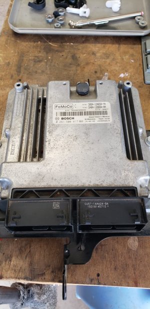

PCM
H5HEsQp4n66Yw4width1024height498cropmodenone

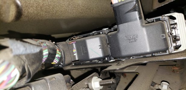

Also very easy, just undo both the main connectors. Do this carefully by lifting the hold-down/lock handle:
L59cMM2FcPiJHBwidth1024height498cropmodenone
Then remove these two nuts:
y4m6LdoBGf9USDu6Veeu468ogTwrkxJ1daDoWl6fQqyInW_ZfLEfcxIx26yxFWb5U9koGGVG81yJjrm1P-4Vt0Itf0w4c9m6YjyRblOIb79xEHGgMZrRUglP_TaCW61OdxSoqDN3URjQ-D0xZiniCQqf4lUNIUwty7c_-kEkOKKlJsjkFY1nhhfU9KG3U8SXdog
And pull the assembly out. Here it is free of the car:
Y4uPuT4yFhCKOpwidth498height1024cropmodenone
And that's it! Assembly is reverse.

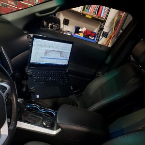

Laptop Mount

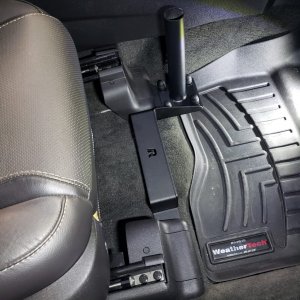

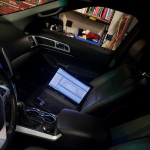

OK, this was a project that came about last minute and spur of the moment. I frequently datalog with my SCT and use the laptop to accomplish this. Typically, I just put it in the passenger seat and do what I need to from that angle. It always bothered me as I would have to turn my head very far away from the road as I start and stop the logging and it was typically very awkward. This wasn't really too big of a deal and I normally just dealt with it.
QIrT12howWXqVwidth1024height1024cropmodenone
Well, fast forward to one of my datalogging attempts where I was also testing out my Dragy device and doing a 60-0 braking test. That didn't go over too well because as soon as I hit the brakes, I wasn't prepared for the laptop to fly forwards into the floorboard at full speed. Well, it pretty much destroyed the laptop, cracking the screen, keys broken off and my data cord ripped out to the wire. Needless to say, I was pretty upset.
Luckily I was in the process of moving everything over to a new laptop anyway as that broken laptop was my old one. So, not wanting to break my new laptop, I decided to take advantage of the fact that the Ford Explorer is also used as a police vehicle, with many options to mount police communications gear available on the market, to include laptop mounts.
So after doing some research, I decided to go with the RAM Mount. It's inexpensive, well made, has a good reputation and also made in the USA...

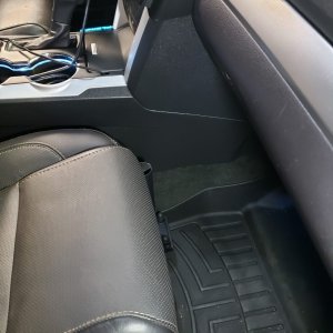

So here's the passenger floorboard before installation:
TQTTX0zCKZNgrwidth1024height1024cropmodenone

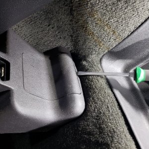

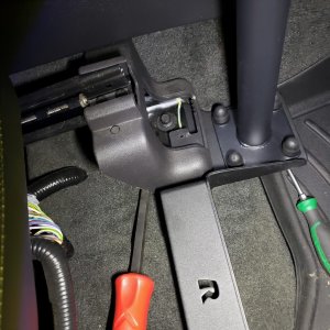

Pop off these 2 covers with a flat-tip screwdriver:
FcUXFRRL9N4F9width1024height1024cropmodenone

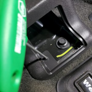

You'll expose the front mounting bolts. And it's easier to make room if you remove the T-20 Torx screws, but it isn't necessary:
0n7rqkTbykwnjwidth1024height1024cropmodenone

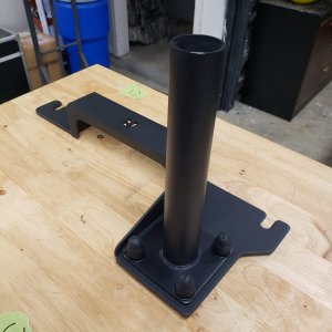

After having assembled the base...
CiL0fM 26PwZTwidth1024height1024cropmodenone
...you will need to loosen the 13mm front seat bolts. You won't need to take them out, but will need to back them out pretty much the entire way, right before they come out. Once they are loose, you can slide the base bracket between the floor pan and the seat mounting bracket. The outside one is easy, but the one closest to the center console may need to be pried up and hammered in with a soft hammer or dead-blow.
FPuEHUpWyDatbwidth1024height1024cropmodenone

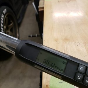

Once it's in all the way, you will re-torque the bolts to 35ft-lb as specified by Ford.
H60ePzUudHR1Rwidth1024height1024cropmodenone

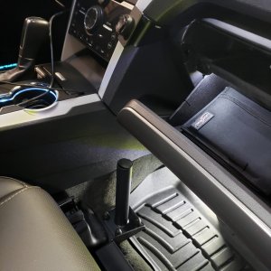

Here is the base installed:
2HnZCwbL4tRnZwidth1024height1024cropmodenone

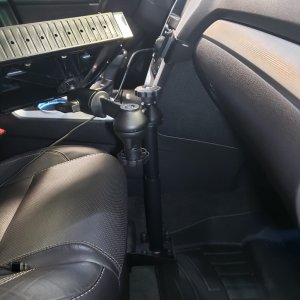

This is how I will drive 95% of the time as it allows full range of motion for the passenger seat, full access to the glove box and generally not in the way of anything.
H2JISJQmxl1hOwidth1024height1024cropmodenone
UOUX4YbnMfx4uwidth1024height1024cropmodenone
After assembling the remainder of the components, here is the mount installed as intended:
StuEI4l sCUg6width1024height1024cropmodenone
And finally, I love the easier access and control of the laptop:
Vb rNnUwxD6Wewidth1024height1024cropmodenone
As mentioned, I won't typically drive with it, but when I do, it's very surprisingly sturdy with large tightening knobs and heavy steel brackets:
SWM2OLmEucUQswidth1024height1024cropmodenone
It does shake/rattle a bit while driving down the road after hitting bumps. Not much but it would likely get on my nerves if I was driving with it full time. Luckily, I'm not. If I were looking for a full time laptop mount, there are more expensive options such as the Havis Standard or Havis Premium mounts as well as an option from Gamber-Johnson. I'm sure there are a few more.

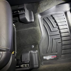

One of the things I like about the RAM mount is that it doesn't interfere with removal of the WeatherTech floor mats.
Anyway, one of those mods that make life a bit easier, but not 100% necessary.

I know you’ve been weighing things as you swap them out with lighter parts, what does this RAM mount weigh as you added it back to the tally?
