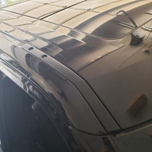

I wanted to get rid of the roof rack for awhile now as I never use it and feel like it might be another few pounds that can be shaved. I was thinking it would look a bit more clean and give it an even lower visual appearance by bringing the overall height down a bit.
The majority of Explorers come with the roof rack rails as a standard option with "slick top" variants normally being the PIU versions. I used a lot of the information contained within this post:
https://www.explorerforum.com/forums/threads/roof-rack-rail-removal.383226/
...and it was an awesome resource. Thank you to those that posted information on ways to make this happen. I won't rehash much of what was covered in it except for some things I may have done a bit differently.

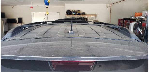

Here's the before photo (it was dirty, don't judge me! LOL):

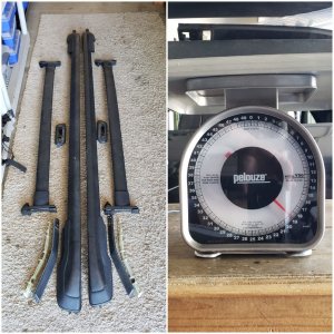

And once those are off, it's pretty much self-explanatory from that point. Here's the entire roof rack system removed from the vehicle and weighed it on the scale:
NXXR3X2EGG64Cwidth1024height1024cropmodenone
I saved a whopping additional ~19lbs!

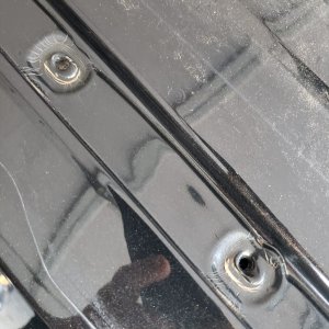

Starting with the rear portion, here's the bolt holes with all the dirt and grime cleaned up and ready for some new hardware to block the water:
 A3T4S0NdPmPiwidth1024height1024cropmodenone

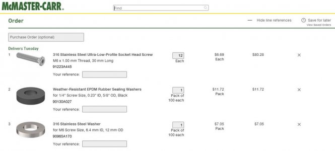

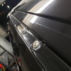

I made a personal decision that I didn't really care to add the length of channel stripping as I wasn't really that concerned about it. I did want it to look good, but wasn't too worried about the top portion, so I decided just to block of the holes with straight hardware. What I did decide to do was go with some pretty good quality (translation: expensive) 316 stainless steel hardware and some weather-resistant rubber sealing washers, along with RTV for good measure. Here's a parts list that I ordered from McMaster-Carr:
YJWCjNetLu2ZYwwidth1024height462cropmodenone

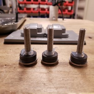

Yes, those low profile bolts are pricey, but they will work great. The OEM ones will work fine as well, this is just a bit extra. Here's the hardware in action:
Bs4Kd1JmyFqquwidth1024height1024cropmodenone
I doubled-up on the rubber washers to ensure it sealed against the contours of the bolt hole area. And also used some of this RTV for the extra measure:
6UQFEGeA94PVYwidth1024height1024cropmodenone
And the RTV applied:
9oqBz2qCoA6 vwidth1024height1024cropmodenone
And the final installation for the rear area:
CJnFzDaS4NiNewidth1024height1024cropmodenone
I will concede that it looks much better with the weather stripping that is used to install in that channel. I just opted not for simplicity's sake. It's not all that noticeable and I still used the front short rail sections anyway.

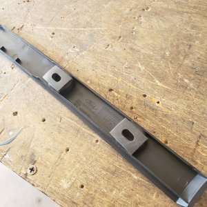

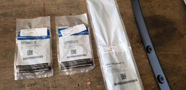

Now, onto the front area. Here's the parts needed:
BjAcy7x IAYvGtwidth1024height498cropmodenone
I got everything from Sewell Ford as pricing (to include shipping) was the best I could find:
  • DB5Z-7851728-AA Molding, Roof Side Trim $47.77 Qty: 1
  • DB5Z-7851729-AA Molding, Roof Side Trim $47.51 Qty: 1
  • FB5Z-7850002-A Retainer $6.80 Qty: 1
  • FB5Z-7850002-B Retainer $6.80 Qty: 1

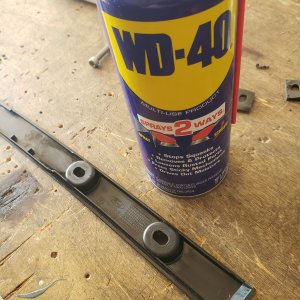

I made some changes with the sealing foam that came on all the pieces. I decided I didn't like it so I removed it all as I was going to use RTV and those rubber sealing washers for a more positive seal. I've seen that foam stuff go bad over time, so felt my option would last longer. Only time will tell...
ZoMgZuD5LwVRjwidth1024height1024cropmodenone
Foam removed. Side note: For those that don't know, WD-40 is the most perfect chemical to get rid of adhesive "boogers" and residue...it practically wipes off. It's great when removing decals and weather-stripping as well.
ULQz6ZgSNsHawwidth1024height1024cropmodenone

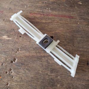

Also removed the foam from the retaining clip:
PibDzXyqejKTHwidth1024height1024cropmodenone

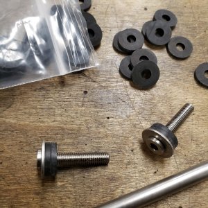

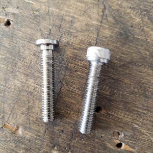

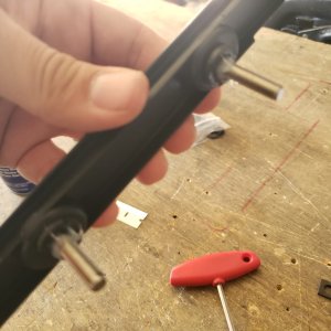

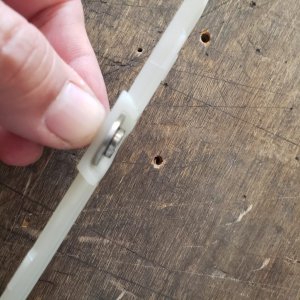

Difference between a standard socket cap screw and the low profile ones I went with:
UFcJVYZGib TYwidth1024height1024cropmodenone
Here's why:
LJk4VzoZZlFrmwidth1024height1024cropmodenone
XxxEaK omD8nUwidth1024height1024cropmodenone

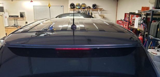

After look:
O9SgU0yrG8qk1Hwidth1024height498cropmodenone
Comparison shot:
OGF0qagmldjk width1024height1024cropmodenone
And there ya go. What you guys think?

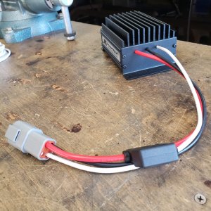

Enter the fuel pump voltage booster, known to many as a Boost-A-Pump, or BAP (although that title is usually in reference to the Kenne Bell version of the device). The theory here is, the more voltage to the pump, the more work it can do. Pretty simple, right? Well, it's a bit more involved than that...so here goes.
The OEM fuel system in our platform is a returnless, pulse-width modulated, direct injection system. What that basically means is, there is a fuel pump driver module (FPDM) that is sending PWM signals to maintain a system pressure that the HPFP can use to push the rail pressures to above the 2000psi mark. It isn't like the old school pumps that just ramp up and down in speed to maintain that pressure, but rather, turn off and on at an incredibly fast rate. This means, you can't simply interrupt the voltage signal going directly to the pump, you need to interrupt the signal pre-FPDM.

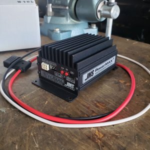

So, on the advice of Carl over at Vapor Worx, I decided to go with the JMS version instead of the Kenne Bell or MSD. The JMS version has a reputation for having the cleanest output signal and has some pretty cool ramp in/out features that I found I'd like to use as well as being able utilize a 0-5vdc trigger if required.

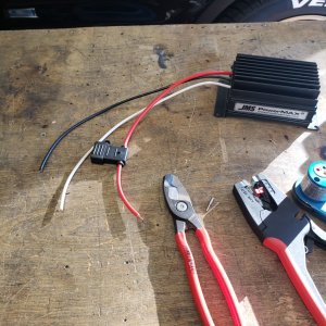

It all began with the arrival of the pump:
Td3hNT8zu59 Mwidth1024height1024cropmodenone
It comes with everything you need to get this thing up and running. That includes a Hobbs switch for using boost as a reference if you are so inclined...

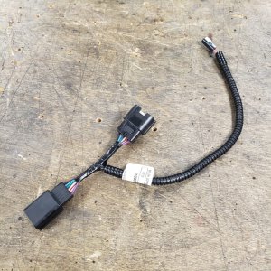

However, I really wanted to utilize the 0-5vdc trigger feature of this device as it allows you to fine tune a ramp in/out rate if you desire (and I do). So where do I get a 0-5vdc reference? Hmmmmm...well, you really DON'T want to tap into the MAP sensor signal as the act of tapping it can sometimes introduce noise into the system and have weird effects on the vehicle. You also don't want to tap into the Throttle Position Sensor (TPS) as that can open and close at various positions not equating to actual fuel demand. I guess I could install a second, dedicated MAP sensor, but that would be over-engineering the solution. Why not just go with a solution that JMS already had in-place. Use of the accelerator pedal position (APP) sensor. Because I like plug-n-play, along with the ability to "EDIT/UNDO", I opted for an off-the-shelf solution from JMS. They had a Ford wire harness for purchase:
NEIneLtB43hGBwidth1024height1024cropmodenone
But if you want to keep it on a budget and not purchase the adapter harness, simply splice into wire #2...

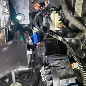

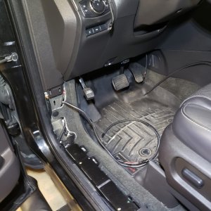

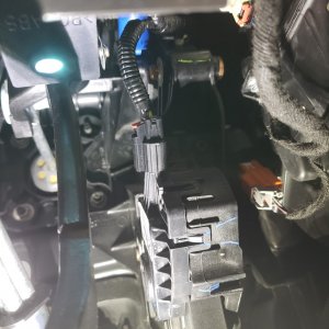

The accelerator pedal connection before installation:
XKLQMDfHnx4Wxwidth1024height1024cropmodenone
After installation:
Uz PURZbs3m38width1024height1024cropmodenone

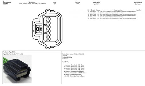

Since I was going to use the pedal position as my 0-5vdc reference, I had to see what the actual range of output was. Just because it is a 0-5vdc output doesn't mean it's at that exact range. Below is a photo of the voltage at rest (left) and the voltage value when the pedal is floored, simulating WOT (right):
VYlStNWQYIT42width1024height1024cropmodenone
This test was done key-on, engine-off.

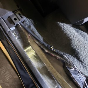

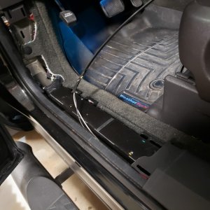

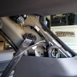

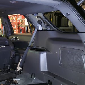

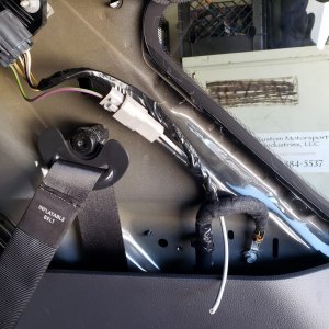

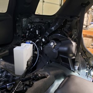

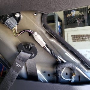

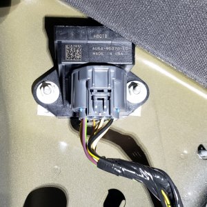

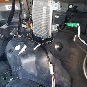

Next was accessing the FPDM. Even though it is underneath the c-pillar cover, because of the way Ford decided to assemble this car, you have to remove almost the entire rear interior, lol....ugh.....
Here is everything off but placed loosely back into position, other than the c-pillar cover:
DDFUb91S5jcYcwidth1024height1024cropmodenone
Y3tFj7CV90k Dwidth1024height1024cropmodenone

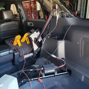

It was at this point that I did some data collection on what the FPDM is seeing. I have two Fluke meters so I decided to also see how that voltage compares to what the pedal sensor is putting out. Here's a video compilation:
I have plans to wire this in such a way that I can remove the BAP and put it back to stock relatively easily. This requires the use of my extensive Deutsch connector set:
TMzLL6evvnr87width1024height1024cropmodenone
Here is the JMS "wiring" guide and which wire is needed to be intercepted:
CZT7LG2W7ruPMwidth1024height1024cropmodenone

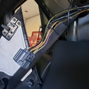

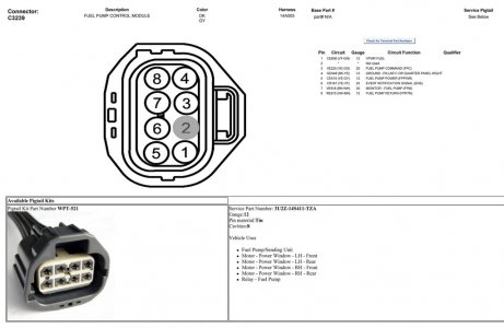

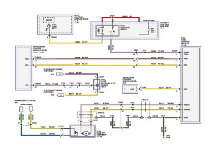

And here is the OEM wiring schematic along with connector C3239 pinout, the wire of concern here is wire #1:
GcY cI1TzNCYVVwidth1024height724cropmodenone
Z0HSbdTog5YV1twidth1024height667cropmodenone

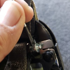

Tape peeled back and power wire exposed (Purple/Green Stripe...Incredible Hulk colors, how appropriate for the POWAH wire, LOL):
RUPSGCJIKL43jwidth1024height1024cropmodenone

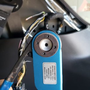

Using a specific Deutsch crimper...
R GnwjEZCcDqcwidth1024height1024cropmodenone
...you can make these male/female ferrule crimps:
6Gb0ZRtcuZpyfwidth1024height1024cropmodenone

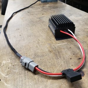

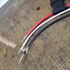

Now onto the BAP connector itself. The wires are just cut wild when you get it from JMS, but I took a page out of the MSD book and used a DTP Deutsch connector end here as well:
QREuz24N8OztPwidth1024height1024cropmodenone
Ymrt2VGMt44GLwidth1024height1024cropmodenone
PpdcS7P  jZSDwidth1024height1024cropmodenone

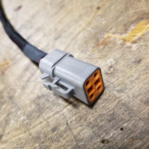

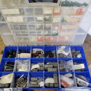

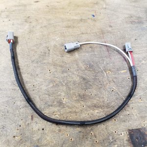

Now to make the harness that connects the BAP to the FPDM using more DTP Deutsch connectors:
9lt Hs8rq3qZRwidth1024height1024cropmodenone
0KVpSO1lQVi 3width1024height1024cropmodenone
Going to leave one end wild for the time being until I identify where the BAP will be physically mounted so I can figure how long the other end needs to be.

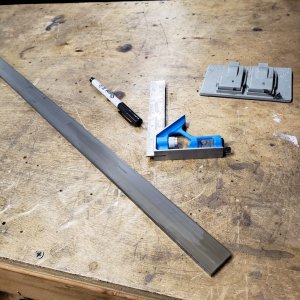

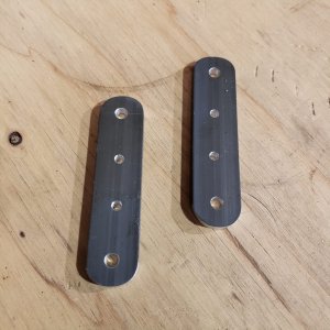

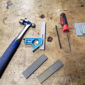

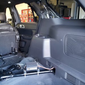

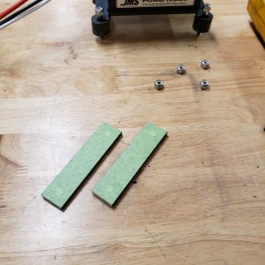

For the time being, onto the mounting location and brackets. I decided I would secure the device to the roll bar that is in the cargo area. Thought it would look pretty trick and also be close to the FPDM.
For the base brackets, I used some 1" by 0.25" aluminum bar stock I had laying around. I cut two pieces 4.125" long and started measuring them up for some mounting holes:
L01WdiZ6vPf0Mwidth1024height1024cropmodenone
RYV6iVfZcG72vwidth1024height1024cropmodenone
9FPGsxScnGFVQwidth1024height1024cropmodenone
I'll round the edges and make it look nice and likely powdercoat these as well.

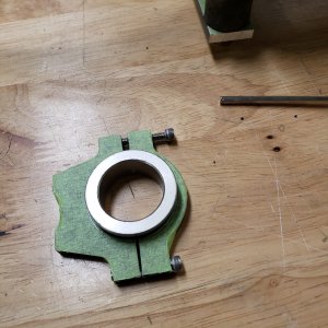

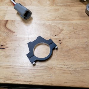

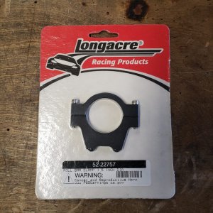

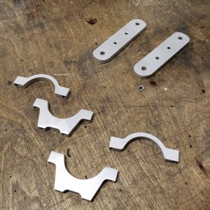

For the roll bar attachment, I got 2 of the 1.50" Longacre mounts:
BB2C5VYuRhgf5width1024height1024cropmodenone
There was one small issue. The roll bar wasn't an exact 1.50", it was more like 1.55". Not much, but enough for it to not fit properly. I was going to have to do a little bit of grinding on it...so I conveniently had a spacer laying around that was 1.50" with a shoulder of 1.60". It worked out pretty nicely to give me an edge to go off of:
IRGtQWmLrfSLQwidth1024height1024cropmodenone
QSu5atns ct4Kwidth1024height1024cropmodenone
4qPDk524ZZ4M1width1024height1024cropmodenone

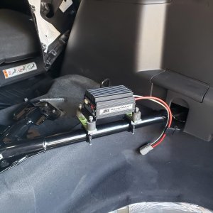

I'll likely powdercoat these along with the above brackets. In addition to the brackets, I used some of these rubber isolators to give it some vibration dampening:
P VvJS3IOPi62Owidth1024height576cropmodenone
Here's the device mocked up:
1NufCKOvRpVmxwidth1024height1024cropmodenone
Now I can start making the connecting wire harness. It's running behind the wheel well panel cover and up to the c-pillar:

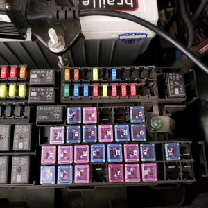

So, JMS calls for replacement of the FPDM fuse and upgrade it to a 30A fuse. Well, it just so happens, the fuse for our platform's FPDM is already 30A (the only green fuse in the photo). It's found in the Battery Junction Box under the hood, position F65:
L7oKZzMn8SyLXwidth1024height1024cropmodenone

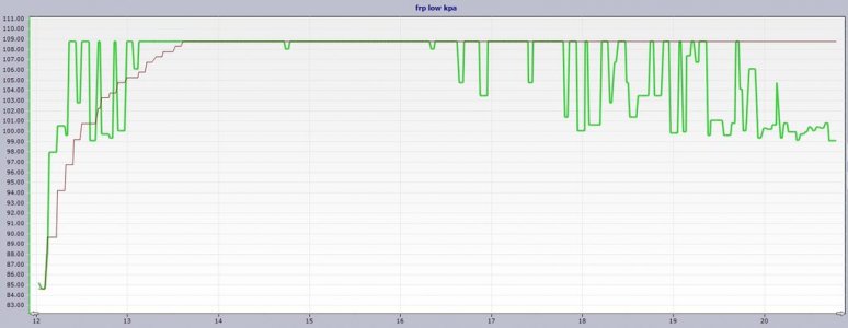

Once that is done, now it's time to crank it up, do some testing setup and test this puppy out! This is a hot mess as I'm simply doing setup/testing to make sure everything works:
TgrR 1XNBnHvZwidth1024height1024cropmodenone

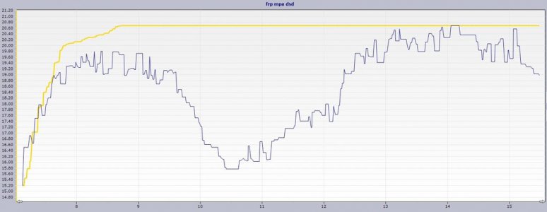

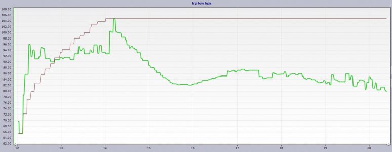

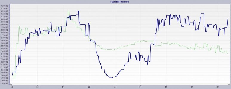

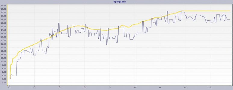

So, what settings am I using, you ask? Well, According to Deatschwerks, the pump is good for spurts of 18.0vdc. The highest I saw this at WOT was about 14.8vdc. I want to ease into it for now, so I'm not going to go over 17.0vdc.
So, I got it setup for maximum voltage boost of 17.0vdc. Using the pedal position sensor, I want to ramp it in using the largest ramp the unit allows for, a 1.2vdc sensor ramp. I have it set to begin boosting at a sensor reading of ~1.40vdc (~20% "throttle"), which means it is at full 17.0vdc at ~2.60vdc (~55% "throttle").
During testing at idle, it sees standard vehicle voltage, but as soon as the pedal is depressed, once it gets to the 1.4vdc value, you can see the FPDM voltage increasing. Now to take it on the road and see how it responds...

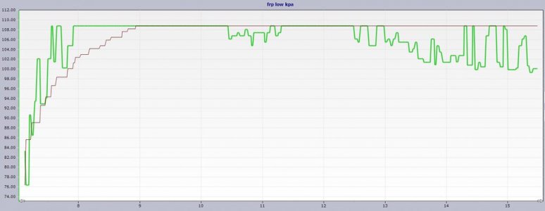

...road testing turned out interesting and I'm actually very pleased at the improved pressure readings. I did a log both before and after. Here are the results, all else was equal including the tune. This was a 3rd gear run from 2k RPM all the way to 6k RPM.
Before BAP:
Brown = Low Pressure Desired
Green = Low Pressure Actual
LS2McgANeQf0FLwidth1024height397cropmodenone
Before BAP:
Blue = High Pressure Actual
M9sVfBDejercwJwidth1024height397cropmodenone
Before BAP:
Yellow = High Pressure Desired
ABR4IaBeVuEQ4Vwidth1024height397cropmodenone
With BAP (no tune revision):
KmjgfmVexmKHJAwidth1024height397cropmodenone
KyAEwj3G9zC0UBwidth1024height397cropmodenone
9wwysvJBEEG1mtwidth1024height397cropmodenone

Fuel Pump Voltage Booster (aka Boost-A-Pump) Part 04
As you can see, the low-side actual pressure was quite a bit better than the run without the BAP. This tells me there is a bit more flow. It could still use some help at the end, but it's markedly better.
So, now that testing is done, onto final assembly...
Here are those brackets rounded out:
EifvWgiDtKUg width1024height1024cropmodenone
And all the small pieces soda-blasted. I'm leaving it raw aluminum but may end up powder coating them once I get enough other stuff to make a decent size run:
OEOKjllsZJ Lmwidth1024height1024cropmodenone
Secured the wire harness behind the interior panel:
QWC1l LmxlvQkwidth1024height1024cropmodenone
Final position of the BAP:
0EoO6JRol5JJ4width1024height1024cropmodenone

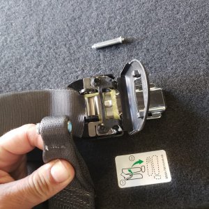

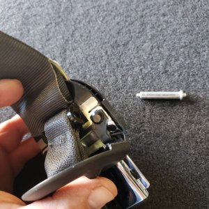

And I decided to leave that small c-pillar panel off permanently for weight savings! No, seriously, I'm going to leave it off as I may need to access this area from time to time. One issue is the seatbelt goes through it. I've got the airbag seatbelts so it took a few steps trying to figure out how to get that big click connector through the hole without cutting the panel.
PY7DT2vX3YAL3width1024height1024cropmodenone

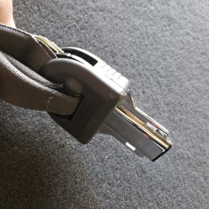

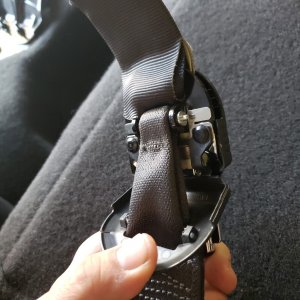

Separate the plastic halves. They just pry apart:
SESceEKZxz7QZwidth1024height1024cropmodenone
You'll have to push down on the spring metal tab under this side of the pin and pull the pin out. The tab holds the pin in place:
XRIWnjt3U38k3width1024height1024cropmodenone
Here is the pin removed, and you can see how it holds everything together:
5jlaiJk2dfuNgwidth1024height1024cropmodenone
And here you see everything separated. Just pull the belt through the hole of the c-pillar cover and re-assemble the seatbelt...too easy:
3UGG2NoJZwIQdwidth1024height1024cropmodenone
The trigger wire that goes to the pedal position sensor I am running down the other side of the vehicle. Here's the other interior panel off:
SZkjXJt4jyzjXwidth1024height1024cropmodenone
Running it down the rear passenger door sill:
KTrgGgqW6mzVswidth1024height1024cropmodenone
Front driver doorsill:
4B1PpxKQKfFz0width1024height1024cropmodenone
And up into the foot pedal area:
LRwb0sHysWpoVwidth1024height1024cropmodenone
Cool little cheap tool I learned to use when I worked at a car stereo install shop...a very large HVAC zip-tie (36" long or so) with the head cut off. This is an AWESOME tool for feeding wires through places...get em from your big box hardware store. It's definitely one of my "must-have" tools as it's been indispensable throughout the years.
Anyway, once the wires were run up into that area, everything was reconnected and tested. All the interior panels where put back together and all is done! Now to go get some datalogs!
PRsyXY6RFn3KPwidth1024height1024cropmodenone
So, some results after a tune revision (btw, I'm still dialing this tune in with Brad, so this isn't the final tune).
With BAP (with tune revision):
4vzjlSBAkfu  0width1024height397cropmodenone
Eg4gyNdwZOuJEwwidth1024height397cropmodenone
Ub55LxK Qq8EtJwidth1024height397cropmodenone

Lol thanks for the compliments. But no, I'm just a self-taught gearhead with a severe OCD complex, lol. Locally, I'm actually known for my wire harness building as I do it alot for various things, mostly building harnesses for custom bikes. So I own alot of specialty crimping and pin removal tools as well as a wide selection of connector types, terminal ends and sheathing.
As for the tune, absolutely I feel a difference. I now having traction problems more than I've ever had. I really need to get some better tires....lol.
