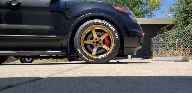

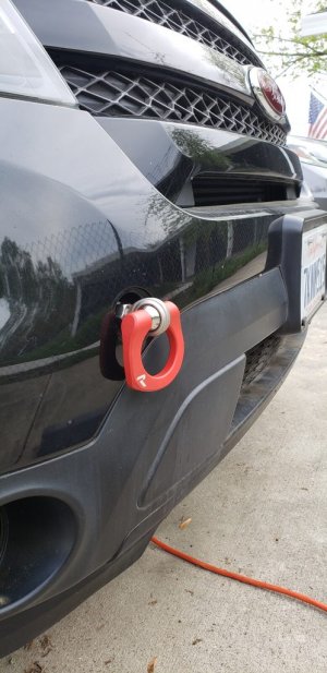

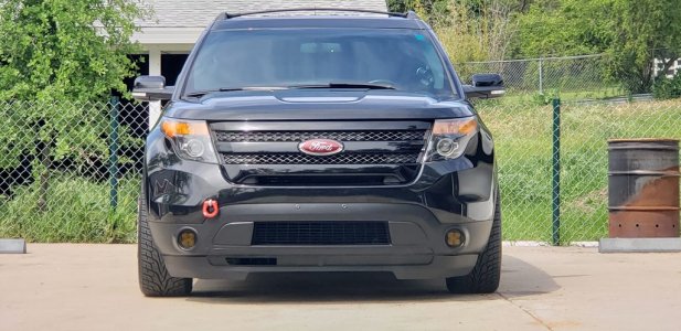

So I'm one of those guys who likes the look of those red tow hooks folks have been rocking lately. I'm a function-over-form guy normally so I was apprehensive about a mod like this as it does nothing for performance and it's purely cosmetic. Figured the circles I travel in would laugh at me for "trying too hard" lol...
So, after some thought, I decided to say screw it, lets just go for it. Most feedback has been positive but I do get the occasional hater-ation. Oh well, if I'm not ******* somebody off, I'm doing it wrong, lol.
Final product:
4k Fad yyC2wpIwidth1024height498cropmodenone
Being the guy that I am, I decided to write this up so you lovely people can enjoy it yourself. There is NO high-end aftermarket tow hook for our platform, so I decided to do some experimenting. It's not a cheap mod. Even though I spent more due to my experimentation, all in, you're still gonna spend about $240 not including any shipping or tax.

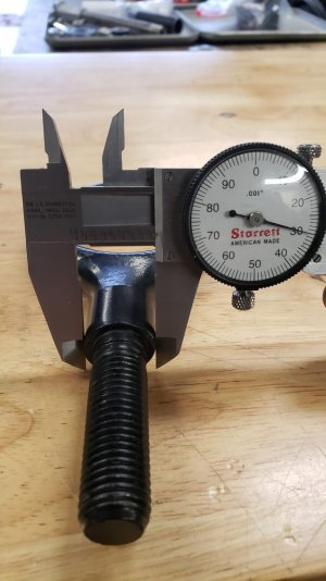

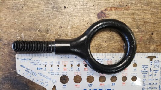

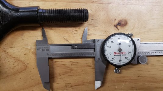

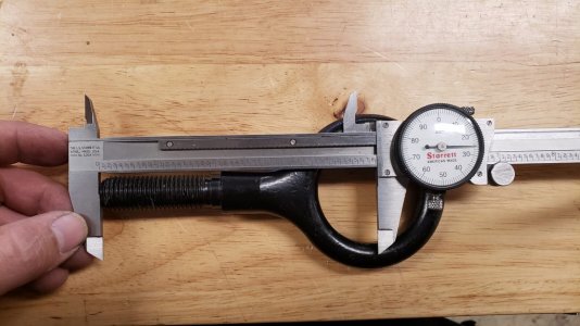

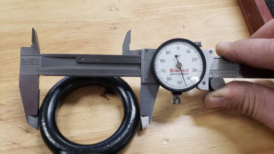

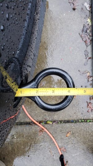

So, it all started with the factory tow hook and getting dimensions...
Df wgu4VOZyL9Vwidth1024height576cropmodenone
QXJMmOaNAHw8XZwidth1024height576cropmodenone
X4BeKtoFiIb28iwidth576height1024cropmodenone
G5fyPKV2z9HKahwidth1024height576cropmodenone
LPTew5RwWvISFrwidth1024height576cropmodenone
Pg2TmyybdoSrhcwidth576height1024cropmodenone
The tow hook I was dead set on is a product by RaceSeng.
TErhmlSNFuF8mTwidth1024height570cropmodenone
They make some decently high-end tuner parts. Their tow hook is a two-piece design so that the hook, which has a short universal threaded end that is M18-1.5...
TwGOO XDNC0mmHwidth1024height498cropmodenone
...and per whatever application you have, order the appropriate tow shaft, which is specific to each vehicle. Well, needless to say, they had no application for our platform. The threaded hole beneath the tow hook cover in the front bumper is M16-2.0. I reached out to them, but they did not seem interested in doing anything for this vehicle. So then I tried to do a TON of research to see if any vehicle they did have had a similar thread pattern and came up blank. It was tough because they don't list thread patterns, but only part numbers. Had to spend a lot of time on Google to research.

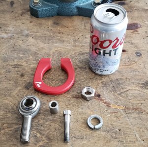

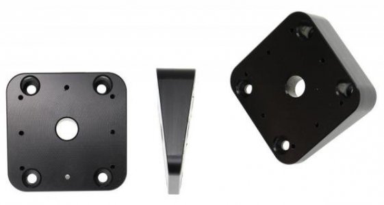

So, I decide to see what i could do anyway. I ordered the tow hook, the GoPro mount, and a tow shaft for a Nissan GTR, as their thread pattern is M24 something or other. That was enough meat on the shaft (bring the jokes, ppl!) for me to do some magic on the lathe...I was determined now! LOL.
So the Nissan GTR shaft portion looks like this:
 dOTnlMEHDFx6Mwidth1024height498cropmodenone
Here is the part machined down:
EEKFzzzGWm3YDrwidth1024height498cropmodenone
One issue is, the short M18 threaded part of the hook is too short to machine down and mount in the stock bumper hole, but when you add the tow shaft, it's now too long...I tried to machine it down shorter but would end up compromising the way the M18 threads into the tow shaft.
I thought this wold work, but when I installed it onto the bumper, it just looked ridiculous. It sat so far out away from the bumper. It needed to be an entire inch shorter to be anywhere near good looking. Sorry but I took no pic of that, was too bummed out my machine work didn't work out...
Anyway, I put the whole thing away for awhile and forgot about it. Well one day I was thinking about it again and something came to mind I had used on another application. A heim joint!! It would work, and probably better, but then I just had to find the right one, so I headed over to McMaster, they are the SHIZZLE when it comes to hardware. Especially obscure, hard-to-find stuff.

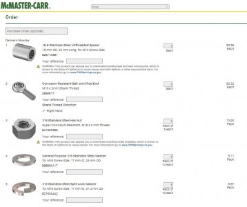

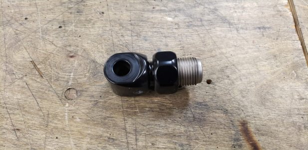

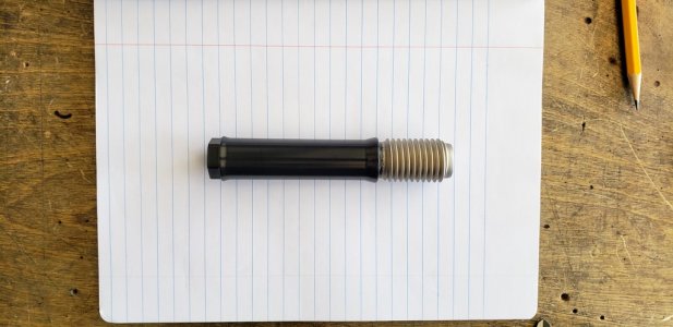

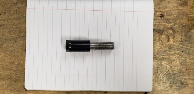

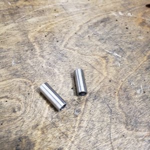

Well, I pretty much found what I was looking for. The threaded part of the heim joint is a little on the short side but would work well enough. I took some measurements of other parts to see what additional hardware I would need. Everything I buy when it comes to stuff like this is 316 stainless steel or at the least 18-8. Better for corrosion resistance. Below is a pic of the shopping cart:
VhZzXEsFFVp7BCtwidth843height707cropmodenone
Since the bolt that goes through the RaceSeng shaft body into the tow hook is an M10 and the hole in the heim joint is an M16, I had to get the spacer and prayed it would work...here are the parts you're gonna need:
GD9ONNlHsZi1cwidth1024height1023cropmodenone
Yes, that includes the beer! Here it is assembled:
5k1tT3fw6gbqfwidth1024height1023cropmodenone
The only thing that sucks is, I couldn't use the GoPro mount...but oh well..ya win some you lose some. When you mount it, use some blue loctite as a double protective measure in addition to the lock washer. ****, you could even use red loctite, but good luck getting that off if you need to remove your bumper, LOL. Here are some mounted pics:
00tw8RjgOi56Zvwidth498height1024cropmodenone
The joint itself is very, very tight, so that is perfect! The hook does not swing around banging against the paint. It will absolutely stay whatever angle you put it. I've taken it up to pretty severe highway speeds and it is rock-solid. But it is loose enough to move around if needed. Caveat: I have no idea about actual towing. It's pretty tough but tow at your own risk. As I said, this was purely cosmetic, but I still wanted to have some quality product and not some cheap made-in-China part.
I actually like this setup better than the complete RaceSeng setup for a few reasons:
1) I love the look of stainless parts..they just have that...aircraft-grade look.
2) Since you can rotate it from side to side, you can "lay" it at the angle the bumper sits/flush, so it doesn't look like its hanging off weirdly.
Anyway, yeah I spent a lot of money I didn't need to and for something that really will serve no purpose but to say "Hey everybody, look at me!!" LOL. But, I digress.

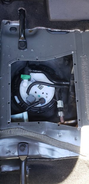

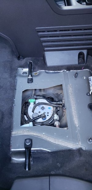

Just a short (by short, I mean LONG) and unedited video of the install of the DW300c into the hanger assembly. Pretty straight forward but there are a few things not covered in the instructions and some helpful pointers I discovered. Perform at your own risk. Definitely one of those "how the sausage is made" videos and if you have an aversion to cutting into OEM stuff, it might make ya squeamish, LOL. Anyway, just one way I found to skin this cat, I'm sure there are others.
Part 01
Part 02
Part 03

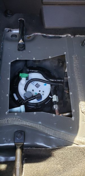

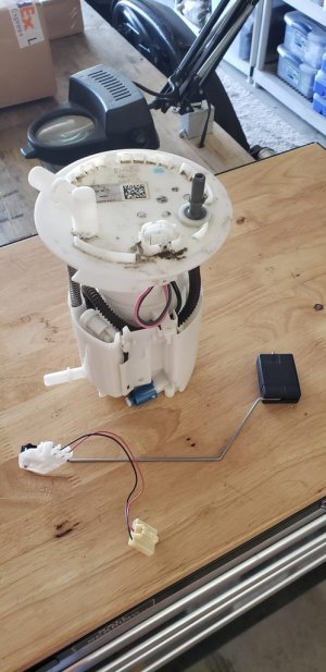

Stock LPFP hanger assembly:

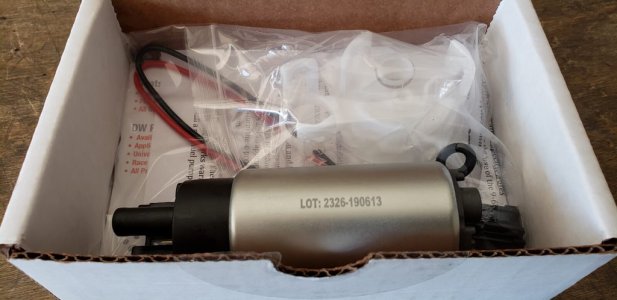

DW300c in the box:
IcMpCPGDfhI26hwidth1024height498cropmodenone

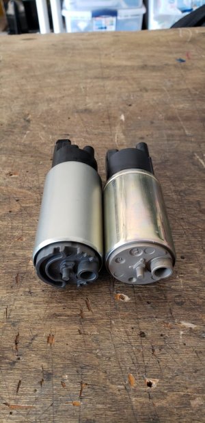

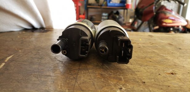

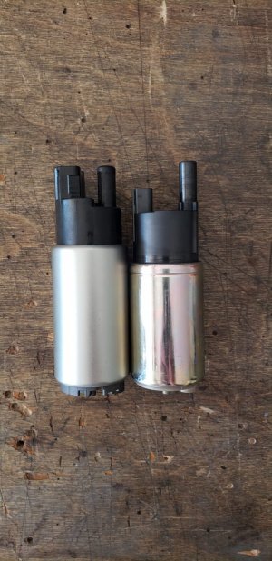

Some comparison photos between stock pump and DW300c:
24uF0CIclNzR3jwidth498height1024cropmodenone
KVfL8uBu3f4j Owidth498height1024cropmodenone
F85A0obqotraeqwidth1024height498cropmodenone

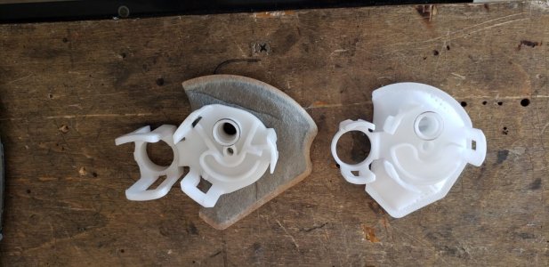

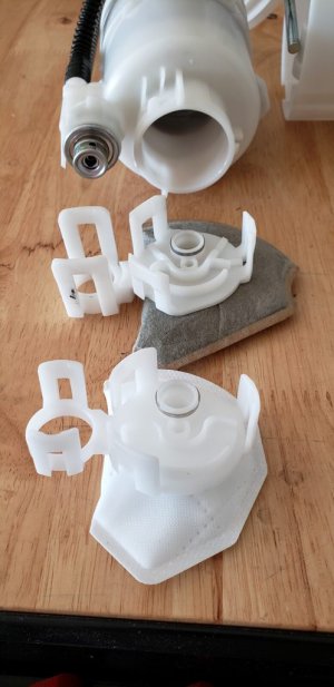

Comparison photos of the stock filter sock vs. what comes with the DW300c. In the video, I show how you will have to slightly modify this part to make it fit right.
CraPV7ER875UIjwidth1024height498cropmodenone
De8vcbwm2O Sevwidth1024height498cropmodenone
ZGIgETPaNyp0FBwidth1024height498cropmodenone
F 3ho1qVjyyyRnwidth498height1024cropmodenone
Silicon plug to keep the plastic shavings out of the pump internals when trimming the inside.
A0GO FH1X SRJnwidth1024height498cropmodenone
Video showing how the DW300c doesn't fit right into the filter sock. This is before modification of the sock assembly.

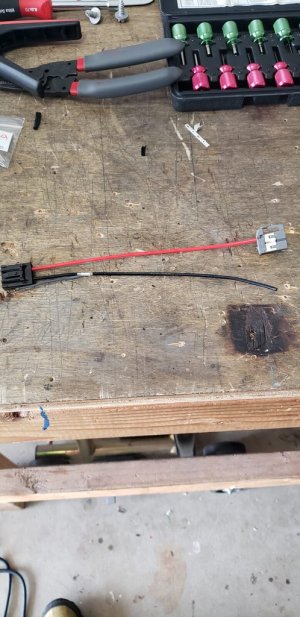

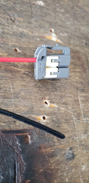

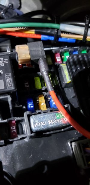

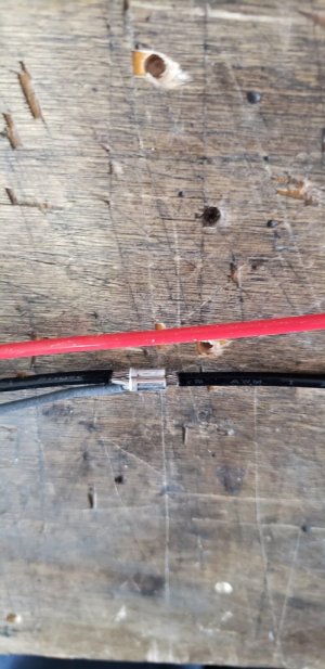

A few more close ups of the wire connector (Toyota PN: 90980-11080) I modified in the install video.
SHs do5l6Bu8ljwidth498height1024cropmodenone

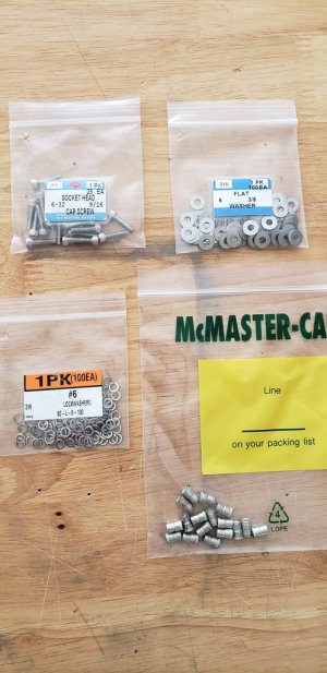

Links to the pins/splices you'll need:
KXyfJofSikZM6Gwidth498height1024cropmodenone
RvsNCUBFZyHhejwidth498height1024cropmodenone

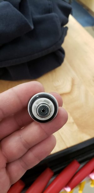

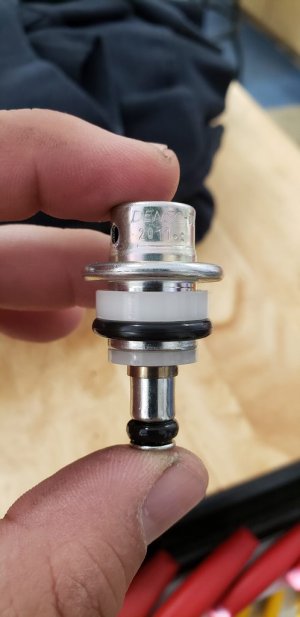

Here's some extra pics if anybody wants to know details on the fuel pressure relief valve that is inside the hanger.
AxSgB7IakH1eyOwidth498height1024cropmodenone
MWN8iv0v3UoynGwidth498height1024cropmodenone
NbhPvtow6hRfXAwidth498height1024cropmodenone
UYjNI0EvT2e6CWwidth498height1024cropmodenone

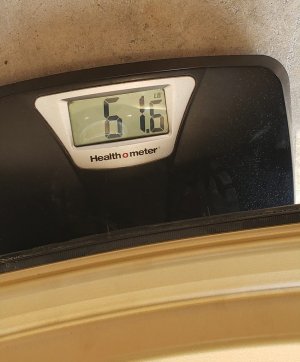

Weighed Vehicle

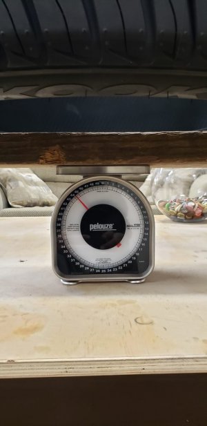

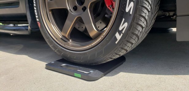

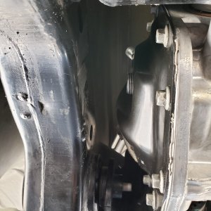

So for years I wanted to easily be able to weigh my project cars...accurately. I've done the recycle yard scale thing, but I always felt it was too vague. Not that it doesn't work or that it isn't a viable option, I'm just looking for more accuracy and easier access to it. So...step into the ProForm 7000 pound Slim Wireless Vehicle Weighing System
ProForm 7,000lb Scale
I got it for what I felt was a decent price. Who knows, maybe I can start charging a few bucks a pop at car meets for people to weigh their cars and make some of my money back, LOL...

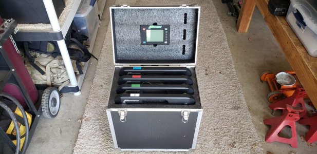

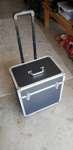

Anyway, here's the case it comes in. It has rollers and all:
PVSwwYBluvvLQIwidth498height1024cropmodenone
Inside of the case:
TVPxuItY78WEWFwidth1024height498cropmodenone
Weighing the vehicle:
GjwwPaRTYUZJ4wwidth498height1024cropmodenone
O OaXEWaTm9xTCwidth1024height498cropmodenone

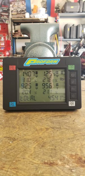

And as of April 18, 2020, here's the weight:
KYNUSV3RostIvJwidth498height1024cropmodenone
Pretty awesome...I'll update from time to time as I do weight changes. But now I can input my accurate vehicle weight into various apps that use it for calculations.

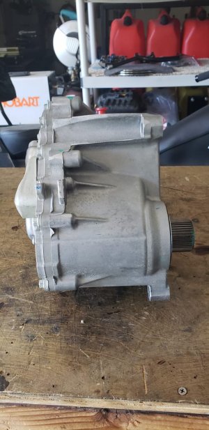

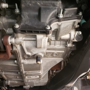

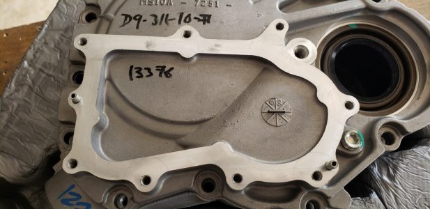

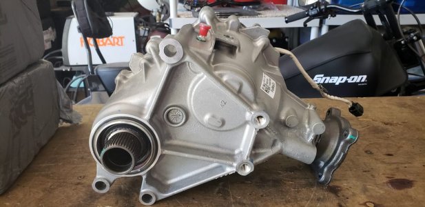

PTU Improvements Part 01
Original Post: https://shoforum.com/index.php?threads/ptu-build-thread.141439/

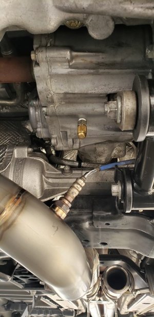

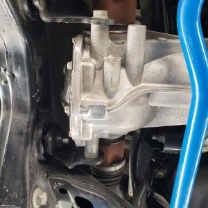

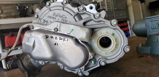

So, this is my attempt at doing what little we can to improve the PTU with what is currently available. I’d also like to make it a resource for those of you looking for detailed photos of the latest version of our PTUs (which has the cooler). I’ve completely torn down the PTU, and sourced all brand-new seals for it. I will keep the photos at max resolution so apologies for their size, but some may find it helpful.
In this photo, looks like the vehicle is beginning to experience some of those dreaded PTU failure symptoms. Last time I was underneath the truck, I saw quite a bit of oil covering the body of the PTU, and soaking the portion of the exhaust that sits underneath it. It hasn’t failed, in that I don’t have any drive-ability issues yet, but it is coming I’m sure. I will say, that I have NOT been proactive with changing of the fluid. Not because I’m lazy but because I was not aware of the PTU issues until very recently. Call it my ignorance on it, but regardless, I’m glad I caught it when I did. It’s a 2015 with just a hair over 30K miles on it. I don’t drive it much, believe it or not, this is pretty much my dedicated project car.
62IJTMfw8gotMwwidth576height1024cropmodenone

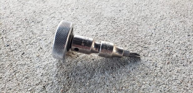

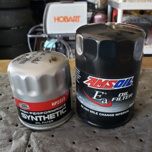

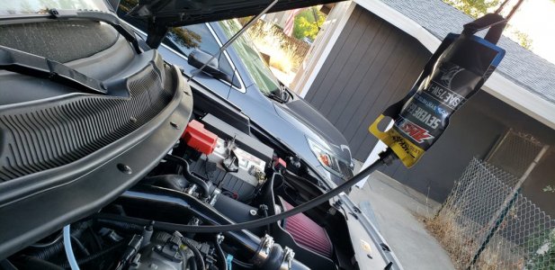

Anyway, being the consummate prepper that I am, and wanting to keep downtime to a minimum, I went and purchased a brand new one before I am even taking the old one out.
Ford Part Number: DG1Z-7251-F
My punch list for things I want to accomplish with this:

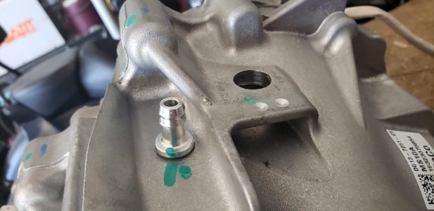

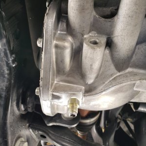

  • Change drain plug to bottom of case in order to ensure complete drainage of fluid when performing oil changes.
  • Extend hose from vent to top of engine bay to facilitate future oil changes and fills.
  • Send all gears and cast components to receive WPC treatment (WPC Treatment).
  • Send all gears, cast components, bearings and case to receive cryogenic treatment (Nitrofreeze).
  • If possible, research possible higher quality bearings to replace existing ones.
  • Apply gold metallic radiant heat reflection material to outside of case.

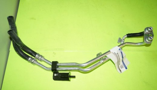

Ford Part Number: BB5Z-8A519-G
LJ8rrPNsv7peQHwidth1024height592cropmodenone
Then run your lines through an aftermarket pump and heat exchanger of some sort. It would be a pretty trick setup if done right.

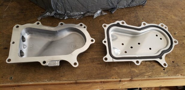

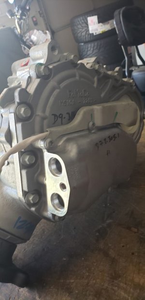

As I disassembled it, here is what the cooler actually looks like. It isn’t very complex, I wonder if there is any way to improve it:
 8d7Rj 9Of9Gi5width1024height498cropmodenone
ElzOGRz48FajuWwidth498height1024cropmodenone
NHiNYE6pyCxU twidth1024height498cropmodenone

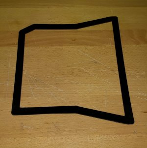

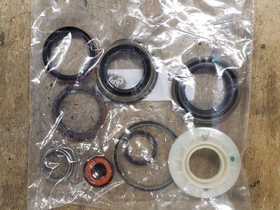

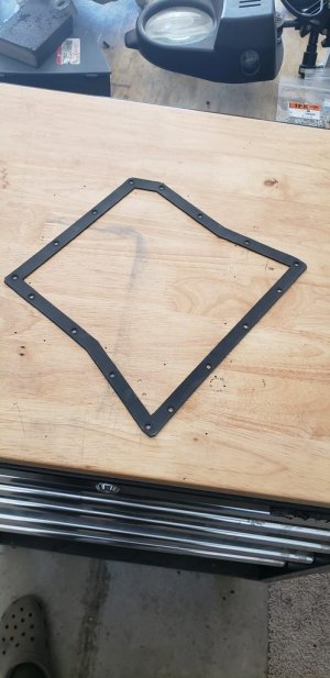

So, before I started complete disassembly, I ordered a replacement for every single seal, gasket or one-time-use part as I wasn’t sure how much I would destroy trying to take them apart. Below is a list of all the Ford Part Numbers you will need as far as seals or seal kits go:
  • 7T4Z-7086-A (Qty: 1)
  • 7E5Z-7H469-C (Qty: 2)
  • DB5Z-7275-E (Qty: 1)
  • GB5Z-7275-A (Qty: 1)
  • 7T4Z-7R284-A (Qty: 1)
This does NOT include replacement of the cooler medium. The edges of it are rubber, but it was in good shape and I couldn’t find the part number anyway.
Here’s a bag of all the old seals after being removed. The stuff in this bag will be thrown away, but not until it’s all done, LOL:

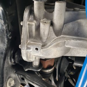

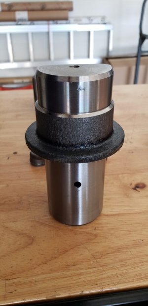

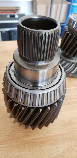

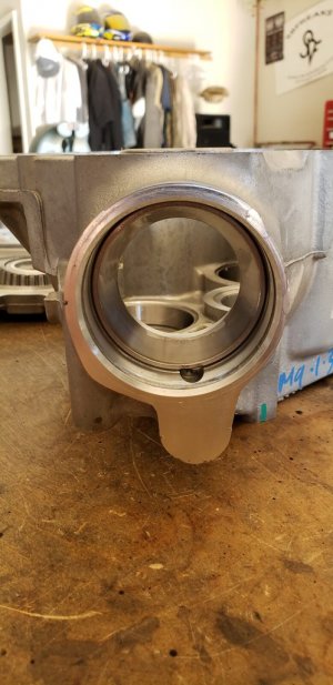

When you take it apart, make sure you have some sort of catch for the oil that will come out, as it comes filled from Ford. I have a large oil drip cookie sheet that I was working on. Worked great! BTW, I forgot how much I hate the smell of gear oil…

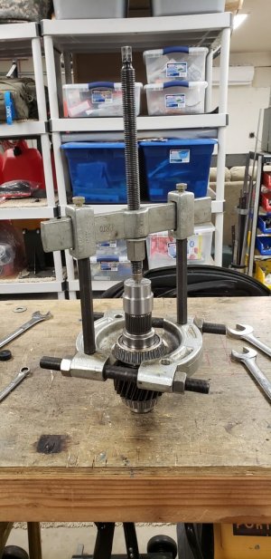

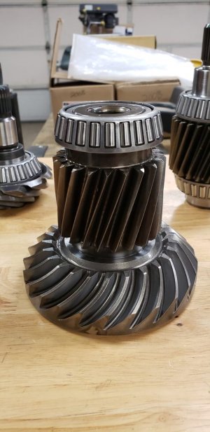

When you finally get it apart, you will find it somewhat difficult to remove the gears from the side of the case. In order to remove them, you will have to basically destroy the white end seal/plastic cover that is pressed onto the end of one of the gears. Make sure you get a new one, but once you do, don’t be afraid to just break it, it’s hard plastic. Once it is off, the gears will all come out one after the other.
N920jzKb3tYOFdwidth498height1024cropmodenone
WKs2k0PMkcIoSpwidth498height1024cropmodenone
I just used an air impact to remove the nut off the end of the pinion gear. That nut will be replaced and is included in the new parts kits. Be advised, many of the seals will have to be destroyed when removing them.

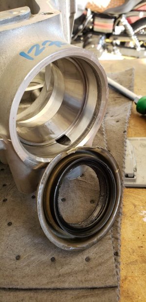

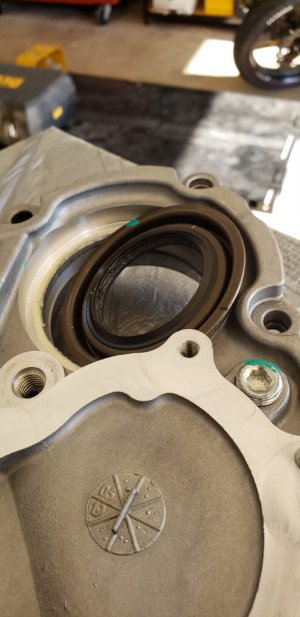

I decided to remove all the seals as I wasn’t sure if my disassembly would damage them at all and, more importantly, they may not survive the cryo process. So, when I send all the parts to cryo, they will be disassembled bare metal.
Ix8HPTSjZjgWmXwidth1024height498cropmodenone
OXbCLNG4M0kQtcwidth498height1024cropmodenone
Cf2 yHsumPH1IZwidth498height1024cropmodenone
U14njlKQNZZLuxwidth498height1024cropmodenone
AYJOMDopIxf2wLwidth1024height498cropmodenone
Mvb61RMRYadT xwidth498height1024cropmodenone

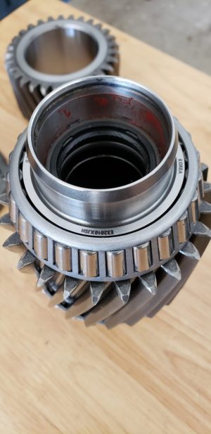

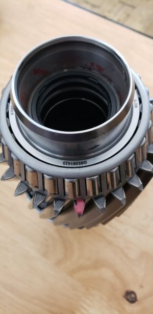

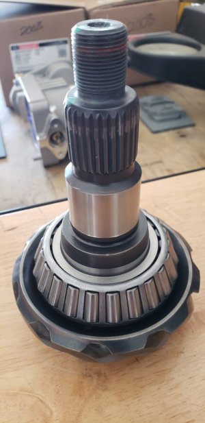

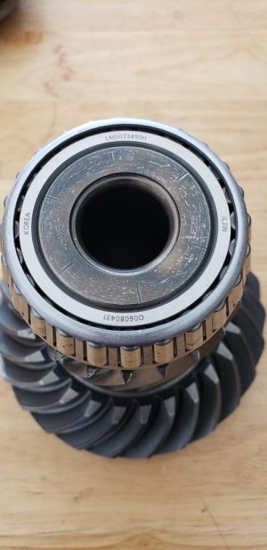

As for the bearings. My goal is to try and source some higher quality ones, if they exist. I imagine Ford made some specifications for bearings they needed, then sent out the contract for the lowest bidder to meet those specs. Most of the bearings are Iljin, whom I’ve never heard of, but looks to be a Korean company. I’ve found some in-depth documentation on some of their bearings but so far, nothing about the ones within the PTU specifically. I’m hoping to find some equivalent or better versions via Timkin or Torrington, maybe some SKFs. I removed as many of the bearings as I could:
8E5QJyEZ6qK adwidth498height1024cropmodenone

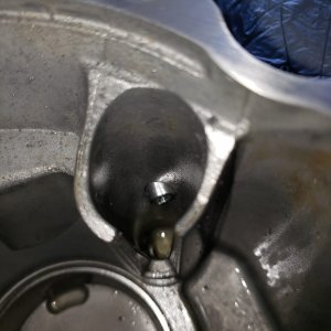

The only one I cannot remove was the one behind the pinion gear head. It sits in a recessed pocket and no puller can get behind it without destroying the bearing cage. Even though I will begin the process of looking for better grade bearings, I didn’t want to risk destroying this one as it may end up being a unicorn bearing and not easily sourced/replaced.
ASSISTANCE FROM FORUM MEMBERS: If anybody has an old PTU that they replaced laying around and can take it apart and either send me the pinion gear with the bearing on it or feels like removing it (even if it’s destroyed) and tell me what the part number is, I can better research it. For some reason, of all the bearings in this PTU, the parts numbers are not showing on the visible end. I think they are on the backside.
9ACQWsVLFBdXWxwidth498height1024cropmodenone

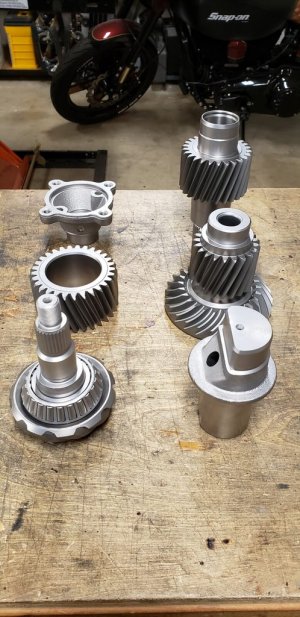

Anyway, here are all the parts I’ll be sending to WPC:
OPyCBeDL9itiL width498height1024cropmodenone
I spoke with one of their reps regarding having parts with bearings still pressed onto shafts. Their response was, although they recommend removal of all roller/ball bearings, they CAN still apply the WPC treatment, but it is absolutely imperative that a very extensive and thorough cleaning job be accomplished on the bearing prior to installation. They do ultrasonic cleaning, so it should be pretty good, but I also have a high-quality industrial grade parts washer I will put all the parts through as well once they come back.
The cryo treatment will be performed after the WPC treatment and I will include every metal component I can for that one. It will be sent over un-assembled except I will re-press all the bearings back onto their respective location. I use a bearing heater prior to pressing them on (it gets pretty damn hot) and don’t want that to cancel out any gain provided by the cryo treatment in doing so. I will do final assembly and seal installation after it all comes back home. There is no case gasket but looks like they used something similar to Yamabond, which I’ve used successfully to seal Harley Davidson Twin Cam cases. It should work fine in this instance as well. Then fill it with some Amsoil Severe Gear Oil:

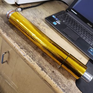

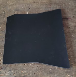

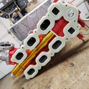

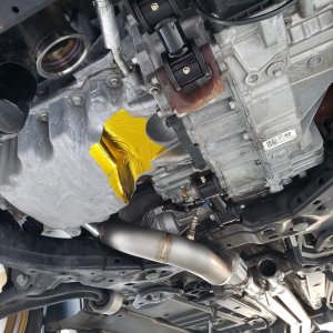

And finally, the piece-de-resistance, the reflective material.
Hv6rKO0Jxw  s6width498height1024cropmodenone
My heart tells me this is snake oil, but my brain tells me that the logic behind it is sound. I figured, what the ****, what harm can it do. It really only works to reflect radiant heat, so not sure how effective it is in the real world, especially where I will be putting it. Anyway, just doing every small thing possible to keep this thing cool, which is really the true killer of this thing.
I know it’s been said that regular oil changes can keep this thing alive, but figured I’d try a few additional steps.

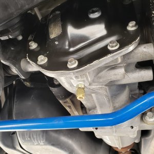

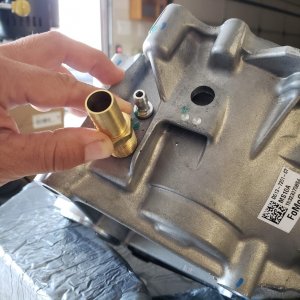

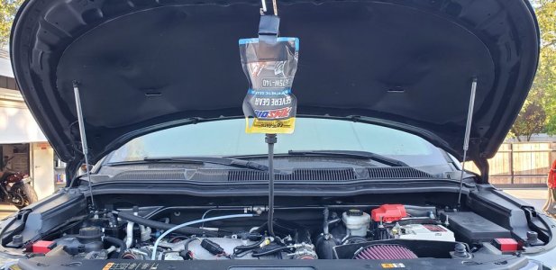

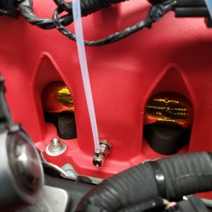

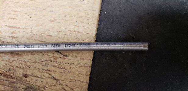

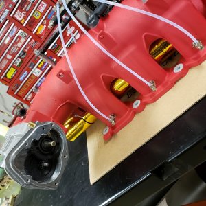

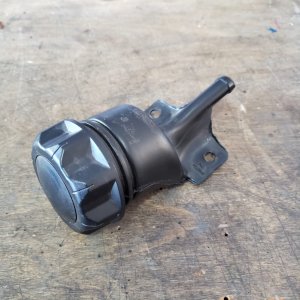

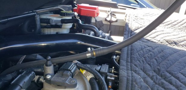

UPDATE 02: I know the idea of using a small reservoir was being thrown around and that gave me an idea. I had this thing laying around and it was originally going to be used for my meth tank to be filled remotely. I got it from ProMeth. I've since gone to a different meth tank and never used this but it looks perfect for what will be done:
OIFwIouyCbQfawidth1024height1024cropmodenone

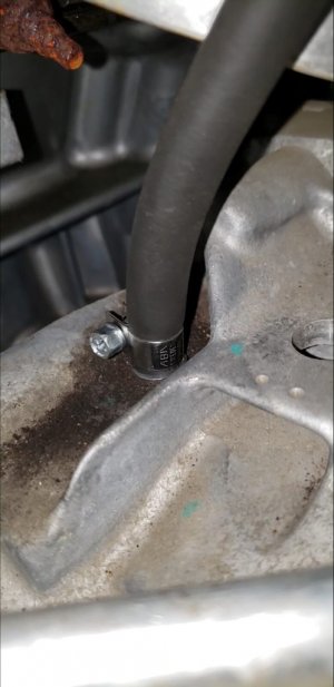

I am also about to extend that vent hose, but...PLOT TWIST...will NOT be connecting it to the reservoir. I'm just going to extend it up higher, just to be higher, LOL. But what I WILL be doing is....drilling for another hose fitting. After reading about how long it can take to get the fluid down the vent hose. I figured the air is just fighting you, but if there was another line..it would be WAY easier. Not only that, but the hose fitting at the bottom of that reservoir allows for a slightly larger hose to be used. I'm going with 1/2" on it. with a 1/2" hose barb fitting.
This photo shows me mocking up where it will go, but that isn't the actual fitting I will use, the actual one will be smaller and stainless...
EpKH0AdaYMTOiwidth1024height1024cropmodenone
See...plenty of room inside the PTU for it:
9zKJKxkgBwch7width1024height1024cropmodenone
Anyway, should facilitate fluid changes more easy. I'll update when I get closer.

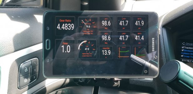

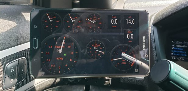

Tablet Installation For Torque Pro Gauge Display
Original Post: https://shoforum.com/index.php?thre...allation-for-torque-pro-gauge-display.142098/
This is one, strangely, that I've had tons of people ask me about whenever I drop by car meets or shows. I wanted a good compact way to showcase some of the telemetry that is possible with an OBDII reader and the Torque Pro app. Figured I'd do a write-up on it in case anyone else was interested, but all-in, it got pricey pretty quick...so cost benefit analysis isn't really in my favor, LOL. But it looks great, right?
KuJapZDEVfCX9Uwidth1024height505cropmodenone
Although the SCT Livewire I have is capable of some gauge readouts, I liked the format and customization of Torque Pro. Just pay for the Pro version, BTW. Its way more potent. Anyway, I didn't want to use my phone as 1) it would be too small and 2) I didn't want to tie up my phone while driving. I wanted a dedicated screen for it.
I really like Torque for this purpose. You can read many of the PIDs the vehicle sends and also create your own "gauges" and telemetry based on calculating values from various sensors. For instance I use it to calculate Boost Air Density (BAD) from Manifold Air Density (MAD) and Ambient Air Density (AAD) (side note: still trying to nail down if the results I'm getting are accurate, work in progress for sure).
The app does have some limitations and I don't use it for legit datalogging I need to do for tuning purposes. For that I use the SCT device and a laptop.
6gfhh0hgkAH0Mpwidth1024height498cropmodenone
N9H6lzcJfNOP4cwidth1024height498cropmodenone
That mount is created from a few separate pieces from various vendors. I got the actual vehicle mount from ProClip USA as well as a 15 degree wedge to give it that angle toward the driver's view.
Ou1yUga7 DZr8FDwidth573height430cropmodenone
KISHKpEcbjmvq0hwidth600height321cropmodenone
I use the RokForm system on every vehicle, motorcycle, work truck and bicycle I own, which makes it easy to interchange, mainly my phone, between the various modes of transportation I use. I wanted to keep the theme with this device. I like the RokForm system as it looks less obtrusive than gripping hands around an object. And it's VERY sturdy.
So I tried the RokForm perch mount and it worked perfectly. What's nice about this is, I can remove it to get the device out of the sun, or when parked at the mall or somewhere i don't want prying eyes to see it.
RRXp0CxyKFndgMPwidth800height800cropmodenone
Also, whenever I have a device that doesn't have dedicated RokForm case, I use their universal adapter, and that was the case with the tablet I am using:
Uo2EbzKNjC7z2width1024height1024cropmodenone
Here's everything installed:
K4ZMxco4329tUbwidth498height1024cropmodenone
As you see in the pic, I broke one of the tabs off taking the tablet off too quick one day. I've since fixed it as the RokForm stuff is completely rebuild-able.
The screws I used for the perch are some countersink wood screws, as the hardware that came with it are machine screws. The 15 degree wedge is made from plastic that is meant to have wood/plastic screws form threads into it.
For the tablet, I went with a 7" Galaxy Tab A. It was the right size and cheapest priced tablet I could find:
LclhsS1ly wZawidth1024height1024cropmodenone
Here's the back of the tablet combined with the universal Rokform mount:
77DB3OsWdM02Kwidth1024height1024cropmodenone

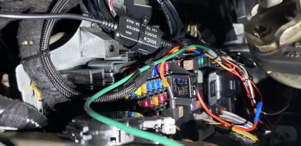

And to ensure I was always getting power to this thing and not having cords laying across the dash, I hard wired a USB Kit I got from Amazon. I ran it behind the dash and tapped into the in-cabin fuse box that feeds 12VDC constantly using a multi-fuse tap adapter from Amazon. The fuses in that box are low-profile mini fuses but a low-profile tap adapter doesn't fit in that location, so had to use a normal mini tap adapter and use normal mini fuses in the tap adapter.
Wcvs4qO64ps XIwidth498height1024cropmodenone
TOiEGGmKhrgE1Fwidth1024height498cropmodenone
In this model, the F6 fuse slot is an unused 5A hot-at-all times slot, so it was a good place to get 12VDC so that it could receive power even when the vehicle is off.
A good side view of the setup:
6B sWNNc8bJi1bwidth572height1024cropmodenone
And lastly, the OBDII sender:
Mh9EHv thI5Zbwidth1024height1024cropmodenone
There's a lot of variants out there, but the OBDLink version is probably one of the better ones. Some of the cheap knock offs don't work right or only read either the low or high side CAN. I just went with the better one.
Just bluetooth to it, open up Torque Pro and you're off to the races! I love the gauge setups and all the various things that can be read.
So as I mentioned, by the time I was done, it got REALLY pricey. I don't think I've done this yet as it would scare me, but I'll do the math for you guys:
  • ProClip Mount = $30
  • ProClip Wedge = $12
  • RokForm Perch Mount = $100
  • RokForm Universal Adapter = $20
  • Galaxy Tab A Tablet = $200
  • USB Hardwire Kit = $13
  • OBDLinkMX = $80
Yikes...total comes to ~$450 for a custom gauge setup. TBH, I've used the tablet for a lot more. I've used FORSCANLite on it, I've used it to record dB readings in the cabin, etc...so it's served some good uses and all-in-all I'm pretty happy with it.

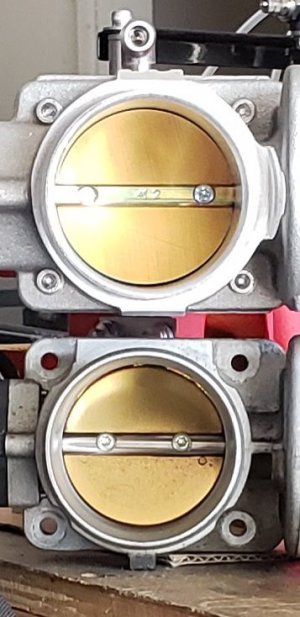

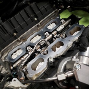

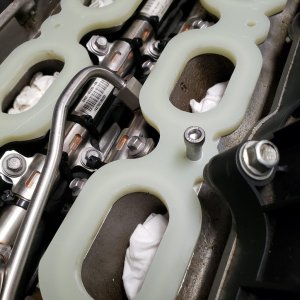

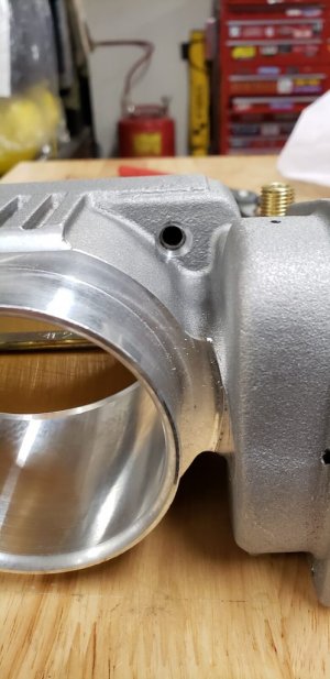

BBK 70mm Throttle Body Improvement
Original Post: https://shoforum.com/index.php?threads/my-30-minute-mod-for-the-evening-bbk-70mm-tb.141389/

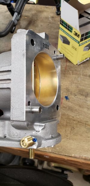

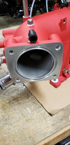

So @FiveLeeter918 at Ortiz Performance hooked me up on a VERY quickly shipped BBK 70mm throttle body (yes, it IS from 1 2005-2010 V6 Mustang). Been thinking bout this mod but was never 100% sure it fit until I came here. Anyway, got it and test fit it to the IM I have sitting on the bench.
Although it is an awesome piece, there were two small details my OCD had issues with. 1) I'll be porting the IM just that small bit to get it to match the TB, but have some concerns about how close it comes to the ring-style gasket groove if I do that and 2) the bolt holes where a bit larger than the hardware and just fit very sloppy. If you ever wanted it dead-nuts centered, you'd kinda have to eyeball it and tighten it down. Well, I figured I'd address issue #2.

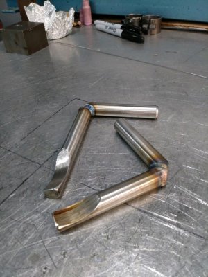

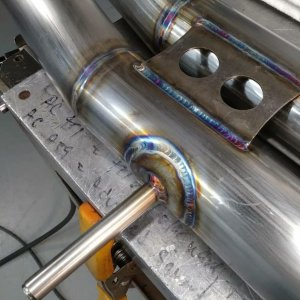

I had some 5/16" OD 304 stainless tubing laying around and decided to see if there was any sort of "dowel" setup I could do. Lucky for me, the holes in the TB are EXACTLY 5/16". The OD of the tubing was soooooo snug (insert joke here). And the ID for the hardware sooooo perfect. So only problem was...the recessed holes in the IM weren't 5/16". Well, tubing was easy, measured what I needed and cut a few pieces on the lathe (you only need 2 to center). Unfortunately, the IM doesn't lend itself to be easily mounted on a table for a mill, so I had to do this one by hand...just took a 5/16" drill bit and sunk it in about 1/4"-3/8" deep.
Slapped the dowels in place, and fit is perfection. No movement whatsoever, centered exactly to the opening of the IM (which I will now port to match) and all this with some extra tubing laying around and a quick turn of the lathe and some careful drilling. Viola!
Ro1DGdmTeOBe4Iwidth1024height498cropmodenone
Z7msRXKZjoei Qwidth498height1024cropmodenone
PGN qICO28EXx width498height1024cropmodenone
Ho 0AsWvlSdPO0width498height1024cropmodenone
KB1nur3hw3Rsvmwidth498height1024cropmodenone
HoT64yJgbH3VWiwidth498height1024cropmodenone
BBK 70mm vs stock. Stock is 65mm, for those who were wondering.

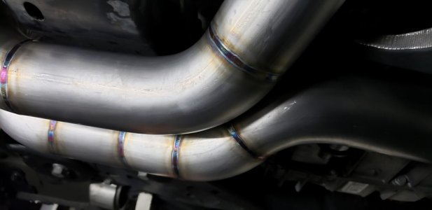

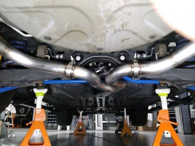

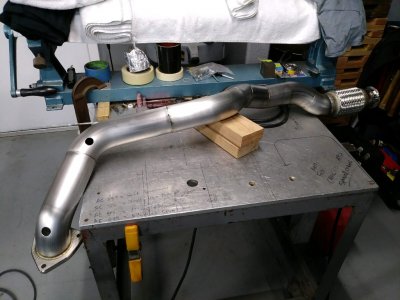

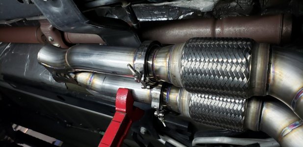

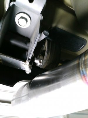

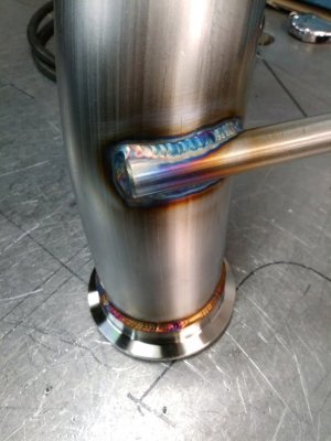

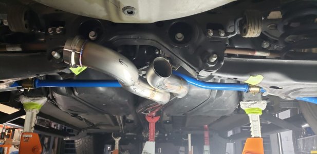

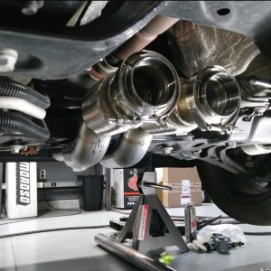

Custom Exhaust Completed Part 01
Original Post: https://shoforum.com/index.php?threads/finally-custom-exhaust-complete-nervous-to-debut.141485/

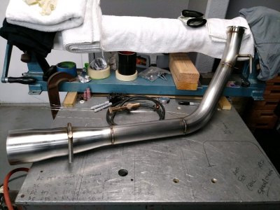

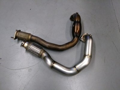

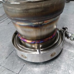

I pretty much went straight pipe all the way back. No cats, no mufflers, no resonators, only an x-pipe. Results are interesting and I'll be running it through its paces to see how it does, power-wise. I am finally able to get away from the last bit of LMS parts I had on this car (full turboback system), or should I say re-branded Corsa system, LOL.
A guy named Alex Gutierrez who has a shop named Big Head Motorsports. Super talented welder. Only online presence he has is IG, check him out at Big Head Cars. He does a lot of high end drag race stuff. And his shop is 3 minutes from my house...that was sweet! I'm going to tag him to do a lot of my future work, i.e., turbo manifolds, IC end tanks (since no one makes any IC for my platform), and maybe something trick with the intake system.

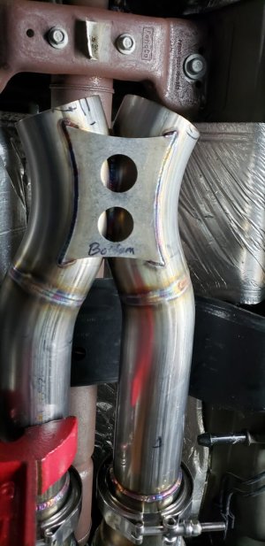

It's 3" all the way to a set of 3" bellows, then transitions to 2.5". There's an x-pipe right after the bellows and then out to the back and ends up with a 4" tip. Used 321 stainless on the test pipes as it retains heat better than 304 stainless, thus making the need for ceramic coating unnecessary. The system is 304SS for everything past the bellows.
But make no mistake, this thing is pretty loud. However, drone is non-existent at cruising speeds, it isn't raspy at all and has a good bass and tone to it. It's just LOUD when you step on it, lol. Which I don't mind so much.
Anyway, the quality of workmanship is out of this world. It's built for performance and maintenance will be easy with all the v-band clamps used instead of slip-fits and ****** joints.
RqpPjKTZX2D CGwidth768height1024cropmodenone
ELM4uBo6O5w uwidth1024height1024cropmodenone
F6mae0daAq 8owidth1024height1024cropmodenone
PpY0Ry97XglGG8width1024height576cropmodenone
CZl6vZIraABmF1width768height1024cropmodenone
Gngo RJ7WayqeAwidth1024height768cropmodenone
KyQuF5eSO7qHvxwidth498height1024cropmodenone
7Pj7wKBTh64Ta5width1024height498cropmodenone
QIoKxP qFFSp9iwidth1024height498cropmodenone
Q9hlERMcKKghWTwidth498height1024cropmodenone
Nmkpu5GbtXCPYSwidth1024height498cropmodenone
Gmv3X3iaF64Jj4width768height1024cropmodenone
SKEfTFCQAyID1ewidth1024height768cropmodenone
NonpDEGCJuQ7YMwidth1024height498cropmodenone
J0EjiQ7enRyE8wwidth1024height498cropmodenone
CgTg3OIRkC2jSTwidth768height1024cropmodenone
BFzakGwWl7TQKdwidth768height1024cropmodenone
AZCmFCbnXJSMnywidth1024height768cropmodenone
PFgFBRaxr dP1owidth768height1024cropmodenone
BnwKqKBZo9p710width1024height768cropmodenone

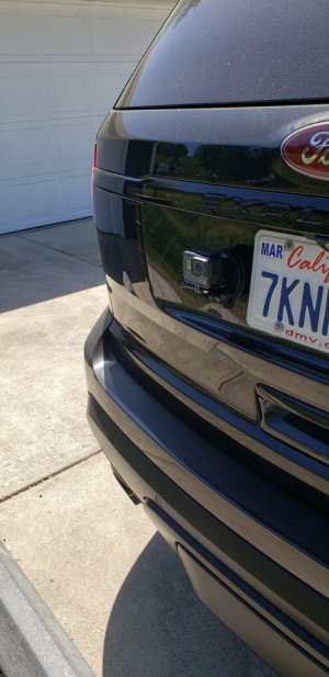

I used a GoPro Hero6 Black utilizing the on-board microphone and mounted to the vehicle here:
H8 oPRP5b2orX9width498height1024cropmodenone
For the telemetry, I used the Torque Pro app and used a screen recording app on a small tablet. Editing of the videos was done only to get sound from the GoPro to sync with the video of the tablet.

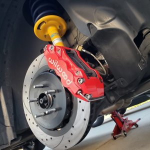

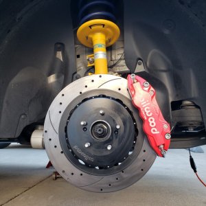

Bilstein B6 Shocks And Struts Installation
So, at the time of this write-up, the highest performance shocks/struts available for the Explorer platform are the Bilstein B6 model line. It is a step up from the Bilstein B4, which is their OEM replacement line.
I finally got them installed after a nearly 6 month wait for one last front strut. Seems there was a shortage nationwide as deliveries from Germany had been delayed, likely due to the early COVID restrictions. I had ordered them through Summit mid-December of 2019 and got the last strut (PN: 22-266620) beginning of June 2020, but seems that everyone was out at the time.
Anyway, it's a pretty straight forward installation so didn't get too many photos. I started with the rears.
Removed top bolt of rear strut assembly. Just have to pop of the plastic pieces on the top of the rear wheel "****" of the interior. And this will be exposed:
CkNus16  xGfHWwidth498height1024cropmodenone
Used these tools to remove it:
FrO9L6ScA6Pksywidth1024height498cropmodenone
Then remove the bottom bolt from the knuckle:
JOeDZE5QOdfS7mwidth498height1024cropmodenone
Purchased all new rubber pieces from Ford so that everything going in would be brand new:
QfQfS tUS8R93Uwidth1024height498cropmodenone
G3O2ISen Xw2nMwidth1024height498cropmodenone
Used the Bilstein bump stops that came with the shocks:
DinWQab2r5AgvVwidth498height1024cropmodenone
HkGjW b9rdOi9vwidth1024height498cropmodenone

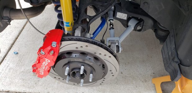

Installation is just reverse of removal. Finished install:
SqD4 b ql UU2Owidth1024height498cropmodenone
Fronts were pretty simple. I have a spring compressor that that helps. I purchased brand new hats from Ford for the fronts as well as the rubber spring seat. Just wanted everything to go in new.
Finished install:
GqEOkYwH8qmFVwidth1024height1024cropmodenone
YA1D0VmcYVVoewidth1024height1024cropmodenone

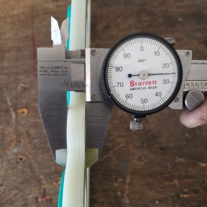

So how much do they weigh? Well turns out, despite them being a larger wheel than the TE-37, they are actually 2 lbs lighter! Winning!
W86i8PdkQXHnMewidth498height1024cropmodenone
AyzbE5SCgLClNSwidth498height1024cropmodenone
FYI, that block of wood weighed 6.5lbs, so I'm subtracting that to get the final weight. Had to use it to get the wheel to sit on my mailing scale, LOL.
Now...for tires. I'm pretty bummed about this part. I went with some Hankook Ventus ST tires again as they are the only ones that had a size I thought would work: 295/45-20. Not to many tire companies make that size, and TBH, it isn't ideal. The tire diameter is now 30.5" vs stock 30.0". The 275/45-20 I had before gave me a 29.7" diameter. The objective for me was to stick as close as I can to stock OD, but if I had to change, going slightly under would be preferred as it is an effective way to change gear ratio slightly. I've now gone in the other direction. And to make matters worse...
The weight I saved on the wheel was eclipsed by the now-heavier tire...38lbs:
SJIKBv2Mi BCRnwidth498height1024cropmodenone
I gained ~3lbs by switching to the new wheel/tire combo! Not winning!:

So, mounted, balanced and riding around, the car is fine, no rubbing at all. I added the tirestickers again and I actually like the "stance" way better:
4u47D9IKqbj pcwidth1024height498cropmodenone
Cyx5fim0TQyRWpwidth1024height498cropmodenone
VNILzBQ9nnJRrMwidth1024height498cropmodenone
There is visibly less wheel well gap and ride height. Who would think 1/2" taller tire could look so different. I will say, I get WAY more looks and snapped-necks with these wheels than I ever did with the TE-37s.
I'm just not 100% happy with the tires (weight). So, I'm still searching for a better one. My dream tires would be a set of Nitto NT05R, but they don't make a size I can use (or WANT to use, is a better way of putting it). To open up my options, I've recently been entertaining the idea of going with some 305/40-20s that will bring me closer to a diameter I had with the TE-37s, but I'm curious if I'm playing with fire as far as rubbing issues. I've seen that the ContiSportContact 5P tires come in that size, are grippier than the Hankooks and, from what I've seen online, weigh 35lbs. That would put me right back at the ~58lbs I had with the Volks and bring my OD down closer to OEM as they are a hair shorter than the 295/45-20s...
I'm also liking what I'm reading about the Pirelli P Zero (Porsche Edition).
...but I really, really want drag radials...LOL. 305/35-20s are just too small and nobody makes a taller drag radial. Anyway, the car is ever evolving...

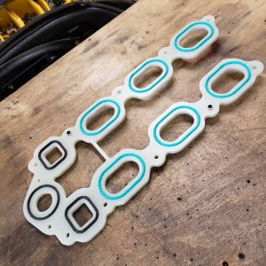

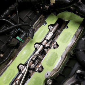

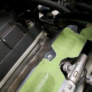

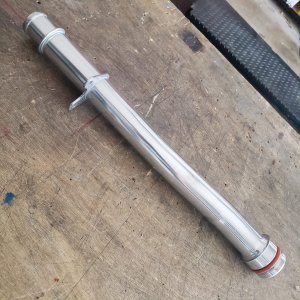

Intake Manifold Coolant Pipe Insulation
So about a year ago I went to the drag strip and was racing my Explorer. There was another guy there with one who was also racing his. We obviously started talking and I noticed he was always spraying down underneath the intake manifold with ice water after and before a run. This was when I was still a noob, LOL. He told me there is a coolant pipe that the intake manifold straddles and just bakes that manifold in heat. I was surprised and intrigued and decided to do something a little better about it.
I went to Tasca Parts and bought a new pipe to keep downtime to a minimum as I already had purchased a new intake manifold for my direct port meth kit I was going to install. So when I got the pipe in, first thing I did was send it off to Jet Hot Coatings to get a ceramic coating treatment:
V 38iS6OgPMJDwidth1024height1024cropmodenone
I was advised by Jet Hot that their classic polish would accomplish what I'm after better than any of their other offerings based on what it was being used for.
Well, I thought I had done the pinnacle in heat management, but boy was I wrong. After seeing a post by @mrhighcaliber, I was impressed by the steps he took to mitigate the heat from this hot coolant pipe. So much so, that I had to copy him, so all credit goes to him for this one.
Got some 1" rubber pipe insulation from Home Depot.
You have to get the rubber, not the foam, it won't hold up to the heat. Well one step further it was wrapped in some metal heat tape. I had some of that fancy gold stuff from DEI laying around so I decided to use that for me:
FRMS47WqH0oZYwidth1024height1024cropmodenone
So, FYI, there is a technique to wrapping pipe with heat tape. You can't just do it continuoulsy. I made that mistake and it looked like shit. The secret is cutting it into strips. I watched this video and it all made sense to me. And looks great. Tedious but worth it...
FT3N8ShV o Jbwidth1024height1024cropmodenone
Installed onto the manifold:
DguyqpfUVZVdpwidth1024height1024cropmodenone
And finally on the engine!
FTkki903FdEnRwidth1024height1024cropmodenone
I did no real datalogging before this and I've done so many other mods at thee same time I did this, there's no real way for me to say how well, if at all, it's gonna work. But logic says it will at least do something, LOL. And that's enough for me. Plus it looks kinda cool.

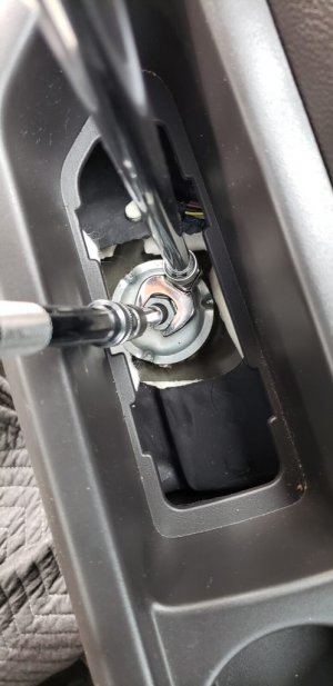

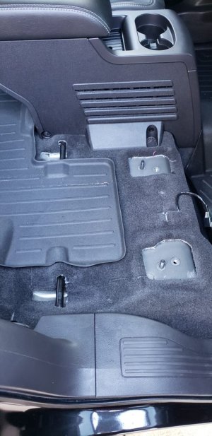

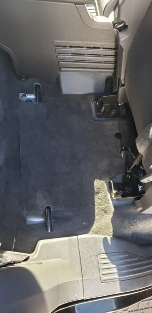

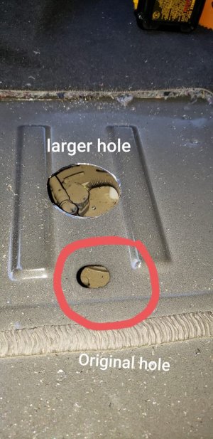

In-Cabin LPFP Access For DW300c Part 01

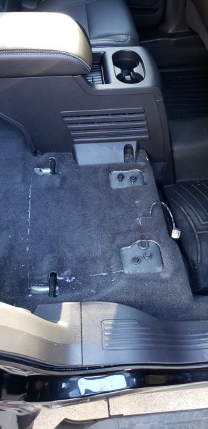

So I was really dreading installing the fuel hanger that had installed the DW300c into.
Reason being...I was dreading dropping the fuel tank as we don't have top access from within the vehicle. This would mean taking the driveshaft down, removing the exhaust, removing the filler neck, all kinds of lines, etc. As some of you know, I hang out on here a lot and posed the question to see what you guys had to do for any pointers before I tackle the task. You all proceeded to tell me you have in-car access from a plastic cover under the rear seat...ugh...I got jealous, LOL.
Anyway, I decided to say "&^%$ it!" and see what can be done from the top. I took the seat out, cut back the carpet and found a small hole with a rubber grommet near where the fuel hanger would be. I used my boroscope to see what was under it and see what was in the way. Well, nothing was! So I made an larger exploratory 2.5" hole that I could easily cap off with a rubber plug I had laying around if I had to abort.
HwdgK3ZQftIvh0width498height1024cropmodenone
S L3D JPAX0KDLwidth498height1024cropmodenone
PfyNRUbSc45i3twidth498height1024cropmodenone
So after closer inspection, I noticed there was parts of the body that are required for the actual structure, but there looked to be a small window I could make to access the fuel hanger without effecting any of the structural integrity. It would be an odd shape, but it was a flat area that I could easily make a cover plate for when I was done. Sooooo, I decided to just commit...full send baby!!!
 NFSyLdzk49pnSwidth587height1024cropmodenone

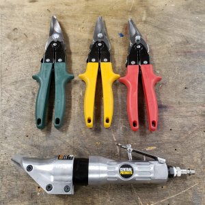

Here's the cutting tools you should try to use. I would NOT use a cut off wheel as it creates sparks and I am not sure how the fuel vapors are in that vicinity:
L2wqnkZHsDec9width1024height1024cropmodenone
Initial rough cut:
Qrw Ex s3yiJtnwidth498height1024cropmodenone
Edges sanded and deburred, old hanger cleaned:
Z6zt53GoC7lBpPwidth498height1024cropmodenone
Carpet cleaned and trimmed:
LPqGU4i g27n3Mwidth498height1024cropmodenone
WeatherTech mat covering hole, to see how obvious it might when I would get finished:
EXqsPRJ0KQA2wWwidth498height1024cropmodenone

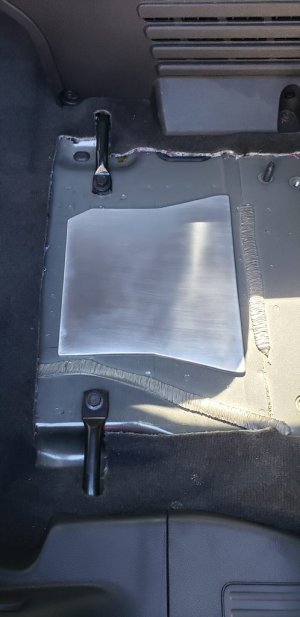

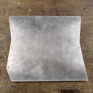

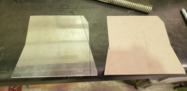

Well, Now I just would have to make a cover plate, which will have integrated gussets for added rigidity and a rubber gasket to seal it up. I'll drill and install some rivet nuts and this thing should be super easy to access in the future should I need to!
So latest update: I installed the new fuel hanger from this access hatch. OMG, it was awesome how easy it was to get to. Didn't take a pic of the finished install as it looks exactly like the OEM hanger, LOL. Oh and I used a new hanger o-ring too!

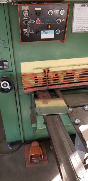

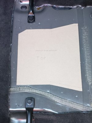

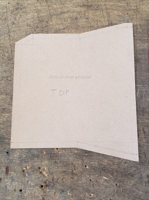

Cardboard template of the cover I will cut on the shears I have at work:
2ZsYmBWtsW94Wfwidth768height1024cropmodenone
MK6tY7SbJlzNqGwidth768height1024cropmodenone
ErsacEbEgLshT5width768height1024cropmodenone

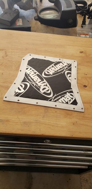

Cut the new plate from 8Ga aluminum plate...pretty thick stuff, won't be putting the indents in as this is way thicker than the sheet metal body.
DOePTrKLXjpd4Wwidth498height1024cropmodenone
DCxCK9Xl1 ymNywidth498height1024cropmodenone
Comparison of aluminum plate to template:
EfNKPbfWVMywMnwidth1024height498cropmodenone
Rough sanded and filed edges:
UnPjgYHnO0YhnDwidth498height1024cropmodenone

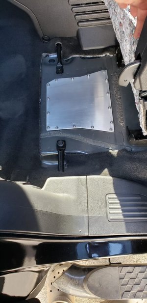

Fine sanded and polished edges with finished top/bottom:
HNbj5a0hXJAg62width498height1024cropmodenone
Mocked into vehicle:
5LFcM8J8utE7vhwidth498height1024cropmodenone

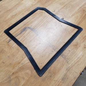

Gasket cut/sized: Just need to identify where to place the hardware holes...
ZY PoDI9BkW2Ywidth1023height1024cropmodenone

TbeMNPzoTQnQtwidth1024height1024cropmodenone
Transferred hole locations to gasket:
FqAXz4V3iAe6gwidth1024height1024cropmodenone
Holes punched into gasket (yes to the Crocs!):
Xalg6KQO91fB0cwidth498height1024cropmodenone
Rivet nutt holes drilled in body:
Admd6A9yx7fgvvwidth498height1024cropmodenone
Rivet nuts installed:
1TDhdmCV2byQGewidth498height1024cropmodenone
Had some DynaMat laying around..helps a bit with sound deadening
51HrkBY7D1KEqfwidth498height1024cropmodenone
Panel installed:
LFB5tWLCntmTx3width498height1024cropmodenone
Hardware used:
SnZ5U9tq4JcLhywidth498height1024cropmodenone
Seat installed:
Pm9T37Kohj meRwidth498height1024cropmodenone
Easy access when needed!!:
SaC0XZGAVVtd44width498height1024cropmodenone

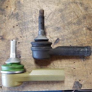

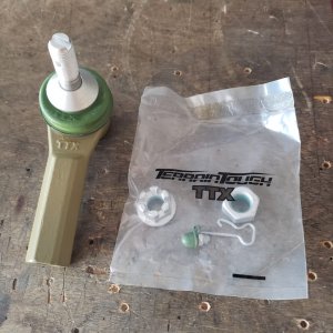

MevoTech Front Tie Rod Install
Original Post: https://shoforum.com/index.php?threads/mevotech-tie-rods.141666/
So, if you're anything like me, you sometimes enjoy putting upgraded parts (whether go-fast or OEM improvements) on your vehicle "just cuz" (and I guess if finances allow for it). Here may be one of those parts. Mevotech TTX line of parts, specifically the outer tie rod. The TTX (Terrain Tough) line is supposed to be their super tough, best engineered line of parts, as they do offer a standard OEM replacement level as well.
I saw these being newly introduced for the XSport from the Explorer forums and, even though nothing is currently wrong with the OEM ones I have now, I am in the middle of some suspension upgrades and figured, if I'm ever gonna do it, now would be the time. Got me thinking about my SHO brothers and how it would fit. Turns out the parts are different between the 2 platforms, but...they do carry an SHO version...
Anyway, just figured I'd share this with you guys if you don't know and may be interested in them. Not sure what your opinion is of the brand, but they seem worth taking a look at. They appear pretty well built (although the package does say Made in China) and I do like how they are serviceable. Rock Auto had em the cheapest for the XSport at right under $32 each, but looks like the SHO version is more like $47 a piece.
N12x2AZp787cqwidth1024height1024cropmodenone
MevoTech
Rock Auto
Top View Comparison:
49VqH7c4UdCso4Ywidth941height941cropmodenone
Side View Comparison:
CNHcpsCwVfBsNwidth1024height1024cropmodenone
Before Installation:
YUovyxDtb0eq4width1024height1024cropmodenone
Removing the tie rod wasn't too hard in my case, but I know in some environments or if it's very old, they can get pretty stuck. I just hit the top of the threaded stud down with a small-handled 4-pound sledge and it came right out of the knuckle.
After Installation:
08apoTijz7OOdwidth1024height1024cropmodenone
Now...for an alignment!

RDU Maintenance And Plug Install
Original Post: https://shoforum.com/index.php?threads/did-some-rdu-maintenance-today.141690/
Drilled drain plug and filled unit with some Amsoil 80W90 Severe Gear oil:
Yzg80EyG2WNq2width1024height1024cropmodenone
Service manual calls for 1.22 qts (39 ozs), so had to use a little from a second one. But had to get rid of this silly hanger first:
TOcssnaBCFWR4width1024height1024cropmodenone
5E8yErs7cqqyPwidth1024height1024cropmodenone
Smooth the location of the plug:
Vw pcFnOGrZNMwidth1024height1024cropmodenone
Drilled (technically drill size "R", but closest fractional size is 21/64") then tapped for 1/8-27 NPT:
EGLxs 10wJAQiwidth1024height1024cropmodenone
I was gonna go with the magnetic NPT drain plug, but I don't like the idea of constantly breaking the seal of an NPT fitting doing maintenance. Decided on an NPT to Flare fitting adapter:
JbELcQrAczlqHwidth1024height1024cropmodenone
Now I'll never have to break that NPT seal. Just undo the cap:
HN7ALjv3VX4y8width1024height1024cropmodenone
Cap is on tight with an o-ring seal, but just in case, for double protection, here is some adhesive heat shrink to keep it from spinning off over time (that would be catastrophic). It's easy enough to cut with a razor and peel off when time to do the service:
Pj2Y ztHkC6mVMwidth1024height498cropmodenone

PTU Vent Extension Mod And Engine Oil Change
Original Post: https://shoforum.com/index.php?threads/ptu-and-engine-oil-change.141727/
Got the engine as well as the PTU oil done.
Engine Oil: Pretty straight forward, just showing you guys the switch I made from el cheapo middle of the road Pennzoil stuff to some better Amsoil fluid and filter...
Bw6Wa  EaoMvwwidth1024height1024cropmodenone
GtFYseXFJ83Rewidth1024height1024cropmodenone
Oil filter is about 33% larger than that cheap service station filter I had on there...btw, I WILL be changing that filter sooner than 25,000 miles, lol.

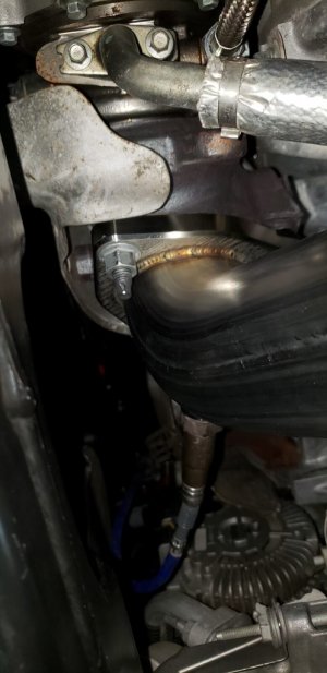

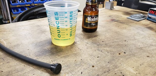

Onto the PTU. I am still experimenting with beefing up the PTU I have on my bench, but in the meantime, I am still running my original one and decided to do the drain plug and vent tube extension mod.
This PTU fluid is coming from somewhere. Top of the vent tube and vent tube hose was clean, so wondering if it is leaking from somewhere else.
DuADzWEwfrJB6jwidth1024height498cropmodenone
I like the idea of having the drain on the lowest point to get all of it out, so I bypassed the existing drain port and just added the bottom one. I was only able to drain out 12 ounces...so 6 ounces disappeared somewhere. When I drilled the hole for the bottom drain, I stuck a paperclip in there (bent like and "L") and spun it around to see if any grease or sludge would be on it as maybe those 6 ounces converted to "grease", but, to my surprise, came out clean. IDK...weird. I never had an oily spot on my driveway.
Drain plug installed...matched my RDU drain plug. Also put heatshrink around it to keep the cap from ever spinning off.
CCq2BHQKlZ5jsNwidth498height1024cropmodenone
Love the v-bands...so easy, LOL:
UOTmO0JYu3j iwidth1024height1024cropmodenone

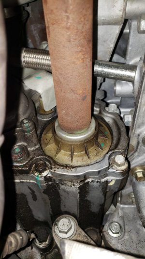

With removal of the front downpipe, I could very easily get to the top vent. By feel of course, but very easy to reach. Added the hose and was able to get this clamp on tight:
MqLU jaKMKBJnpwidth498height1024cropmodenone
Used this tool to tighten it blind. Was pretty easy actually:
JCLoChdOZTWlkowidth1024height498cropmodenone
Bottom end buttoned up:
QmPyo4G8sbgK5width1024height1024cropmodenone
Removal of the vent cap and placed this barbed fitting for filling only:
V6kIdoNxai9g7dwidth1024height498cropmodenone
For the PTU, I went with some Amsoil 75W140 Severe Gear ****. Since I only needed 18 ounces, and there's 32 in the quart pack, I poured out 14 ounces and storing it in another bottle for later:
NE5JUKu7dbLSs width1024height498cropmodenone
IV bag-style fill job:
Fti0JsY0an2JxGwidth1024height498cropmodenone
8w3jMYld6NLOZuwidth1024height498cropmodenone
1ovAkqvbLqdhLOwidth1024height498cropmodenone
Hole was punctured in bottom of pouch. Even so, it really did take quite awhile. I let it hang there in the hot sun so it got very viscous, I'm sure, but still took a few hours to drain. On the new PTU, I will be adding a second fill line next to the vent port. This will keep from fighting the air coming up.
Installed vent cap, zip tied it off to the side and all done!

X35Design Phenolic Spacer Improvement
Original Post: https://shoforum.com/index.php?threads/got-my-x35-phenolic-spacer.141761/

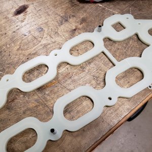

Looks like a great product and look forward to getting it installed to see if it can mitigate IM heat soak issues further. At the time of this write-up, he didn't have it listed on his website (X35Design) but emailing Steve over there will get you the info you need.
When I mocked it up and placed the hardware in the holes so I can see if I would need to do any port matching, I found it suffered from the same issue as the BBK throttle body. Not the fault of the spacer, but more the fault of the IM. The bolts holes are just too large for the hardware and allow for a lot of play. This would make any attempt at port matching it futile as it would be difficult to place properly when installing it. So...just as with the BBK, I used the same logic here. And it worked perfect...
Spacer with gaskets installed:
DyaRCT09uzarLwidth1024height1024cropmodenone
Thickness of spacer for those curious:
CtoVtEYf3Qv0awidth1024height1024cropmodenone
Dowels created for improvement:
5/16" OD, 0.035" wall thickness, 304 stainless tubing, cut to about 0.8" length (can't be any longer than 0.9")
JAeK 1K9WclV2width1024height1024cropmodenone
Picked any 2 holes far apart from each other and drilled with 5/16" drill bit:
0VMELpyqOdqa6width1024height1024cropmodenone
Drilled matching holes in spacer, same 5/16" drill bit:
DTlRstyZ8n48Swidth1024height1024cropmodenone
Dowels installed into spacer:
6R1aZZ7Cr9frDwidth1024height1024cropmodenone
Perfect tight fit onto IM:
KW3uuAliZOsL1width1024height1024cropmodenone
Will need minimal port matching, mostly just a little of the spacer needs to be matched to the ports, but Steve did a great job of getting it super close.
There ya go. I can probably drill the bolt hole very slightly using the same 5/16" drill bit for the match holes in the heads and push those dowels through the spacer slightly. That would get this setup 100% dead-nuts tight and centered from head to spacer to IM...
Here is a video showing the port matching done on the IM side of the spacer:
On the head side, another 5/16 hole only slightly drilled to accept the alignment dowels:
YWvR3PSs5zNq width1024height1024cropmodenone
Both holes drilled (hey, easy now...this is a family oriented forum!):
WNx8Ug3rphVoJwidth1024height1024cropmodenone
This is all you need it pushed through on the head side to get it to line up:
Qv4XU7WVjp1f6width1024height1024cropmodenone
Rags stuffed into runners to minimize getting the dust into them while doing the port matching:
Fun4US S4K2vuwidth1024height1024cropmodenone
Used the dowels and the hardware to keep it secured down while porting:
B9rPXb9k2uIrVwidth1024height1024cropmodenone
Video on doing the porting on the head side of the spacer...
All done and ready to mount:
EfFGxd20K4dpswidth1024height1024cropmodenone
