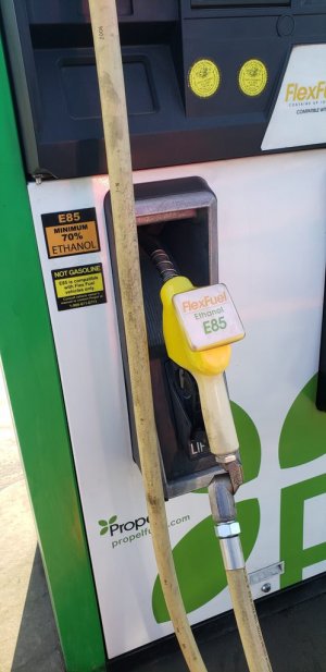

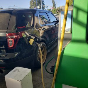

So after contemplating when I really wanted to make the switch over to ethanol and also getting some inspiration from Brad over at AJPTurbo, I decided to finally make that switch. I still have a few things I'm working on to get even more fuel to the engine, but I think it's time to get started down that path. Many thanks to @p_coatsofboise, the current 1/4-mile world record holder of this gen Explorer, for continuing to motivate me to push this platform further.
So after getting a starter tune for e85 from Brad, I went to one of our local Shell stations that has some Propel e85 to fuel up a gas can worth (note the sticker that says "MINIMUM 70% ETHANOL"...it will be important shortly):
BCbG DzK7rLBwuwidth498height1024cropmodenone

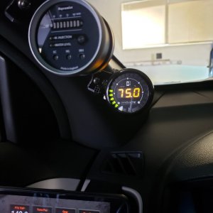

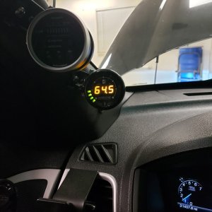

After getting back to the house, draining the remaining 100 octane I had left in the tank (it will be put to good use in the motorcycle), I filled up with the 5 gallons of e85, loaded the tune and started her up.
All is well as I saw the ethanol content gauge slowly climb from 7% that was in the 100 octane. After about 30 minutes of idling and driving slowly around the neighborhood to get that fuel through the system, the highest I saw my meter was this:
6egmh3sIcnX3gwidth1024height1024cropmodenone

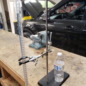

I thought to myself, this meter has to be wrong! I know there is a range that pump e85 is truly at, but at least I was expecting a little over the minimum 70% as it was stated. Well, I decided to test the fuel to verify independent of the gauge:
PWWwaPpAhdA Vwidth1024height1024cropmodenone
...and to my dismay, after doing the calculations like 20 times to verify the results, the ethanol content came to measured 66%, not too far off the gauge, so I knew that thing was correct.
That means the station has some poor quality e85. Not sure how to take this as it doesn't even meet the State-mandated minimum. And not sure where to go from here. I can drive around town to find a better station, which is what I will likely do. Or I can go full-on Simple Jack and just get a hold of some Ignite fuel as it's accessible where I am and would deliver more consistency...but not sure how I really feel about doing this just yet. I think I will do some searching for some better quality pump e85 around town first.
I went ahead and did some hard pulls just to see how it feels (the starting tune is dialed back so we can ease into the power), and it feels quite a bit different. I'm interested to see where this road takes me...
...and so the adventure continues...
TEST YOUR FUEL PEOPLE!!!
Good resource if you want to do this at home or if you don't have one of those pocket testers:
http://iqlearningsystems.com/ethanol/downloads/E85test.pdf
I personally like knowing the science behind the calculations, so I prefer this over one of those $15 Amazon test kits...but those work too, I'm sure...

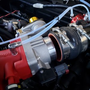

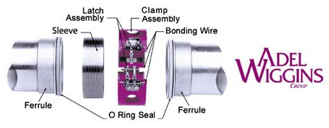

Yup...going wiggins clamps myself...they allow for some flex that v-bands don't allow. Since that pipe is pretty short to the IC, probably need a bit play so when the engine moves, it doesn't crack the pipe.
Adelwiggins
Tumblr n255j8hQpM1qk65n6o5 1280
Wonder if we can get any of these throttle body adapters to work with the BBK 70mm TB:
https://plazmaman.com/product-category/plazmaclamps/
Would make it easy to use a wiggins connector without have to weld onto the TB...

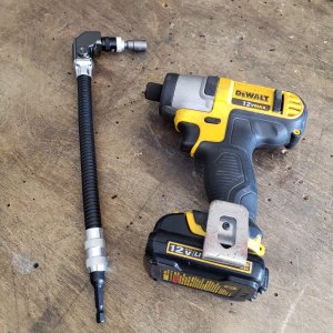

I won't re-hash what I found in this video except give you a parts list and some tips I found to make it easier, but I will say this video saved me A TON of time and work. Thank you so much to the creator!

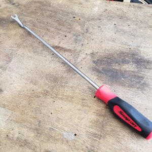

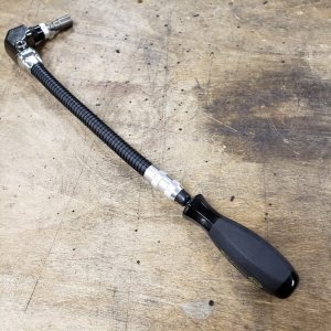

This is one of those jobs where having the right tools will make or break your sanity. As with all things mechanical, there is more than one way to skin the cat, but man, if you have the tools below, you will thank me later.
Anyway, some of the parts and tools needed for this job:
  • Actuator: Ford PN AA5Z-19E616-A
  • DeWalt Right Angle Attachment, Flex Shaft, 12-Inch (DWARAFS)
  • Magnetic Nut Driver Socket Set
  • 1/4" Cordless Impact Wrench
  • Long-reach upholstery removal tool

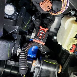

As for removing that red tab on the connector, it DOES NOT need to come all the way out as mentioned in the video, just pull it back a bit and it'll click out into place. Then remove it as you would any connector by depressing the lock tab:
EF0zSacUKQciZwidth1024height1024cropmodenone

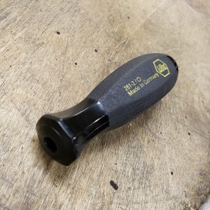

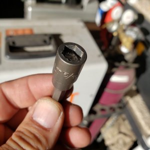

You want to use those nut driver sockets because they are slightly shorter than a socket adapter and socket. There isn't much room and you need all the space you can. It's great to have the magnetic ones as the screws just stick to it and you don't need tape or gum like the video posted suggested:

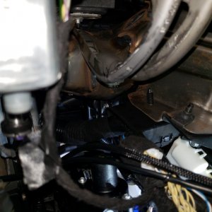

This pic is difficult to see what I'm talking about, but if you have everything removed as required, from underneath, look up toward the actuator and it's a straight shot with the flex 90. In this pic it's about center in the photo:

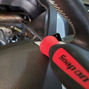

Now, with everything removed, it'll still be kind of stuck in there. There is hardly NO room to get that thing out as there is a large wire harness right up against it. That's where the long-reach upholstery removal tool came in handy:
II1FQtWFjCELAwidth1024height1024cropmodenone
I wedged it between and basically twisted the tool 90 degrees and it popped right out and fell straight to the floorboard:

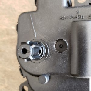

In this pic, you see the end of the tool and the white slot the actuator inserts into. The actuator had already popped off in this photo, but you can get an idea of where to insert it:
Lt7bucm1F7gghwidth1024height1024cropmodenone

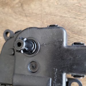

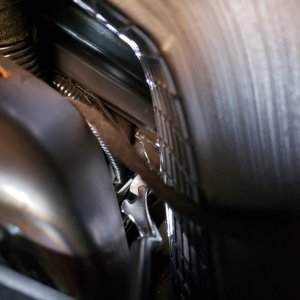

Here's the bad actuator and the arrows are not matching up:
5Ppu1k3YRHNK6width1024height1024cropmodenone
Here's the new one with the arrows lined up:
Vkvu938vR6c Iwidth1024height1024cropmodenone

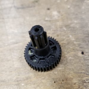

The video creator had a great idea taking the old one apart and using the plastic gear to get the slot to line up before inserting the new actuator. Just break the tabs off the outer shell it will come right out:
YVTapIrrhFTwXwidth1024height1024cropmodenone

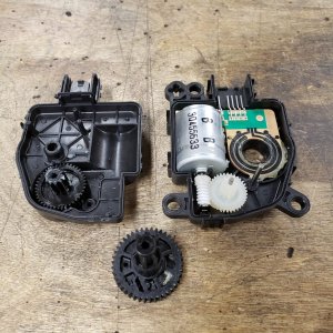

Some extra photos for you.
The opened actuator if you're interested:
WvJ4RXd3Bydg width1024height1024cropmodenone
The new actuator, I can't believe this $25 part costs so much to get changed. I think it's upward of $1000 because Ford will remove the dash:

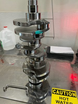

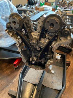

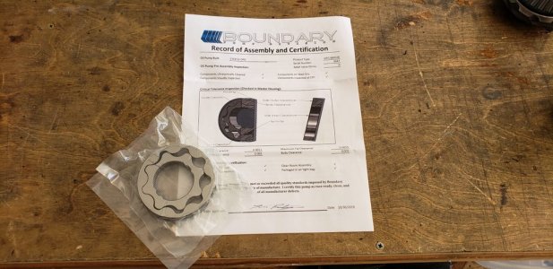

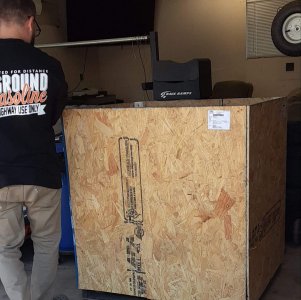

Built Long Block Part 01

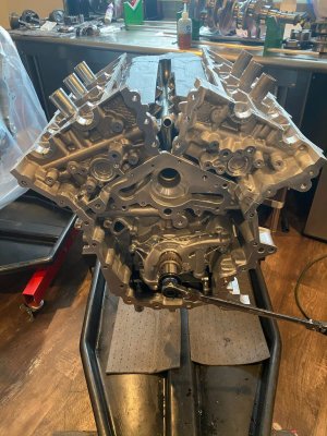

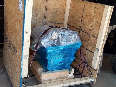

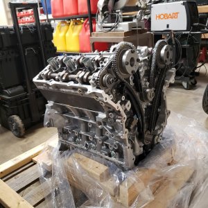

So this has been a long time in the making and I finally received it the other day. Although I have brought it up in passing and sometimes eluded to it, this project I've generally held close to the chest...for a number of reasons. Some of you may already know as I've shared this on other platforms so it isn't the biggest surprise, but it's for sure the biggest step for this journey I on right now.
Although I'm totally capable of building an engine myself, I decided to go with an outside builder for a number of reasons. The main one is time...it's just a premium for me and a project like this would've taken me quite a while. Likely even longer than the 6 months it took to get it to this point.
I started talking with Ryan over at RMB Motorworks about a year ago. Trust me, I've read all the stuff on the internet about some people's experiences, both good and bad. Most of what I got was pretty positive and I always take negative press with a grain of salt. Got to know him pretty well before I decided to pull the trigger on this and I'm glad I went with his him on this. Anyway, here's some photo's of the build process as it progressed:

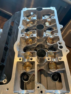

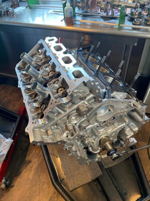

Heads off a 2016 SHO that had virtually no miles on it. As you can see, they were in great shape before they were even touched with any head work:
IYo9HqAx8T o Szwidth800height600cropmodenone

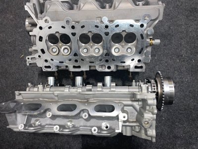

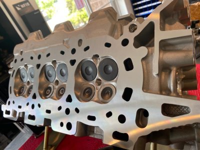

They were sent off to Headgames Motorworks to get some love. Namely their Pocket Port-R. What is that you ask? Well, here's a quick blurb on it:
Should be able to get a bit more timing out of this thing now:
QC3RV2X1atbLsvwidth1024height768cropmodenone
AGBarJWPQRT1XQwidth1024height768cropmodenone
IIcGAfpxEuJv awidth768height1024cropmodenone

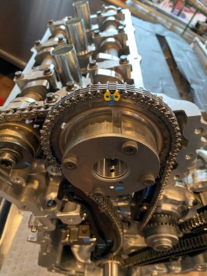

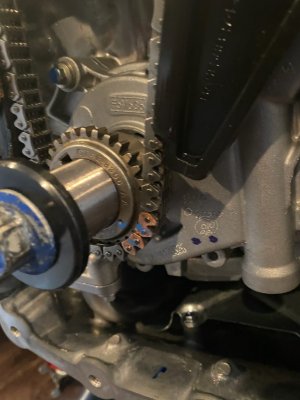

Stock cams. Didn't have anything done to them. A custom grind was outta my budget, lol:
QElCTpMgB17atNwidth768height1024cropmodenone

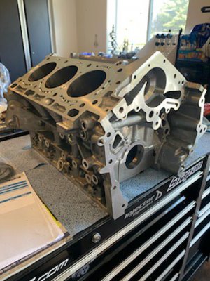

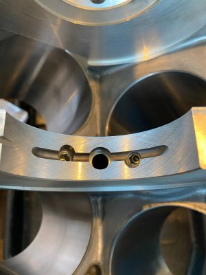

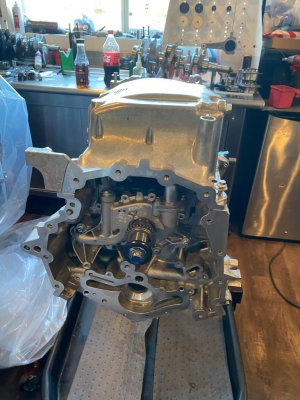

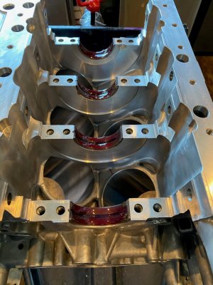

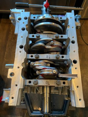

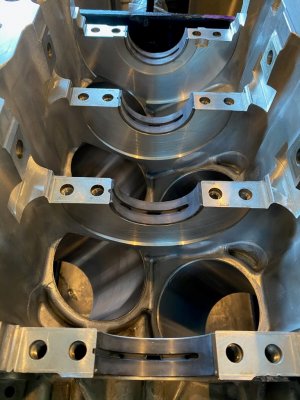

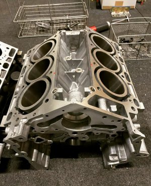

Brand new block, before it got sent out for the closed deck process:
Nhp JXKJe yByNwidth831height1024cropmodenone

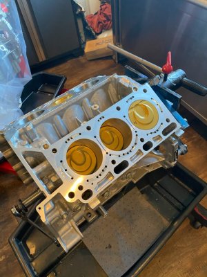

Back from CSS with the deck closed off:
QJFV1l0roFqodJnwidth360height480cropmodenone
517R3enQdwJ2SCkwidth360height480cropmodenone

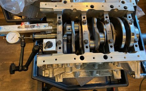

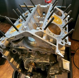

Just some nice hone work:
ML32YaOqnDD2h8vwidth600height800cropmodenone

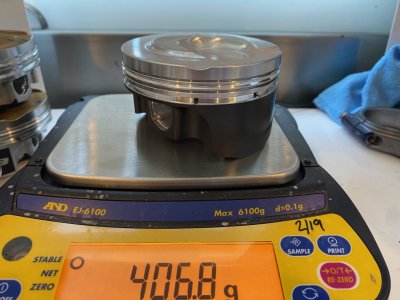

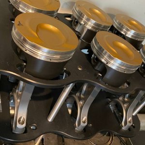

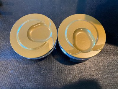

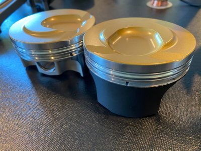

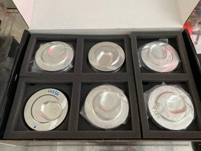

JE pistons before getting some Calico Coating love:
IP3Cd9TCafyhJ4width1024height768cropmodenone
Skirt coating:
893GAefvtY2xIWwidth1024height768cropmodenone
Thermal top coating:
H4l3j0BMUuxO Mwidth1024height768cropmodenone
UX0Arc1uBmF5OKwidth1024height768cropmodenone

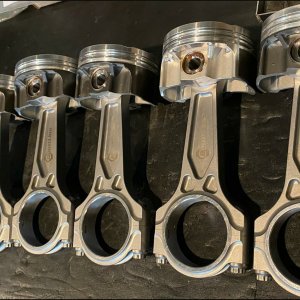

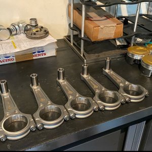

These conrods are sexy AF! A set of Boostline conrods to push those pistons around:

Some ring gap measuring:
Y2JNgBIdEUkJbS0width600height800cropmodenone
The centerpiece of all this...a Ford F-150 Raptor crankshaft:
7ttz1Rhptvw  mwidth768height1024cropmodenone
Main bearings:
UJ00CY tneyed2width768height1024cropmodenone
And some more lovely cross-hatch machining:
E5uF1qyAy7sy1lwidth768height1024cropmodenone

Built Long Block Part 02
The King main bearings installed:
YfEaHoj4T3U9dRwidth768height1024cropmodenone
Checking end play:
L7RoC 5RmTWBkowidth1024height641cropmodenone
And more clearance checking:
QzCJjZY9ADcccZwidth768height1024cropmodenone
Completed short block:
XMoTj0b yeGBP4width768height1024cropmodenone
Oil Pan, pickup tube and oil pump housing installed. Can't forget the WPC treated Boundary oil pump gear installed inside that housing:
A bzNXGke4Ss0xwidth768height1024cropmodenone
Q5xS5 HaiXoZVTwidth1024height498cropmodenone
And some relentless engine assembly ****:
PrsZTOD1fmkxKwidth1024height1023cropmodenone
ESE0gQEO1HBpOQwidth768height1024cropmodenone
WivkNZ UKTgk3Twidth768height1024cropmodenone
ZgBiDhRF53b08iwidth768height1024cropmodenone
FGdGYtcKxoZ7XUwidth768height1024cropmodenone
VNreSfq21 gFQjwidth768height1024cropmodenone
U5ztj8VckegEItwidth768height1024cropmodenone
TrE79bC ux33sTwidth768height1024cropmodenone
WLUwS03rAwio4Ywidth768height1024cropmodenone
ZXTnqzu8wKlhEYwidth768height1024cropmodenone
And finally, arrival day!:
DwEDZ5yGsriXHwidth1024height1023cropmodenone
KyMyx1Xm7BNRSfwidth1024height770cropmodenone
3 vahg4 tl00Vwidth1024height1024cropmodenone
So, next step will be an engine stand sometime this week. Then it will sit for a bit until I tackle the intercooler dilemma on the current engine. I want to work all the bugs out on the engine I have sitting in the car now, so I'll be mostly dialed in when the new motor goes in!
Stay tuned...

- Boostline Connecting Rods
- ARP2000 Connecting Rod Bolts
