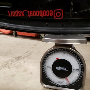

Be sure to weigh your hood as well since you just cut a nice size hole in it!
Hood weighs 19 lbs...the piece I removed weighs 1 lb....and the vent I added weighs....1 lb, lol....it's a wash...

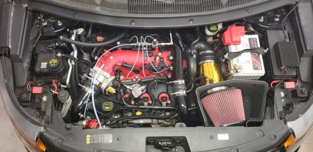

Something I’ve wanted to address was lowering engine bay and IA temps. Getting cooler air is a good place to start when tackling high IAT and IAT2 temps.
This was going to be done in 2 stages. 1st, remove built-up heat within the bay and 2nd, to feed the intake system with true outside air. Although I have the AirAid CAI system, you can see how that open filter within the bay ingests all the hot air.
UOxLRw5bufxHC9width1024height498cropmodenone
The OEM box with a K&N filter would likely function better as there is an inlet behind the grille and the box is sealed from the bay. However, I’m intent on retaining the AirAid filter, but will address this part of the issue later...stay tuned.

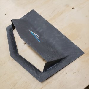

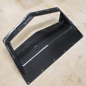

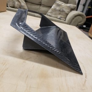

As I need some sort of high-pressure area then an immediate low-pressure one, I looked for what some call a "waterfall" vent. Raised lip in the front with a quick drop off right behind it. I believe this design will draw more air out than a traditional louver style vent commonly seen.
I was limited by the contours of the hood, so it was slim pickings. I wanted the GT500 hood vent, but those contours would not have allowed it. I found a place called Faircloth Composites that makes CF pieces for mostly the corvette market and saw he had 2 style waterfall vents, small & large. The small seemed like it would be a perfect fit.

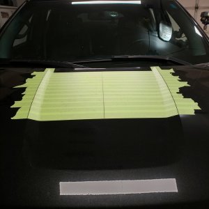

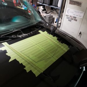

As I wanted to measure twice and cut only once, I started by figuring my available space. The underside and between the contours:
GJbwIER0gWLxHwidth1024height1024cropmodenone
IRflcQGXlx3z width1024height1024cropmodenone

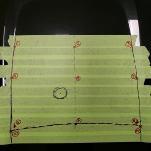

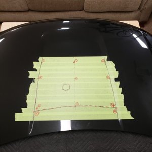

It would be close, and I figured I'd have to trim some of the sides. Once space was figured, I transcribed the template onto the hood:
8L42GWbvRvhODwidth1024height1024cropmodenone
Arts and crafts time!

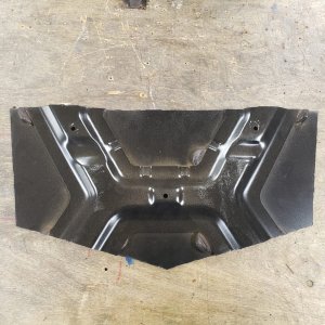

Then it was time to cut! It may not seem like it in the following vid, but it took me awhile to get the nerve to cut into a perfectly good hood. I cried, whimpered, said a few prayers and even second guessed myself...but then, just went for it!
Here's the piece I cut, did a pretty good job of centering this in the hood:

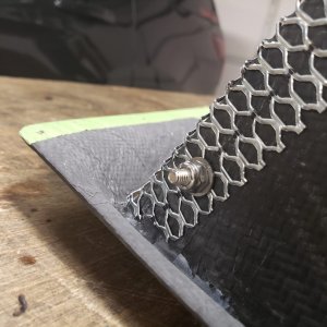

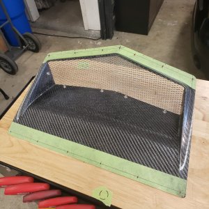

When cutting was done, it was time to get the vent ready for what it would take to secure it.
6Yo2 9imw7Ucewidth1024height1024cropmodenone
KxmFCJRb5uAYpwidth1024height1024cropmodenone

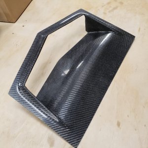

After getting it mocked up, I sent it to be clear-coated (they are sent raw CF and need to be UV protected):
58pv4UMBlkpLZwidth1024height1024cropmodenone
Credit goes to Absolute Collision out of Sacramento, CA for the outstanding clear coat job!

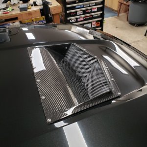

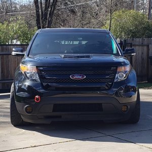

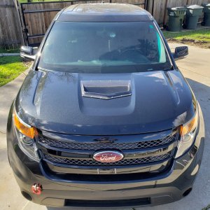

I’m pleased with it. Not the most appealing to look at but will definitely work. I took it out for a few hours to see how heat would build and, although I have no hard data, I can tell it is doing its job big time. After lots of driving, I would come home and prop the hood up and it would be very hot. But I opened the hood and it was barely warm. One piece to the puzzle that is heat management.
88K6PDxvn9of5width1024height1024cropmodenone
8pq7nAIgJjRjkwidth1024height1024cropmodenone
Granted, the real test will come in summer! Bring it on!
For those wondering what it did to the weight, the piece I took off weighed ~1.5lbs and the entire vent setup I installed also weighed ~1.5lbs...so it was a wash.
