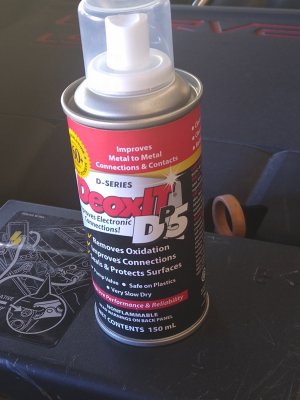

I remember this problem a while ago. I took DeoxIT and sprayed into the cavity where the door catch latches onto the part bolted to the body. The DeoxIT D5 worked like a charm, lubricating AND improving electrical contact and the problem went away. I swear by DeoxIT D5. Better than just plain old WD40. Turned out to be the rear passenger door latch was the problem.

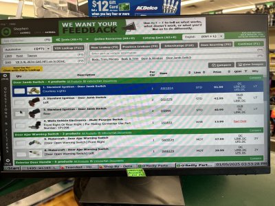

I guess I need to order these to try and fix the problem. I will find that out tomorrow so I can order these part(s).

Yeah, any contact cleaner to include Carb cleaners should be used first. Then followed up by your flavor of **** sprayed just inside that roller latch goes in the door. I do use the PTFE dry **** WD-40. Use a little on the hinges while you are in there and the door will almost hit you in the face it opens so well.
Do that for all 4 doors to prevent the problem. I've never seen one actually die. I think they just get stuck.

Don't do it man !
I'd rather change the whole door than mess with those damn switches.
Q and Game are spot on, you don't need the switches, they just get dirty/sticky.
Slobber the door latches inside the doors liberally - don't be shy - Any good spray penetrant that leaves a lubricating residue, (PB Blaster is another good one) and then open and slam each door 5 or 6 times and we promise, the dome light will go out now.
