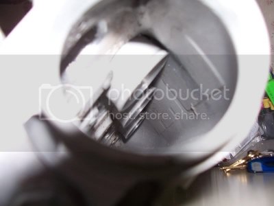

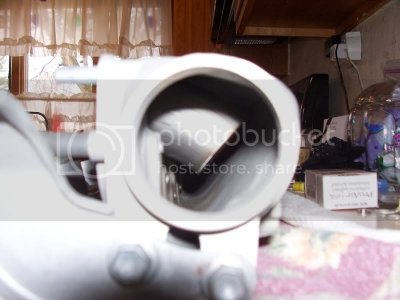

I would love to see some numbers of a BBB set up with a set of BB matching horns, I tried this a while back by installing a set of mandrel bent horns in the stock plenum but there was no way to install them with a proper bell mouth.... with out cutting out the side , installing horns and welding it gack up.
100 0909
I had to settled with a simple set of extensions that just got the port out into cleaner air, they are bell mouthed but its hard to see in this pic...
000 0016
Some one needs to build a custom set of tanks with BBB and proper horns and see what the number are.

Nova, there was a fellow on here that was reverse radiusing the ports in the plenums, to create a better transition into the primary and secondary runners/BBBs.
Nice work on the bellmouths. Maybe some kind of removable plate could be machined into the plenum at the butterfly interface, or maybe study the techniques used to build model boats inside bottles . . . . .
