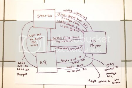

Splice wires together my attached diagram has colors attached and from where to where the wire needs to go.
splice the green with orange trace together amongst all three, as well as splicing all three uncoated wires together. make sure to use some good crimp connectors for all the wires. I then electrical taped all the stuff together to look nice and clean.

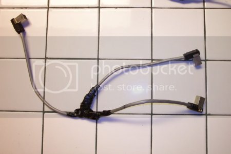

splice together the ground harnesses, so you have three connectors.

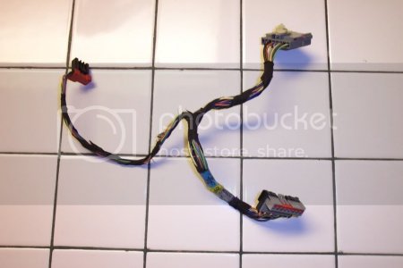

daisy chain the power harness's into each other at the back of the stereo.

2 of these

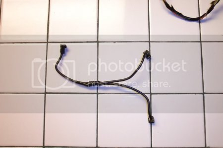

here is the spliced ground harness
here is the spliced slave harness
and here is my wire diagram
better diagram coming soon, this was a quicky.
