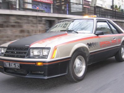

Looking to do something different to the headlights since NO companpies seem interested in making them for us...I seperated the lens from the headlight assembly and was shocked to see that the inside has alot of molded edges and actually looked Semi-apeasing..
So after reading everylast post and thread on here aswell as yahoo....I was wondering why no one ever thought to just abandon the clear lens idea(since this seems to be the snag in everyones plans) and retro-fit some enclosed bulbs or HIDs projectors in there, then repaint the housings the body color of the car....
like these...
223548538 8099cb3d57
just putting it out there?
sorry but that just screams 80's!
God this takes me back. Had one of these in a turbo, removed motor, trans and rear end. Installed a 68 2barrel 289 with 0 miles on it(donated to school when new, set on engine stand since) topoader wide ratio 4 speed, mr gasket shifter with custom shifter arm to fit stock hole, hydralic clutch, 8.8 posi with traction shocks from gt with lx stock exhaust, no converters of course. What a fun car. Later bought another one that had a stock v8 with automatic, that thing wouldn't get out of its own way.
