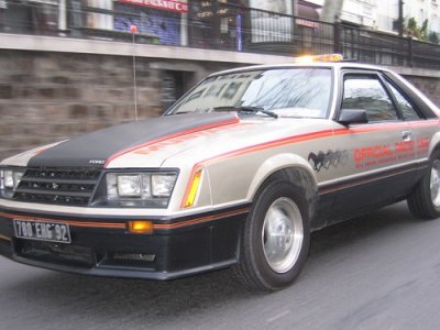

Just don't do them like that Fox, or the focus headlights.

Those Focus lights are ugly, and that '79 Pace car is cool, my brother used to have one even, but it's lights were cool for '79, not for '92-95, and certainly not for 2008/2009.
But I look forward to seeing whatever you come up with.
Thanks. thats kinda how i feel bout it too...but SOMETHING has to be done here..I HATE THESE LIGHTS..
as far as the 79 stang goes, even my 98TA has those square [floodlight] lamps so if i can make the housings look better, it could work...ill keep everyone posted as time goes by..THANKS:thankyou:
