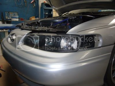

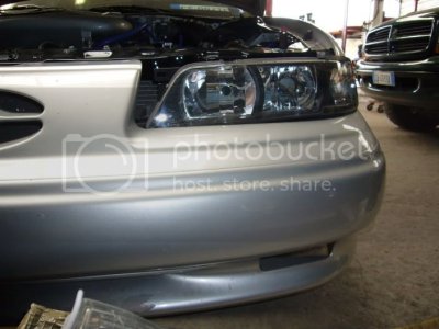

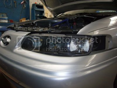

Lol! I already test fit these on my 93' since My buddy had them on his 96' Maxima. They would look wicked and will need some fender welding to take up the extra space. I think a set of regular Taurus fenders would work pretty good to take up the fender gap. The front will need a custom grill too. But the are the right shape and curves. I'll have to dig the pix up when I get home.

P1180930
P1180931
P1180932
There ya go... Still pondering this swap.
Also note that they will slide closer to the SHO's grill if the black hard seal was cut or removed. I fit these without the header panel installed since it was in the body shop anyways. A set of eyelids mad of fiberglass would fill in the angles gap between the grill, hood and headlights.
