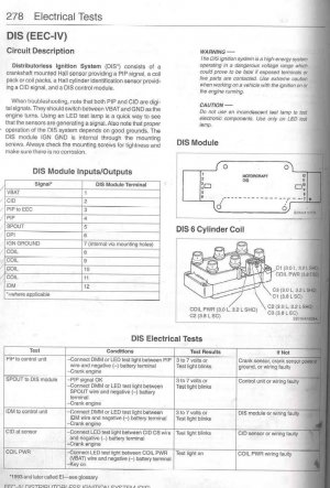

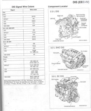

I would suggest checking for spark. Get one of these if you don't have one:
If you don't have spark, check out the DIS:
