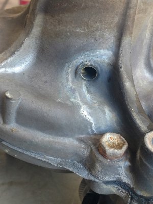

To a certain extent, you are right. Just had a case where the water pump was leaking but didn't short out the CPS. It was leaking from where the downpipe for the radiator hose attaches to the WP. The thermostat was all messed up. I remember another case where the WP to block O ring had failed. Can't remember if it shorted out or not. However, if the pump has failed because of a leak out of the bottom weep hole between the shaft flanges, I can pretty much guarantee it will short it out.

My personal opinion, based on the dozen or so of these that I have owned, is that the water pump leaking does not have a significant impact on the crank sensor life.
