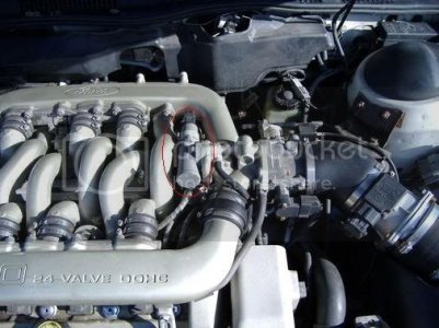

no the cylinder looking tube across from tb thx
I believe you're referring to the Idle /Air Control Module (pictured below). I don't believe this is contributing to your power loss. Did you replace the gaskets when you reinstalled your intake? This may be the culprit, but I would suggest getting new plug wires as well.

IAC thank you finally someone got it ok ill get new wires if it still does that after new wires what else could it be im hopeing the wires are it because 3 fell apart when removing thanks everyone

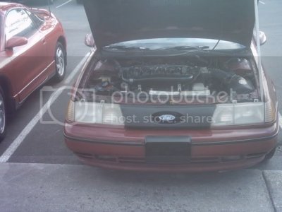

yes new gaskets on entire intake and i had to remake clamps for the snakes i loosened one today and i heard air leak so i know they were tight here motor pic
