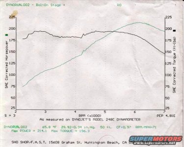

I have an old SHO Shop guide log that details the power gains on popular accessories. I thought I would post them again. The dyno used is a DynoJet model 248C. Its my understanding that this is the best dyno to use because you can achieve repeatable results. The car used is a '89 SHO with 111K miles. A 60K was done on the engine with a leak down test to make sure the engine was in good condition. They ran the engine stock for a baseline then ran the car again after each power mod. Here are the numbers...
Stock HP 183@5900
Stock TQ 189@2800
Added 80mm MAF w/LPM and cone filter
HP 189@5900
TQ 191@4800
Added UD pulleys
HP 196@5900
TQ 198@4800
Added (original style non-equal length) Y-pipe
HP 207@6100
TQ 194@4800
Added Cat-back
HP 211@6100
TQ 197@4900
Added Extrude Honed intake and BBB
HP 213@6100
TQ 202@4900
My dyno sheet with the above mods minus the cat back
Dynosheet0002
Bob
