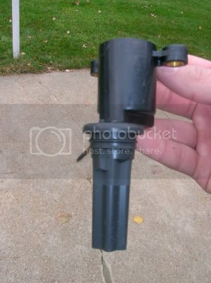

They are a coil on plug (COP) design. They look like this new from Ford/Motorcraft:
NewMcraftCoil
And I've never heard of a coil boot???

Usually the V8 coil hard plastic shell will crack. My theory is because the mounting tabs are at the top of the coil, stress is applied to the plastic shell. From what i have see all the other Ford COPs have the mounting tabs at the bottom of the coil body shell giving better support.
