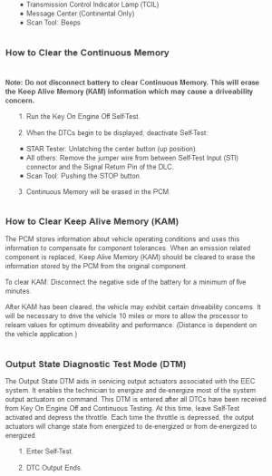

And from that same manual, which also has extensive information about not just diagnosing DTCs, but how to get them - to put a nail in FastCADs code-reading advice:
SJJo3mC
"Do not disconnect battery to clear codes" indicates it works, but it should not be your method to do only that.
