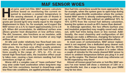

Or the engine is actually running lean? Or has learned a rich strategy but goes lean sometimes in the power curve? Have you only used an OEM paper air filter, and replaced it at the scheduled 30k miles or 30 months?
How did you clean the MAF sensor? Remove with security Torx from the housing, and spray the fine filaments with CRC electrical contact cleaner in a can (Harbor Freight has it cheaper). Inspect the filaments, that they aren't broken. Reinstall just as carefully.
Lean3 0118
Also, throttle position sensor you've swapped for free. Besides seeing that TPS is measuring around .95 volts at idle position (adjusted by twisting the sensor on the loosened screws), with a multimeter probing the TPS output wire while the car is in "run" key position but not running, you can also examine that the voltage slowly and steadily increases as you very slowly move the throttle by hand, with no gaps or blips in the value.
After any of these management sensors are changed, again, you need to clear the PCM memory with 10 minute battery disconnection, do idle relearn, and let the engine re-learn trim corrections by doing a complete drive cycle.
Here's a link to a free multimeter coupon at Harbor Freight, also (timing-light-era mechanics often had an analog "engine analyzer" with a big needle voltmeter; I just donated mine to Goodwill).
