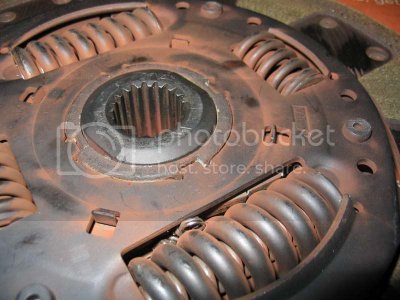

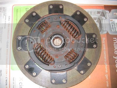

manufacturing defect to say the least... hopefully josh can pull some strings over at CM and they can stretch their 90 day warranty. it has less than 5000 km on it 1500 of which are a road trip. it was properly broken in, never slipped or burnt. i was too scared i was gonna break my tranny so its never bean launched above 1500 rpm... its been babied! sigh i guess its what you get for modifieng a car

Look carefully, and see if you can detect what went wrong!

Indeed, that's the plastic-bushed spline carrier from a stock SHO Valeo disc. I can see where it spit out pieces from the spline hub carrier, they're lodged in the large damper spring.
This is what CM is passing off as a "Stage 3" clutch? And an 8-rivet lining to boot. That's some weak sauce.
Gary M.
A "performance" clutch using an OEM inner/outer hub and springs?
Gary M.
At the time, I didn't know any better, or else I would have called them on it, even though the it was way out of warranty. That is the original CM Stage III disk I got from the SHO Shop, many moons ago.
But, yep, I blew out the spline carrier, and it just rotated freely. Who would have thought a stock carrier couldn't handle 400+ hp. It's just a really bad design I guess...

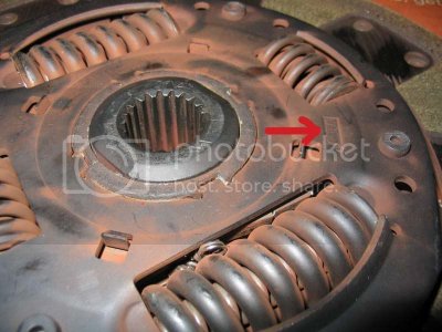

A least your failed disk had the 32 rivet lining, instead of my 16. Also, I'm not sure what spine carrier you have, but it doesn't look like the stock Valeo.
But in the end, it doesn't matter cause they both failed...

i was looking for the valeo stamp and couldent find it... josh hasent gotten back to me yet but he is probably just busy.
