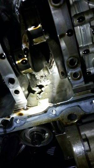

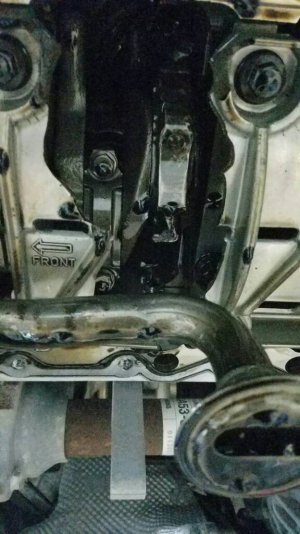

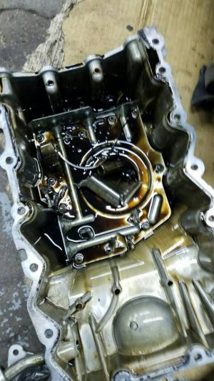

I have a 2010 Taurus SHO PP with just over 51K miles on it and I somehow blew a hole in my engine block due to a broken piston. Oil has been changed every 3k miles with Full Synthetic. Has anyone else ever had this problem? My mechanic has never seen anything like this and believes it was definitely a defect. Although I am out of warranty, I am wondering if pursuing Ford is out of the question (lawsuit ect.)? Any help is appreciated. Thanks!

With the information presented here, you would hope that Ford would take an interest in your unusual issue. If you were fortunate enough to have retained the original dealership through the warranty period, the case becomes even more compelling.
I would satisfy myself by ensuring that Ford has become aware of the situation while working with the original sale dealership and the area representative of Ford motor company....the emphasis on motor.
At the same time we must remember the shameful position that Ford took on the cam welding issue in their flagship model SHO of the day back in 96 to 99.
Their handling of the intermittent windshield wiper issue in the late 60s, early 70s does not make for inspired reading either.
Give them a chance and see how it goes, At the same time, begin your plan B scenario where you locate a replacement unit.

OP stated in another forum, that he has an intake (did not specify who's) and also stated he was tuned and used an SCT device.
The only tuner I am aware of, that still uses SCT, is Torrie over at Unleashed Tuning.
I'll defer to the OP to verify.
But, regardless, I'd highly doubt Ford would touch the claim, or even potential litigation with a 10' pole.
Quite honestly, nor should they.

I asked because in that case it's plausibly connected to the tune rather than a mechanical defect. I think you have no recourse with Ford other than making a polite request for assistance; perhaps they will offer something since your mileage is relatively low for a 2010.
