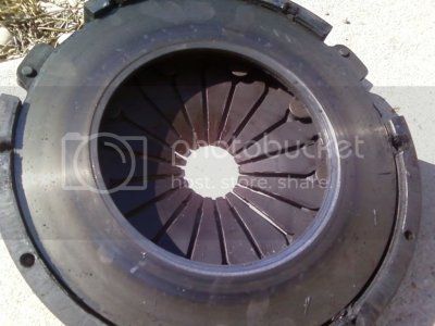

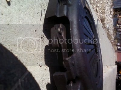

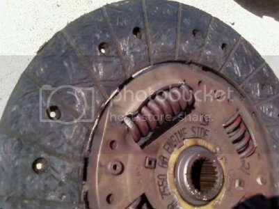

I ran a 75shot on the stock clutch with mods as well for some time. Actually, I may have hit it with the 100shot as well, I don't really remember. I didn't break a strap, but the stock disc did NOT last.
I was fairly easy on it while on the bottle, but it did have plenty of hard shifts.
1230145208
1230145376
1230145377
1230145378
I just broke down and put a CM3... :nut:
EDIT: Actually it DID bend a strap.. just saw the other pic... :doh:

The straps can be fatigued by aggressize downshifting (or missed shifts) which bends them with stress concentrating at the rivets. I know of at least one purveyor of SHO clutches that will not sell stock replacements because warranty returns for broken straps were killing all margins.

zak, it was definitley a Ford replacement. It was not the "reman" one, but the OE type Ford clutch. The only reason I took it out was that it killed the PP fingers from TOB wear :(
