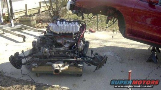

Just pulled the control arms with knuckle and axles out. Very easy this way. But the front control arm bushings were shot. Can't tell about the rears until they come out. Then there may not be enough of them to make an easy determination of their worthiness. Might have to send them off to CSI.

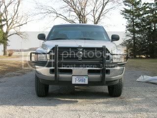

Those will arrive middle of next week. So until then, I couldn't tell you if all the noises went away. But I will post after I get the car back. Right now I'm sporting this
Ram1
