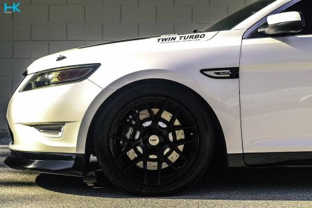

You indicate in your post re: Brakes that you did the Wilwood Big Brake Upgrade on all 4 corners. I checked their website and don't find anything for the Taurus SHO. Then called them and got the same answer from one of their salesmen. Please advise

TCE Performance pieces together kits. Another member mentioned they may not be available anymore.

@ Vigilante:
When you call TCE, ask for the owner, Mr. Todd Cook & speak directly with him.
He was low on inventory, but at last check, he still was putting kits together.
Let me know.

I put PowerStop drilled/slotted rotors on all 4, and their Z23 pads. Made a noticeable improvement and look great. I never track mine, but I definitely DRIVE it! Never made any measured stops with stock vs PowerStops so have no empirical data to pass along, but I estimate 15% improvement in stop distance, more notable stopping from faster speeds. I've had these on for about 8k and no obvious plugging of holes, nor any signs of crack propagation from holes. I do keep a close eye on them, though. I'll keep reporting as I put miles on. While certainly nowhere NEAR the Wildwoods, I am happy with the PowerStops as a cost effective upgrade; In terms of performance AND visual appeal
