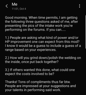

Just sent the machine shop owner the following text..... (see the screenshot image):D55e491f24fb3832aaf7539b6cd8dc42

Answer to question #1:
"The hp gains are all related too the application and the supporting modification done to the motor but on a application as your build gains are going to be ruffly 15-25hp."
Answer to question #2:
"As for the weld getting through to the inside. It doesn't when u weld aluminum you dont want full *********** to the point of "sugaring" on the inside. What that does is it weakens the base material around the weld and will likely fail. The strenght of the weld is done with the filler material added to the surface of the weld. So as for the inside it will just be a slim line that wont effect flow at all."
Question #3 has yet to be answered.
Figured I'd copy/paste (and post) the replies he has provided thus far.
Hope that's of some help.

He may not have to worry about it depending on how its welded, its possible to penetrate enough to seal the gap without having a mound of slag on the inside.
True, that is why I am curious to know how they plan to do it... and it has been answered before I finished typing.

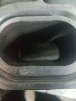

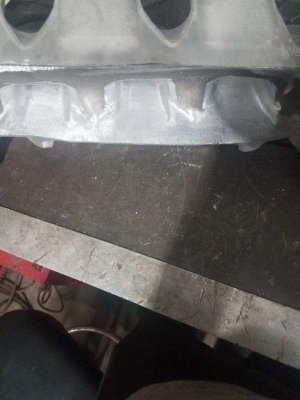

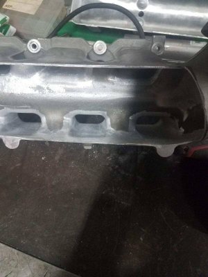

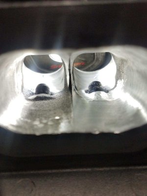

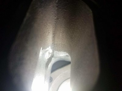

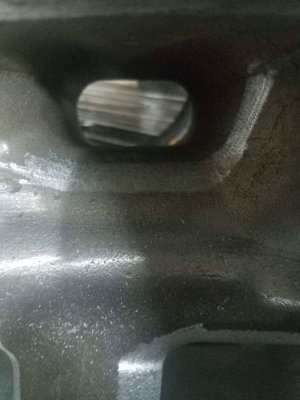

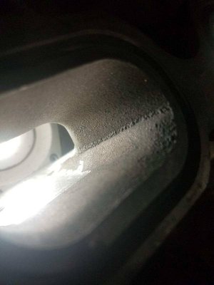

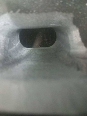

10/09/19.......
Got more intake **** pics that were sent to me earlier today. Still a work in progress mind you, as the machine shop owner said that these are just roughed in with a carbide bit. More finishing work yet to be completed. But thought I'd share with y'all.
Machine shop owner also seems to be getting more and more excited as he continues immersing himself into this project.
He stated the following: "Just wait till you see the heads. I dont want to release and pics til I do some more testing on the flow bench but they are becoming quite the monster. Just been modifying and testing, modifying and testing, and we are still seeing improvements across the board! You will receive data sheets as well, of the flow data."
He did educate me about etiquette as it relates to the posting of the pictures of the heads (when ever they are sent to me) explaining that porters in the industry don't typically like sharing such imagery, as that is "like gold" to them. But he followed up with saying that he wouldn't necessarily mind as he doesn't have much in stake in this platform. Most of his work is in/on the import scene. So I'll discuss with him further.
I did relate to him that it's nice to begin getting excited about the car once again, as it has been a pretty depressing season for me since the failure and having outlayed lots of money to date, with results merely trickling in. But in the same token, I also understand that's the sacrifice needed for such intricate work.
To which he replied the following: "Well I know I would be if this was my project, because your doing this to this platform that hands down, no one has ever done. I am talking motor wise. I have done my homework and the intensity and details in work, port work, and treatment technology. No one on your platform has done."
We concluded with me saying that I hope any future consideration to be part of the "Featured Vehicle" display at the Ford National's would (hopefully) be accepted, as in theory, the investment of time, talent, and treasure will be leaps and bounds of where it was at, prior to this same event for 2019 (& I was accepted, but unable to attend due to the failure).
Which he commented: "Yea I think with the reborn of this car, and all the modifications done, that it should be accepted no problem. And at that point its like a piece of art!".

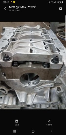

Mike
6689c724b679ad7a98deb194e76ca8beAd7949dbe597399d52ce07ef4a16d61e858723f73a8afb62beccfe80302aaa94
CCXVI
Nov 26, 2016
269
271
Lots of shops can do custom cam grinds, so you definitely should be able to make that happen.

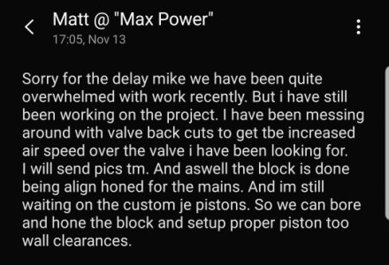

11/15/19.......
Been a lil quiet as of late.
So I texted the machine shop owner twice for updates, and his reply is posted as a screenshot.
That reply was on Wednesday evening, and I was waiting for pics to arrive today as is stated in his message, but alas nothing came across my phone.
So figured I'd at least post up the info that he did provide me.
