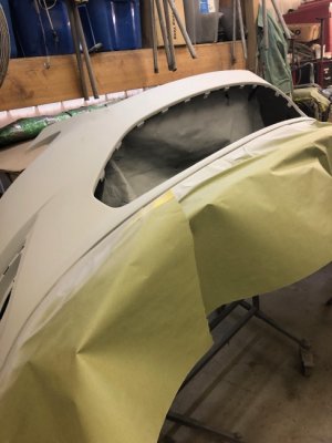

I did hear from the body shop however and apparently the (several years) old 3M paint protection film was a real bitch to remove. Took nearly a full day to do so. They also stated it peeled all the paint off. Yikes! Which was/is fine, cuz it's getting entirely re-worked/re-painted anyhow for anticipated mounting of the custom splitter. But yea, I'm not even sure if any of that product was designed to be removed anyhow.
She's being prepped for priming now.

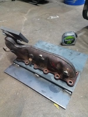

CUSTOM EXHAUST MANIFOLDS!
Jigs are being set up now, and exhaust manifolds are being prepped to be all cut up and rebuilt from scratch. All by hand!
Machine shop owner stated that he can, and I quote "most definitely can make more in the future". So good news on that front for those of you interested in investing in a future mod. No price point obviously, as it is way to early in the game for that, and no, I am not disclosing what the estimate is for me alone. Sorry. But not really. LOL.
For reference, 1/2" thick steel as support and a 3/4" inch thick base plate. Nice!!!! F1c1e3b0acf9e8642b63c4bdd03bb9d6Ddf88213e9c1d04bc99055a24ad99455

So it's my understanding that these manifolds are really a manifold in a manifold...for heat protection purposes. Will they be doing something like that, or something more along the lines of shorty headers...
