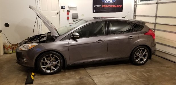

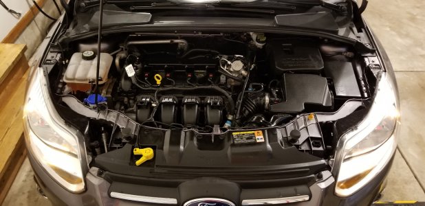

Meanwhile, I'm out in the garage working on the middle child's new to her '14 Focus SE w/ "appearance package" that we picked up for her last Saturday. 43k on the clock. New rotors and pads installed. New tires. Fluids swapped and washed it. Thoroughly. Including detailing engine bay and interior. Had windows tinted @ 20% for her. Getting ready to wax and detail exterior now. Fun little car.
This, in comparison to mine, that's hibernating on the other side of the garage, collecting dust and dismantled as expected.

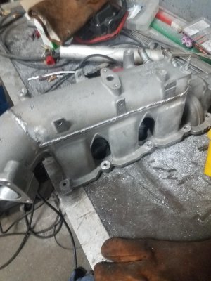

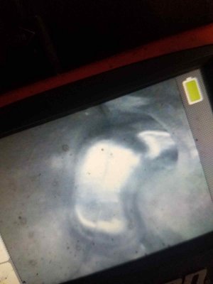

12/11/19.......

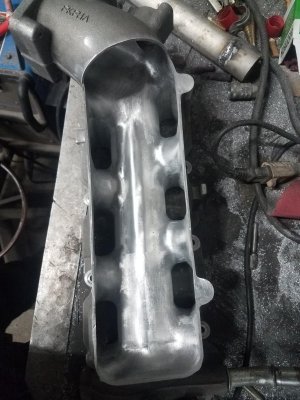

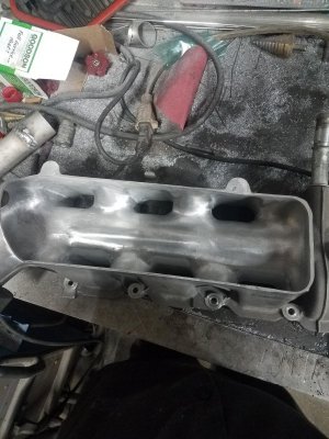

Intake manifold has been completed. In its' entirety and has been sent to powder coater.
Have been told that in order to aid in atomization of the Methanol, an 80 grit medium finish was chosen for final finishing.
Also, the one image with the bore scope is verification that the welding did *NOT* burn through.
Can't wait to see it returned from the powder coater. Impressive work to say the least.

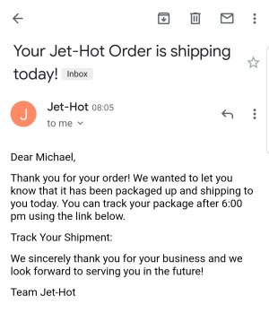

**BONUS!!**
Just checked email and it appears the DP's that PPE fabricated for me, and then sent off to JET-HOT for their 2500 degree thermal ceramic coating are also done in their entirety, and have shipped out one day earlier than scheduled! Sweet!
(image edited to block out tracking #).
I'll snap some pics once they arrive.

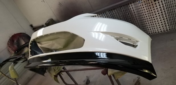

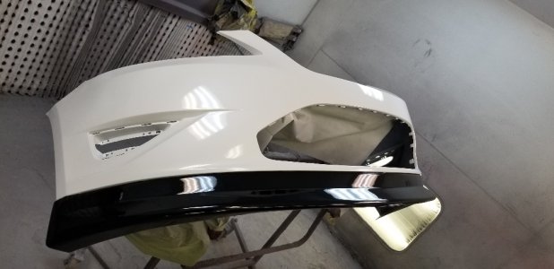

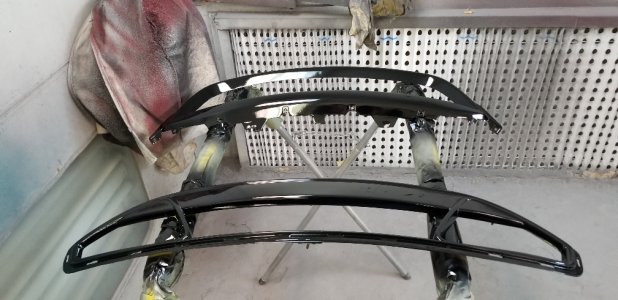

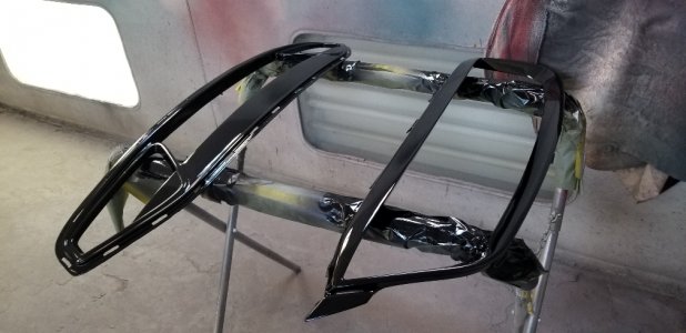

12/12/19.......
A few more pics of front bumper cover and the upper/lower grilles having been repaired/repainted.
Was told the custom splitter is being prepped for paint today, and should be being mounted to the existing lower chin spoiler/ bumper cover soon. Exciting!!
Really happy with how it's turned out thus far. Removing the old paint protection film was quite the undertaking.
After the proper curing time, I plan on using a newer and better product from "Xpel" for paint protection film.4eb86f2757d2291247302407f25a67961328ef16bc6c400f48342b8bf86114bfEa1e6da9a1d776b8c2de5c105a99e8b7D7a59454bf87c8575fd05562edd200bd

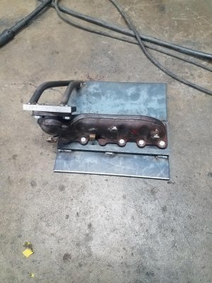

12/06/19.......
1st exhaust manifold jig complete.
All set to now to gut it open, reduce it to the flanges only, then build it back up from scratch incorporating a tubular design.
So...they might not wanna share, but I'm VERY curious as to the dimensions they'll be using for the build. The pipe diameter and and length, to be specific. I'm assuming they'll just be primary's in to the ****** for the turbo.
I'm asking because there ain't much room to play. If they're gonna build it bolt up to the stock pipe configuration, it's gon' be tight.
Honestly, I have full confidence in them being able to pull it off. Looks like you found a helluva shop to do your work. I assume they realize they're setting the bar...
