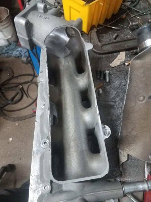

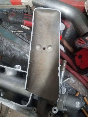

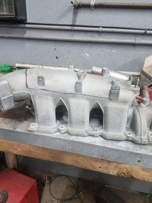

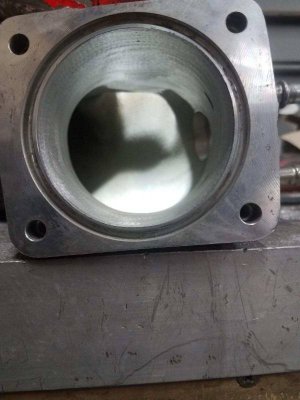

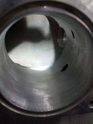

Stopped by the machine shop today. Essentially just to drop off the bigger TB from BBK and to say hi and shoot the $h!t for a few minutes.
The owner has begun the port matching and polishing of the intake.
Said he noticed an inordinate amount of casting marks, blemishes and imperfections from the factory. He suggested porting and polishing the ENTIRE inside of the intake, which would require cutting it open, in order to gain unfettered access as needed.
He'll weld it back together afterwards, then send it off for powder coating.

Not too keen on engine parts being cut and welded back together, but fingers crossed this will work well. Another possible route 2 go is to create a composite intake like Ford has for the F150, unless there is a compelling reason to retain the original metal intake. Gonna polish it up?
7,405
9,701
A composite of the factory manifold would be awesome.
bpd1151
Lurking Around
Feb 21, 2010
3,131
6,668
SHOcago 'Burbs
Gonna polish it up?
Powder coating it, as stated in previous post.
Also, no need to cross fingers, this sort of thing is performed routinely in the import/foreign platform(s).
I wouldn't be proceeding forward with the work as outlined if I wasn't confident about it's intended outcome. Looks much scarier than it really is, and I've seen some scary things in my lifetime.

Awesome. It's cool you were able to find someone so close to you that is capable and trustworthy of these types of mods.
So what kind of gains should one expect with something like this? ...port matching and smoothing.
Since I don't have someone who can do this (that I'd trust)…I'm thinking about extrude honing. Seems very similar, if not the same.

@ Stan.....
I'll have to ask the machine shop owner what his best guess is based on his year's of prior experience performing this same mod.
Considering I'm doing a lot of different things all at once it will be challenging to isolate a specific number.

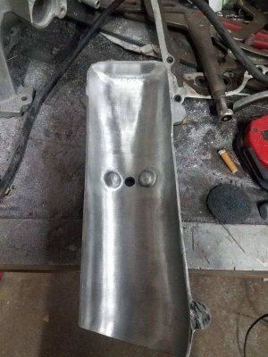

10/03/19......
Upper portion completed......
Oooh. Aaah. So shiny. So smooth.
