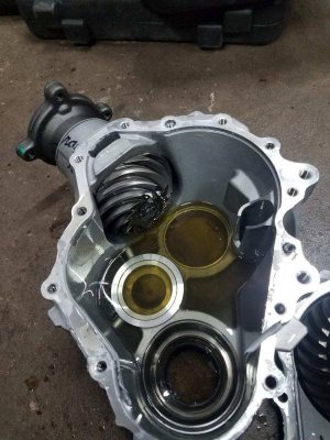

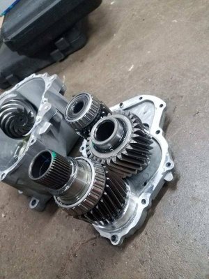

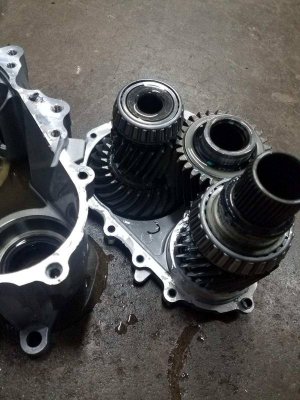

Brand spanking new PTU (w/drain) now at the machine shop, and currently being disassembled and prep'd for the WPC Treatment process.
Just thought to share what the internals look like, especially when new, and not filled with ***** used up ****/gear oil.235b393c1e8fa15aadc31318f5267c8a91260158e50f19810d317cc0f7e60f2aB26e229c7b4bdc66a536f56656ec3038

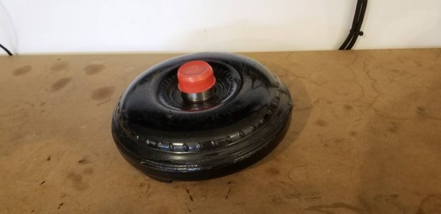

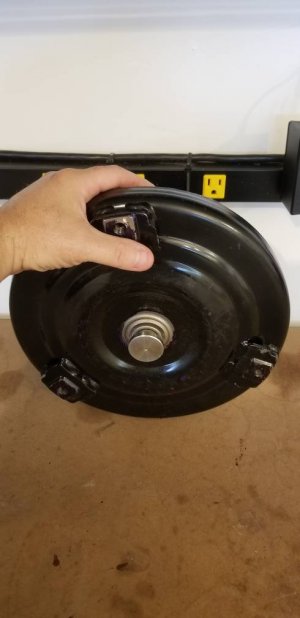

Received the new, upgraded TC from GH. It's a 3 bolt design, which is most common.
I sent in a core that had a 4 bolt design, which was/is used on the 2010 "Job 1" builds as well as the majority of the 2010 "Job 2" builds.
No biggie really. It simply requires a change in the flywheel.
There's no (performance) difference between a 4 bolt, versus 3, and vice versa.
Anyhow, looking forward to the inclusion of another piece of the puzzle and kudos to Matt over at GH for bringing this aspect of improvement to the platform.
Oh yea, and the black paint is a nice finishing touch. Not that I, or anyone else will see it once installed mind you. But for those like me in the rust belt and winter season, it's a nice added touch to what I expect will be a great product.
