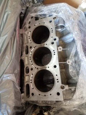

. . . . Just got these sent to me from the machine shop. Literally. Engine has returned to their facility. Full closed deck completed. Yea baby.
I asked what was next in the process, and he replied with the following (in quotes).....
"I'm waiting for the pistons, so then I can hone the block and set my piston too wall clearance. Then resurface the engine block and align hone the mains with the arp studs".
Enjoy the car **** fella's. Exciting times on the horizon. F3cea2bcd508f7770c7945da11d0824a66cb2d76a7974f9922c84a1a40c1df34
