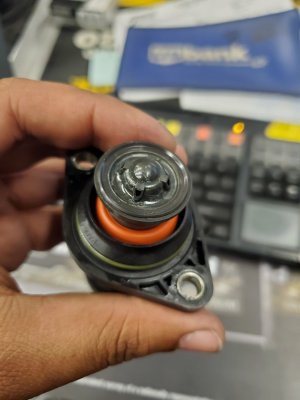

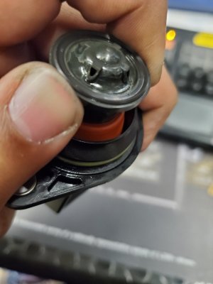

I am confident it is the diaphragm on one, or both of the electric bov's.
Remove them (the entire bov) from the piping, then extract or pull on the center plunger gently and inspect the rubber portion (should be orange in color, but could be another).
If you notice even the slightest of a tear, that'll be your culprit.

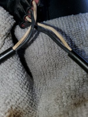

The only other issue I could think of (which that model year was prone to) the dreaded chafing of the knock sensor wires / wire loom.
Report back your findings and good luck.

As a long time lurker, im happy to have your help =) I've inspected them before and thought it looked fine but perhaps im mistaken? Ive already replace the knock sensor, it was in fact chaffed.

I just took off and inspected the other one too, they both look fine and identical.
