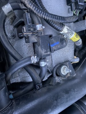

Pull the engine cover off, a little further back from the front driver side spark plug is a little black hose that is known to blow off the charge pipe. If that happened to yours, put a clamp on it after you reattach it.

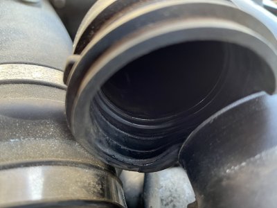

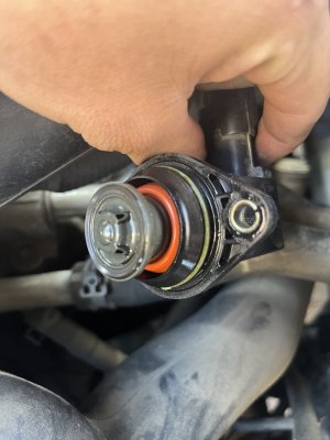

there seems to be oil in the bov and intake, i’ve never owned a turbo car so idk what it could be

normal to have some oil in them. Have you check the wastegate rod at the turbo? there is a small E clip holding it on and have been known to come off. Also did you locate the hose with the zip tie in the pitcher above?

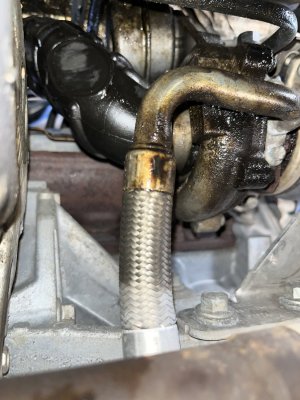

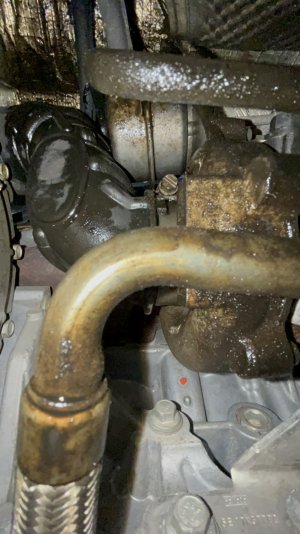

Yea the hoses were just a lil loose and i zip tied those but while looking for the E clip i saw this on my the turbo near the passenger wheel
